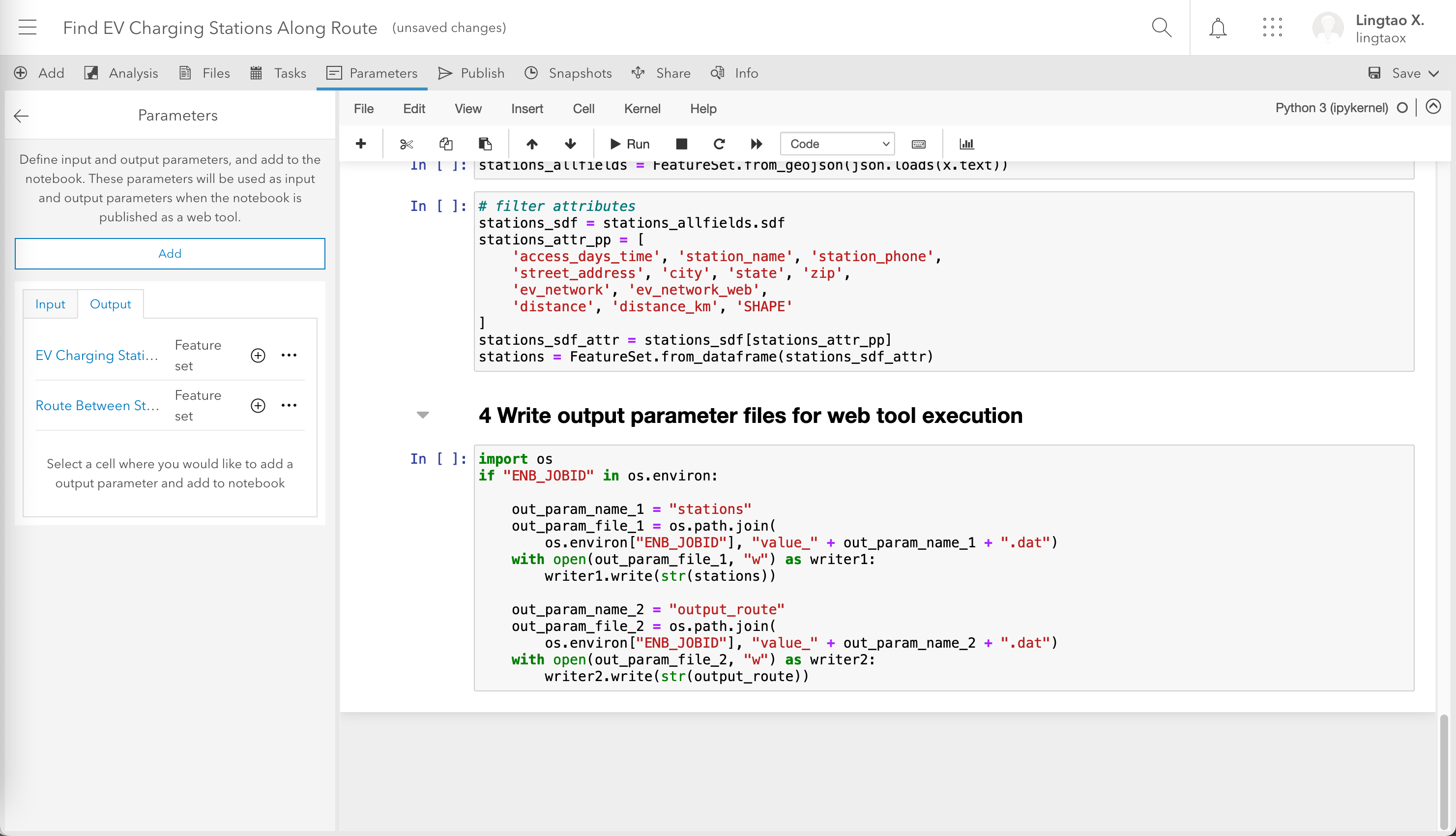

1. Using Python code, update the notebook to do the following:

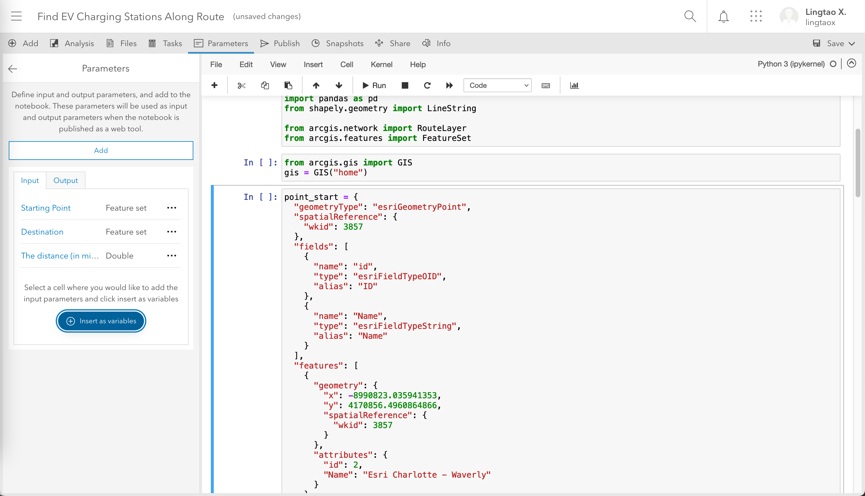

2. Configure notebook parameters by specifying:
  • Input as origin and destination points, specifying them as FeatureSets and distance that is specified as a Double
  • Output as the route and charging stations and specifies them as FeatureSets
Web tool input parameters
Web tool output parameters

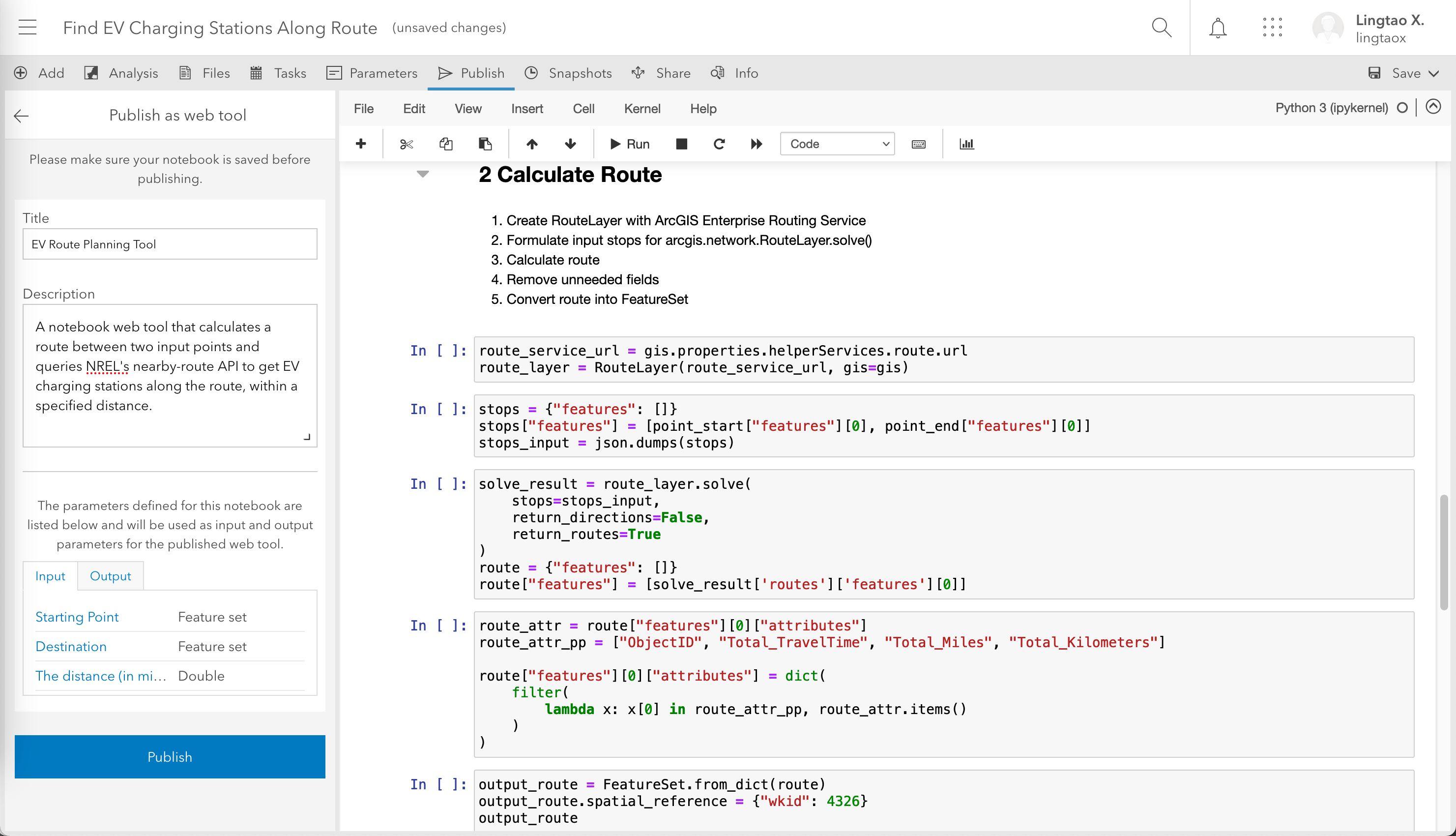

3. Save the notebook and publish it as a web tool.
Additionally, share it with the organization where other members can use it to calculate various routes and to identify additional charging stations.
Publish a web tool to locate charging stations
