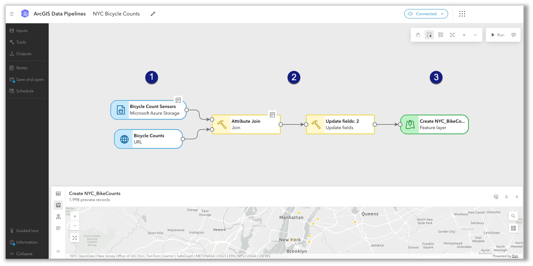

A data pipeline workflow consists of one or more inputs (1), tools (2), and outputs (3). In this example, JSON data from a URL is combined with a CSV stored in a Microsoft Azure Storage container, and the prepared result is saved as a feature layer.

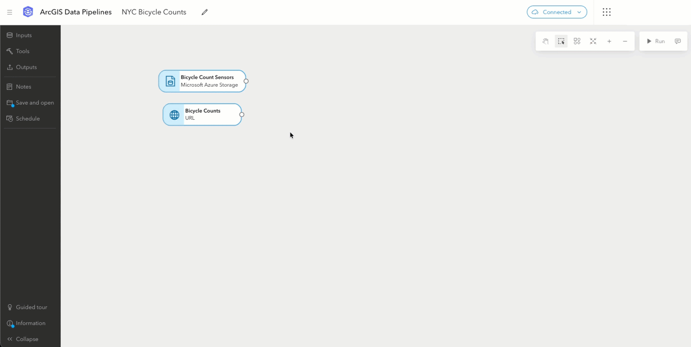

Connect to data
Inputs are used to load data into your data pipeline for downstream processing, and there are many input source types available. ArcGIS Data Pipelines can connect to external data sources as well as data stored in your ArcGIS content.
While the list of supported sources will expand over time, the following input types are supported in ArcGIS Data Pipelines for ArcGIS Enterprise 12.1:
  • Files uploaded to your content, accessed from a file share, or returned from a URL or API request

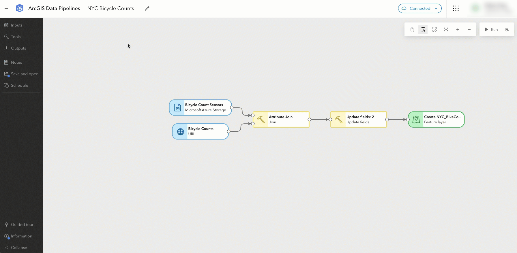

In the example below, two datasets are joined using a matching field. You can also join datasets based on spatial or temporal relationships.
In the example above, two disparate datasets are joined together based on a matching field.

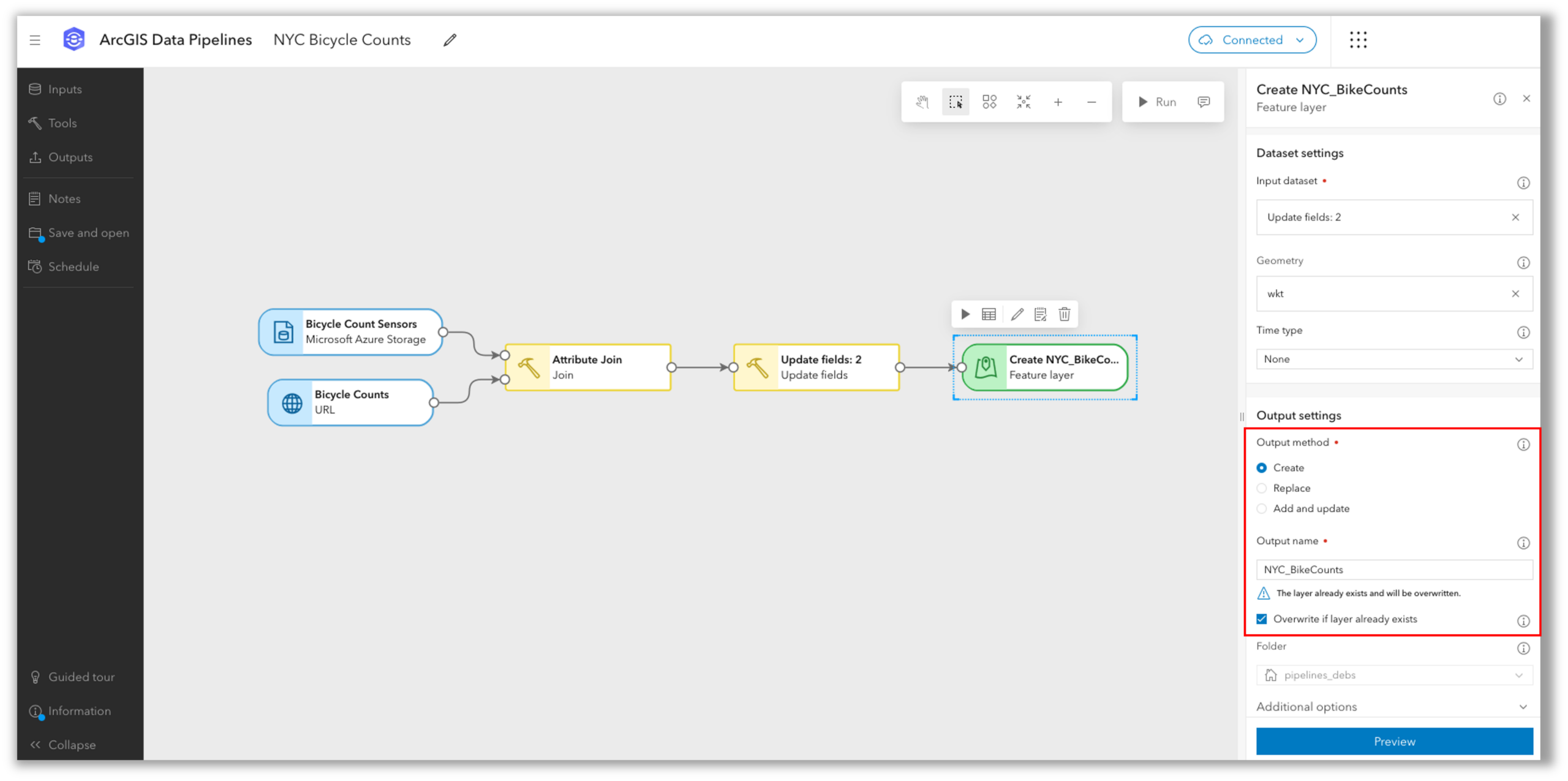

After you connect to your data and apply processing tools, you can configure one or more feature layer outputs. When you run a data pipeline, it processes the data and creates or updates layers in your content.
As shown below, the Feature layer output allows you to define how results are written. You can create a new feature layer, replace data in an existing layer, or add and update existing records.
ArcGIS Data Pipelines can be configured to create a feature layer or table, replace the data in an existing feature layer or table, or add and update records in an existing feature layer or table.
All output feature layers from ArcGIS Data Pipelines leverage the hosting server’s relational store. To learn more about writing results, see the Feature layer output documentation.

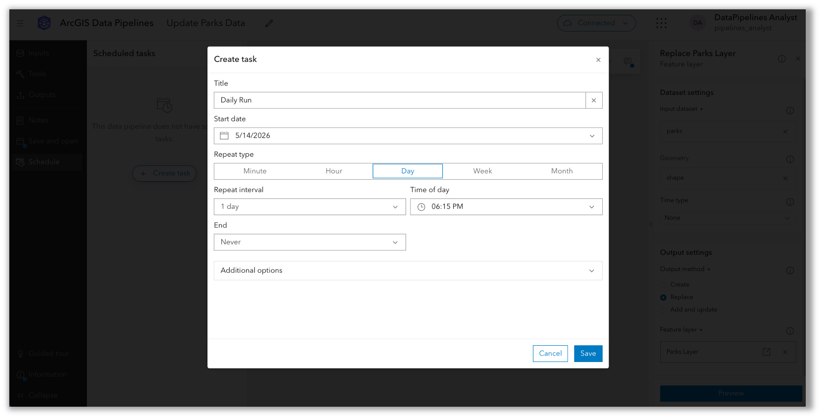

ArcGIS Data Pipelines allows you to create and manage scheduled tasks, automating data pipelines to run on an interval of your choosing. For example, if you create a data pipeline that ingests data from an API that updates every day at 6 p.m., you could schedule the data pipeline to run daily at 6:15 p.m.
Create a task to schedule data pipelines to run on the interval of your choosing. This task is set to run each day, just after the source data is updated.
Tasks can be created or updated from within the editor when a data pipeline is open. Or they can be managed centrally from the Manage scheduling page. For each run, you can review results, check run duration, and inspect any messages generated during execution.
When scheduling a data pipeline to run automatically, it is generally recommended to configure all Feature layer outputs to use the Replace or Add and update output method. This is because the Create with overwrite option allows for schema changes, which could result in broken downstream workflows such as pop-ups or filters.

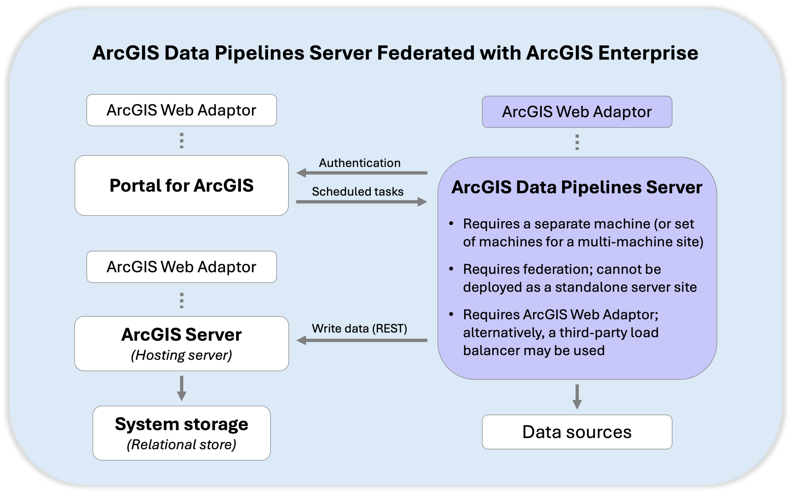

ArcGIS Data Pipelines is included with ArcGIS Enterprise Advanced, beginning with ArcGIS Enterprise 12.1 on Windows and Linux. In the future, it will also be available with ArcGIS Enterprise on Kubernetes.
To configure ArcGIS Data Pipelines, an administrator must set up a Data Pipelines Server site, configure the ArcGIS Web Adaptor, and federate it with ArcGIS Enterprise. This site can run on a single machine or multiple machines for high availability.
Once configured, Creator or higher user types with the appropriate privileges can access the Data Pipelines app and begin creating and automating workflows. By default, these privileges are included in the Publisher role, and custom roles can also be used to control access.
A conceptual diagram that shows ArcGIS Data Pipelines Server federated with ArcGIS Enterprise 12.1 on Windows and Linux.
As noted above, ArcGIS Data Pipelines Server must be installed on a separate machine, without other ArcGIS software, for production environments, and it requires federation with ArcGIS Enterprise.
Administrators can deploy ArcGIS Data Pipelines Server on a single machine or deploy it across multiple machines. Scaling horizontally across multiple server machines allows you to support more concurrent data pipeline authors working in the editor, more simultaneous scheduled task runs, and it enables high availability, preventing downtime in the event of a machine failure. There are no licensing restrictions on the number of machines or cores, so you can scale the site to meet your workload requirements.
As an administrator, you can configure system properties to adjust security settings and manage resources. For example, you can define an allowed hosts list that can be used with the URL input to read in data, which is empty by default, or you can limit the file share inputs that can be used in data pipeline workflows within your organization to only a list of approved directories. By default, all file shares that are accessible by the ArcGIS Data Pipelines Server account will be available for use in the File share input.
