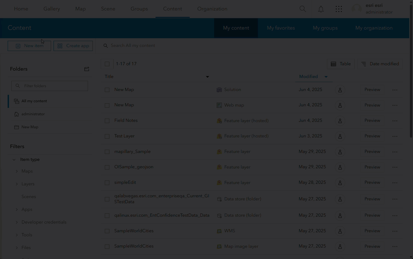

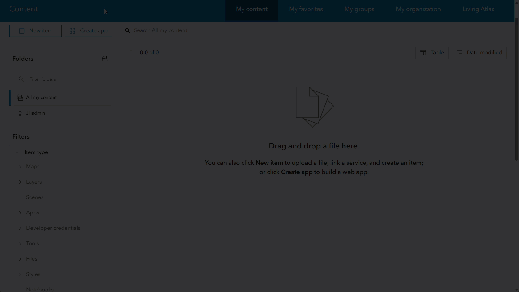

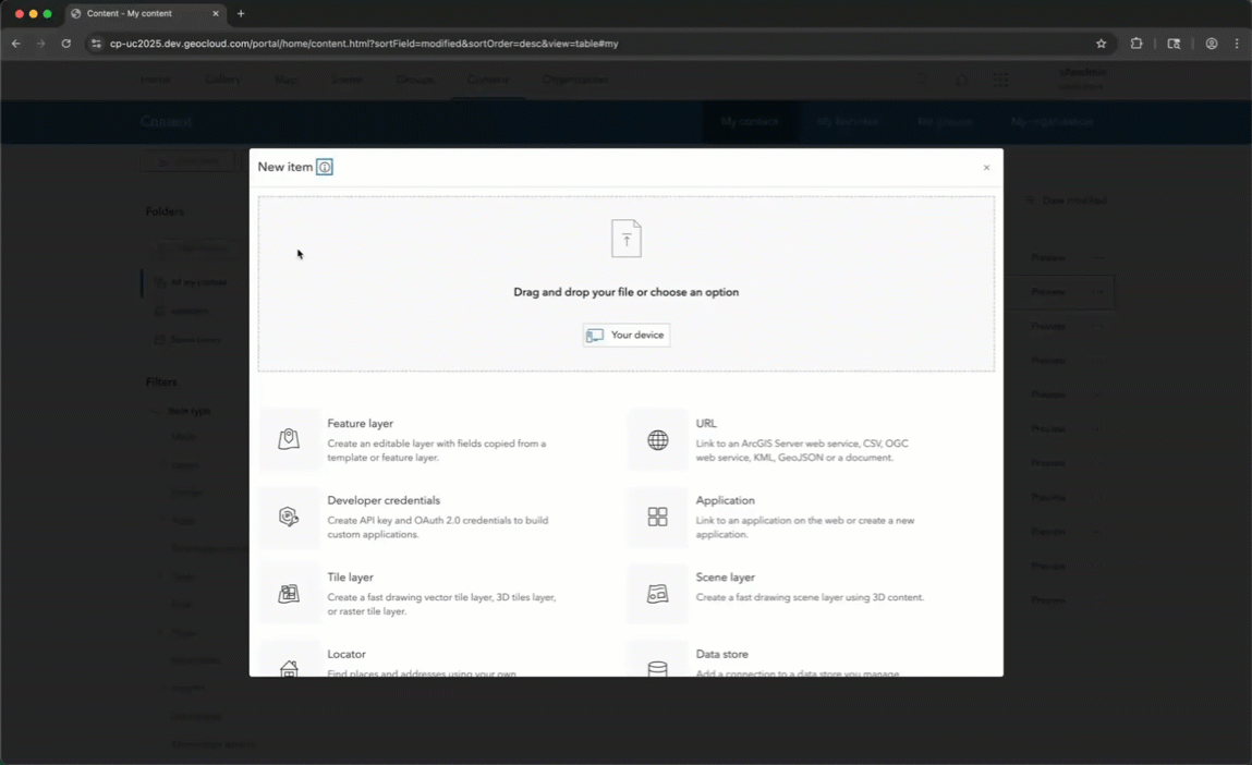

A quick way to add data to ArcGIS Enterprise is directly from the source. The list of supported items that can be added to ArcGIS Enterprise is extensive. In ArcGIS Enterprise, you can add data from a variety of sources including Microsoft Excel, GeoJSON, shapefiles, service definition files, and more. Depending on the type of file you’re uploading, some file types, such as zipped file geodatabases and GeoJSON files, allow you to publish a hosted feature layer during upload, making the data immediately usable in web maps and apps.
GIF showing workflow of adding a GeoJSON file to the ArcGIS Enterprise portal showing the "new item" drag and drop box and fields to fill out
Adding a GeoJSON file to the ArcGIS Enterprise portal and creating a hosted feature layer.
One thing to consider is that this method is best for static data that doesn’t require frequent updates. If the underlying data changes, the uploaded version in ArcGIS Enterprise will not automatically reflect those changes and would require either manual effort or a Python script to refresh the data. Additionally, this method typically assumes that the data is prepared and ready to use and does not require pre-processing to clean or format.
Best For: Users who require a quick, one-time method to bring static data into ArcGIS Enterprise as a hosted layer.

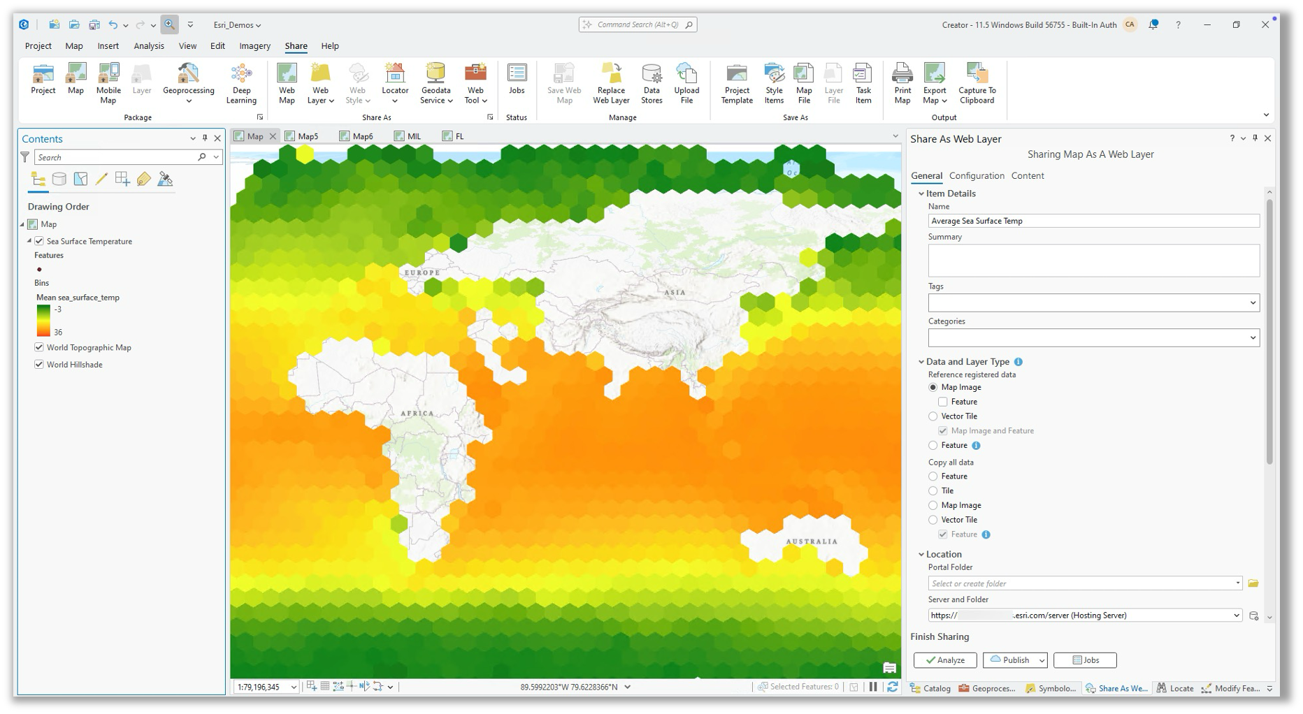

Users can publish web layers from ArcGIS Pro to ArcGIS Enterprise by referencing source data from a user-managed data store such as an enterprise geodatabase, relational database, cloud data warehouse, file share, or cloud storage location. This method avoids data duplication and ensures that maps and apps always reflect the most current information, as the web layer continuously accesses the original data source. Additionally, if the source data is stored in an enterprise geodatabase or a relational database, you can configure the web feature layers to support editing.
Screenshot of ArcGIS Pro showing the Share As Web Layer pane, with a world map displaying sea surface temperature data in a hexagon grid overlay.
Query layer in ArcGIS Pro showing average sea surface temperature from a Google BigQuery table with 358 million data points, aggregated into feature bins with the Share as Web Layer pane open.
For example, a large retail firm that stores sales and store location data in a cloud data warehouse can use ArcGIS Pro to create a query layer that joins the latest sales figures to store locations. The query layer can then be shared to ArcGIS Enterprise and used in a dashboard that gives executives real-time insight into store performance. Because the web layer used in the dashboard references the source data in the cloud data warehouse, the dashboard will always be up to date.
ArcGIS Pro also allows users to publish layers to ArcGIS Enterprise with the option to copy all data. However, when data is copied during publishing it no longer references its original source. To learn more about how data is shared when publishing from ArcGIS Pro, refer to this documentation.
Best For: Publishers who want to share referenced web layers that maintain live connections to user-managed data stores.

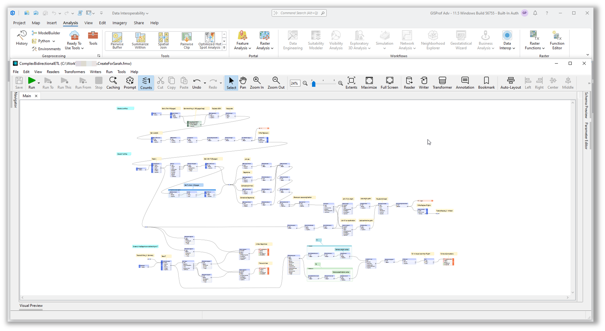

For more complex data transformation needs, consider using ArcGIS Data Interoperability. This licensed extension enables organizations using ArcGIS Pro and ArcGIS Enterprise to create complex ETL (extract, transform, and load) workflows without writing code. These workflows can be used to integrate data from file formats or data sources that are not supported natively, and it can also write data back to the source location outside of ArcGIS. In ArcGIS Pro, this extension provides users with an intuitive, visual diagramming interface that can be used to engineer data.
FME Workbench shows a complex workflow diagram. Lines connect various boxes and processes, visualizing a data transformation or integration project.
Complex ETL workflow built using the ArcGIS Data Interoperability extension in ArcGIS Pro.
In ArcGIS Enterprise, the ArcGIS Data Interoperability server extension allows publishers to share their ETL workflows as a web tool (also referred to as a geoprocessing service). These can then be run ad-hoc by users of ArcGIS Enterprise, or they can also be scheduled to run at a later time or at an interval of the user’s choosing. Support for scheduling web tools was introduced with ArcGIS Pro 3.4 and ArcGIS Enterprise 11.4. For organizations working on earlier versions of ArcGIS Enterprise, web tools will need to be scheduled using a notebook and the ArcGIS API for Python.
If your organization is looking to integrate data from data sources that aren’t supported natively in ArcGIS, and/or need to do complex data preparation workflows and data transformations, this extension will provide you with the powerful data engineering capabilities that you might be seeking.
Best For: Data engineers or GIS analysts building complex ETL workflows who desire a no-code solution.

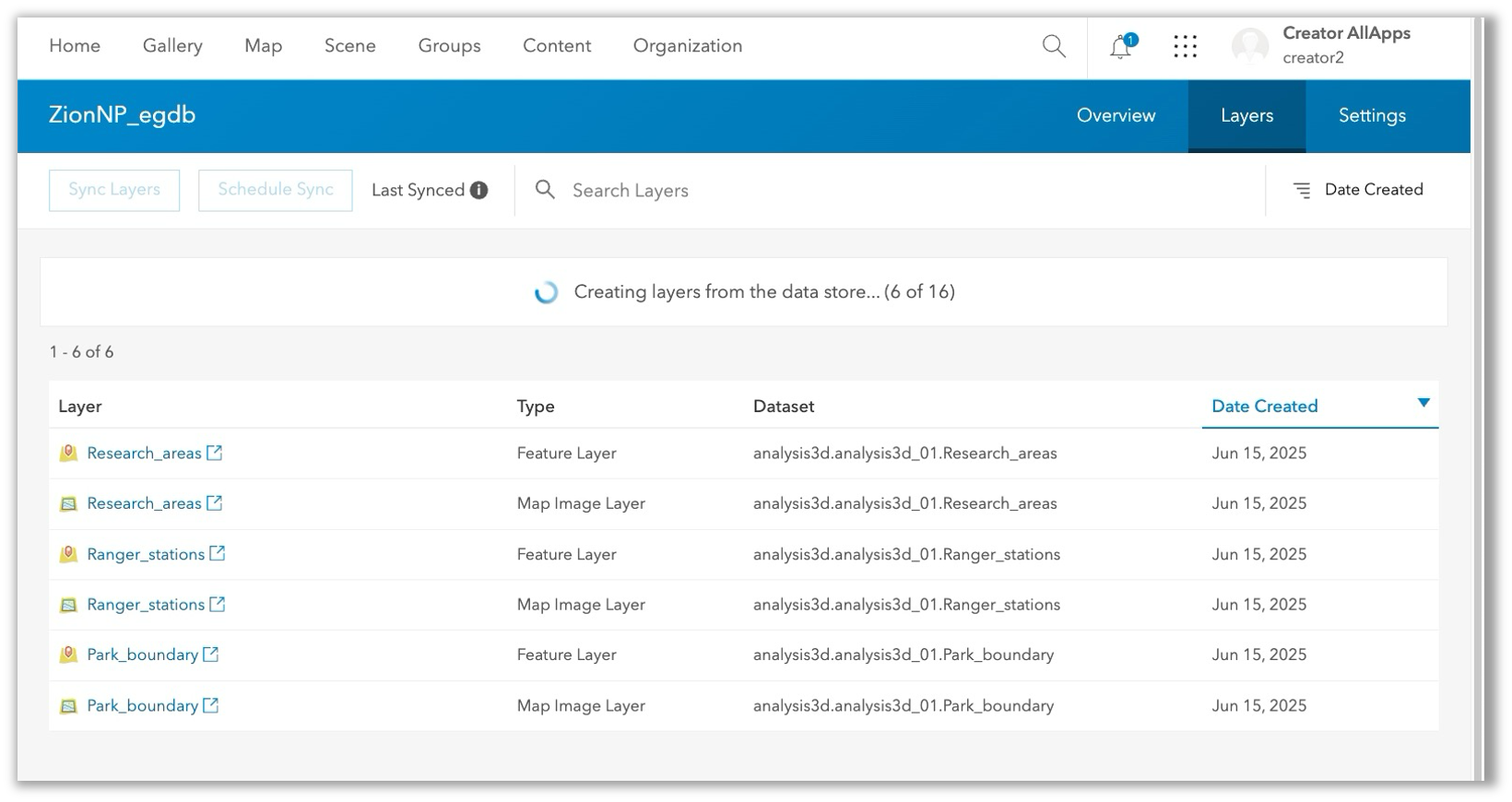

For organizations seeking a streamlined method to publish map image and feature layers that reference data from a relational database, bulk publishing is a solution to consider. As the name suggests, bulk publishing allows you to publish many feature classes or tables as web layers simultaneously, simplifying the process significantly.
This process begins with creating a database connection file (.sde) in ArcGIS Pro for an enterprise geodatabase or relational database. The file is then added as a data store item to ArcGIS Enterprise. Once created, the data store item’s owner can navigate to the item page and select the option to create layers from the Layers tab.
ZionNP_egdb "Layers" tab showing 6 of 16 layers. Columns include Layer, Type, Dataset, and Date Created. Creating layers from the data store.
Publish all feature classes and tables in a relational database from the data store item in the ArcGIS Enterprise portal.
The number of web layers generated depends on the number of feature classes and tables accessible through the database connection. For each dataset, both a map image layer and a feature layer item will be created. Editing and sync will not be enabled on the feature layer to start, but the publisher can enable it from the ArcGIS Enterprise portal or in ArcGIS Server Manager.
Given that all data is published through this workflow, it is crucial to carefully consider which datasets the user specified in the connection file can access. Ensuring appropriate access and privileges for the database user is essential to avoid unintended data exposure.
To learn more, see: Publish layers in bulk from a user-managed data store.
Best For: Database administrators or GIS managers who want to streamline publishing web layers by reference from a relational database.

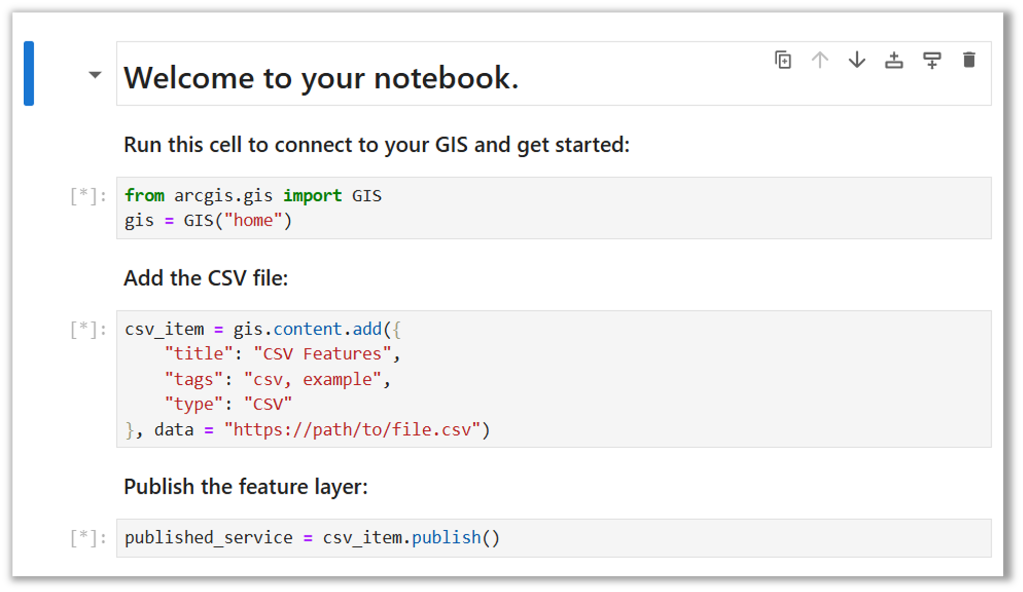

For example, a city’s public works department could use the ArcGIS API for Python to download a CSV file from a URL and publish it as a web layer to ArcGIS Enterprise.
Code snippets from a notebook. The snippets show how to connect to GIS, add a CSV file, and publish a feature layer.
The ArcGIS API for Python is used to publish a hosted feature layer from a file.
To update the data in ArcGIS Enterprise, a notebook author could update their script to overwrite a web layer in their content and schedule it to run weekly. While ArcGIS Notebooks offers many benefits, as it is fully integrated with ArcGIS Enterprise, scripts that leverage ArcGIS Python libraries can also be written and run external to ArcGIS Enterprise as well.

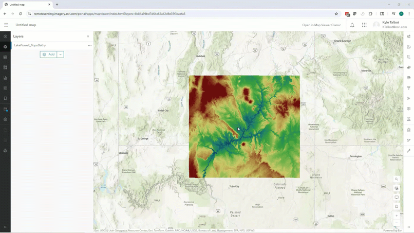

GIF exploring a Lake Powell TopoBathy map showing processing templates like contour (100) and hillshade.
Dynamic image service published from a mosaic dataset with raster functions enables on-the-fly visualization and analysis.

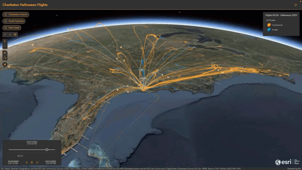

ArcGIS GeoEvent Server enables real-time event-based data streams to be integrated with ArcGIS Enterprise and used to update feature services. Event data can be filtered, analyzed, and sent to multiple destinations concurrently, enabling faster response times, automated notifications, and more effective decision making. For example, airports can integrate real-time flight position data with their enterprise GIS to enhance situational awareness and streamline daily operations such as gate assignments, runway scheduling, and emergency response. Historical flight path observation data can also be visualized and analyzed in ArcGIS uncovering patterns and supporting geospatial analytics.
Aerial view of flight routes from Charleston on Halloween.
Real-time flight data from FlightAware is streamed into ArcGIS Enterprise using ArcGIS Velocity.
Unlike other integrations mentioned here, ArcGIS GeoEvent Server is event driven and works based on a “push” rather than a “pull” model, meaning that data is brought into ArcGIS Enterprise without having to make requests for it. Once the event-based data stream is deployed, clients do not need to continuously request updates, as new data is pushed automatically into the system. Common data formats and data streams from IoT sensors, GPS devices, and other push feeds on the internet are natively supported, including TCP, MQTT, RSS, and HTTP.
GeoEvent also includes powerful tools for analytics, such as dynamic geofencing and visual analytic models that can be used to gain new insights, including support for alerts that can communicate actionable information when time is of the essence.
If real-time situational awareness, such as tracking moving assets or monitoring stationary sensors in the field is a need for your organization, then integrating live data feeds into ArcGIS Enterprise using ArcGIS GeoEvent Server is the solution for you.
Best For: Organizations who want to enable real-time solutions by integrating data from IOT sensors and other live data feeds.

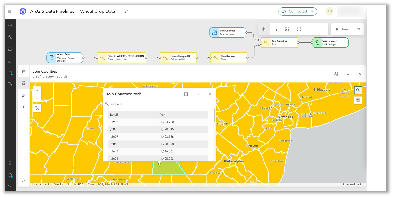

ArcGIS Data Pipelines displays a wheat crop data workflow, filtering by wheat production and pivoting by year, with a map showing York County data.
CSV data from Azure Storage is cleaned, transformed, and enhanced with spatial information from an ArcGIS Living Atlas feature layer using a join.
