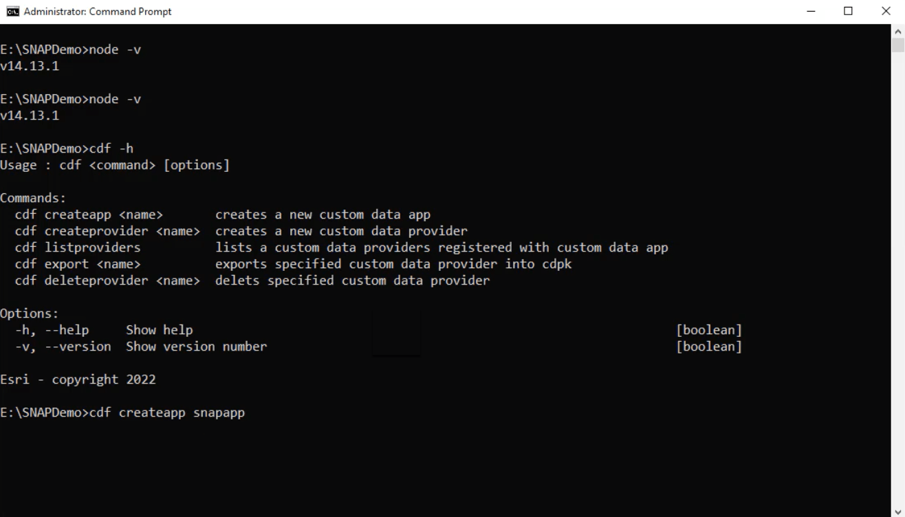

Step 1: Create a custom data provider
To create your custom data provider, open command prompt on the developer machine; you will be using the cdf command line tool.
Image of command prompt with the cdf command line tool open.
The cdf command line tool comes installed with the ArcGIS Enterprise SDK.
Next, you will create a skeleton Node.js app.  Using the IDE of your choice, you can open the project and add the relevant provider information.  While the product documentation contains samples to help get you going here, the provider information will vary depending on the data source and what information you want to include in your feature services.
Image of an IDE editing the custom data feed project.
Using the IDE of your choice, you can edit your custom data feed provider project.
Once you are done adding the necessary provider information to the project, you can export a custom data provider package (.cdpk) through command prompt using the cdf command line tool.

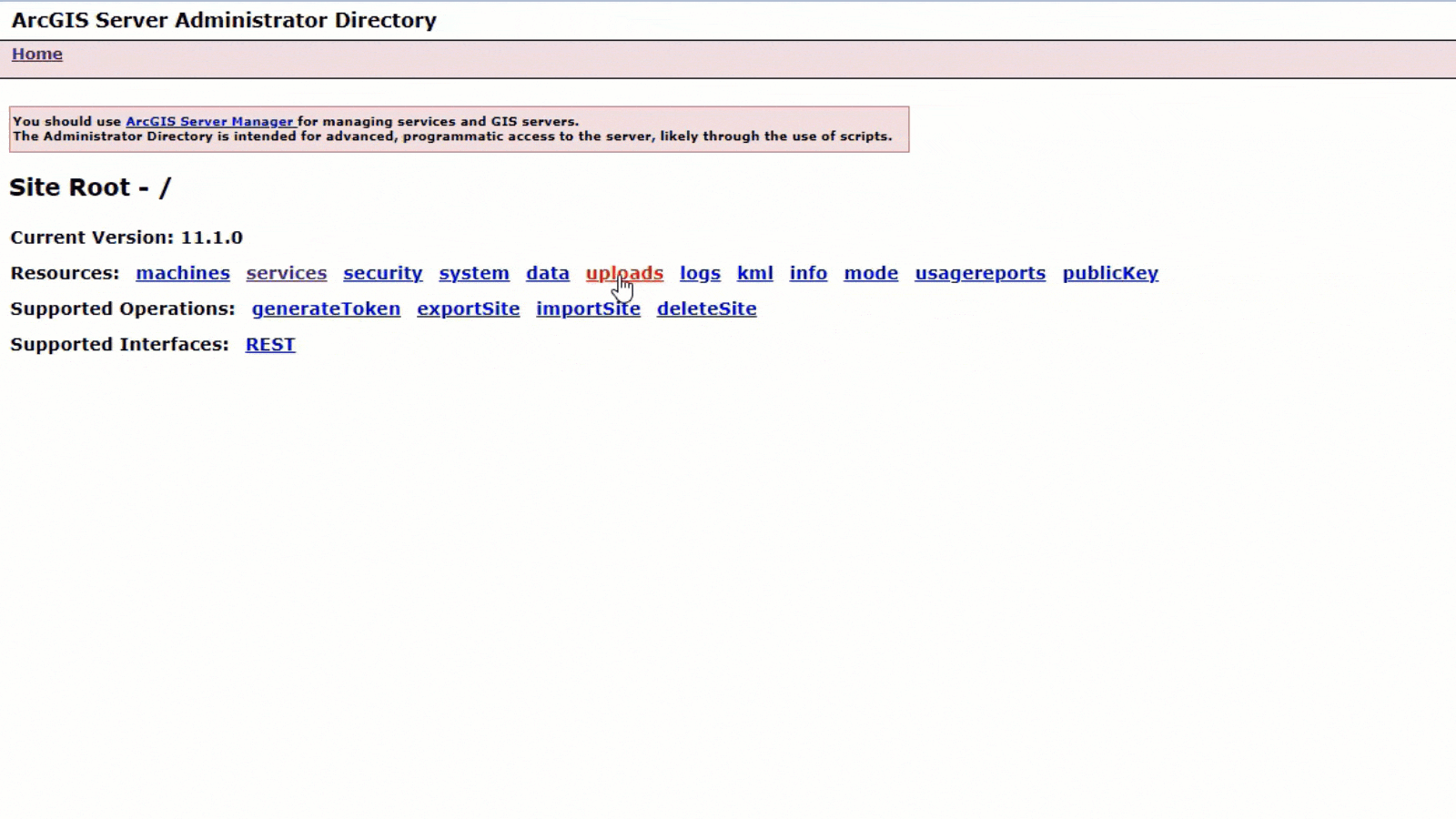

Step 2: Deploy the custom data provider
Once the .cdpk has been exported, it can be uploaded via the ArcGIS Server REST Admin API using the upload operation.  Once uploaded successfully, there will be an item ID that you will need to make note of.  This item ID will be used to register the custom data provider with ArcGIS Server.  This allows ArcGIS Server will know this custom data provider can be used as a data source for feature services.
Once the .cdpk is created, it will need to be uploaded via the ArcGIS Server REST Admin API.

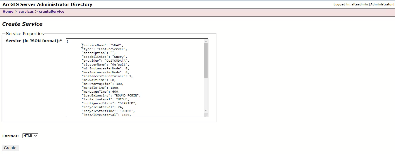

Step 3: Create a feature service
Once the custom data provider has been registered with ArcGIS Server, you’ll still be working in the ArcGIS Server REST Admin API to create your feature service via JSON.  Make sure to update the feature service JSON object with the correct provider name and associated properties before creating a feature service. This feature service will connect with the custom data provider to serve data from the appropriate source. This feature service will be read-only and will only have query capabilities enabled for all layers.
An image of the ArcGIS Server REST Admin API, where a feature service can be created.
Feature services can be created through the ArcGIS Server REST Admin API.
