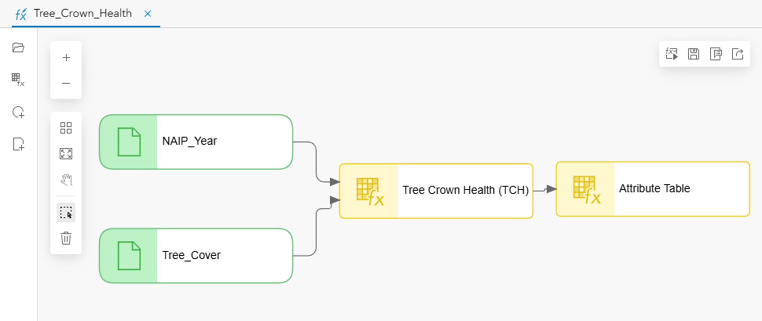

In this example, the Tree Crown Health raster function is chained together with the Attribute Table raster function to produce an improved visualization with a customized color scheme.
Tree crown raster function template
Tree crown health raster function template.

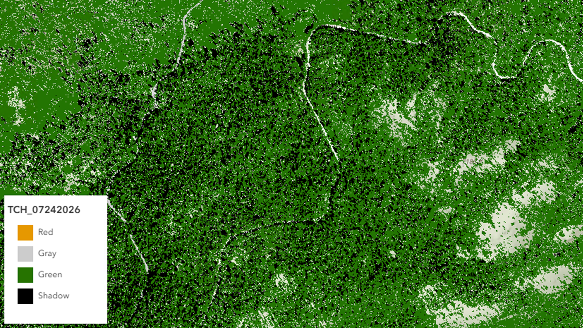

Running the Analysis
The Tree Crown Health function accepts:
  • A three-band NAIP image
  • A tree mask identifying vegetation areas
When the analysis is submitted, ArcGIS Enterprise distributes the custom raster function package to the Raster Analytics worker nodes running in Kubernetes, where the Python code is executed as part of the analysis workflow.
Each worker executes the Python code as part of the Generate Raster operation, allowing the processing to scale across the Kubernetes cluster for large imagery datasets.
The resulting output is a tree crown health map that visually identifies tree condition across the input imagery.
