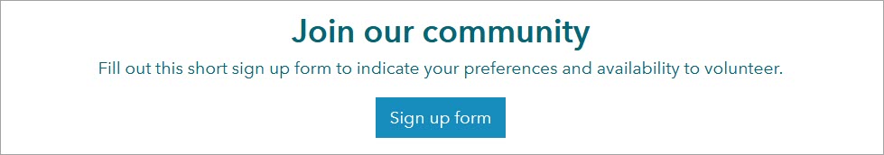

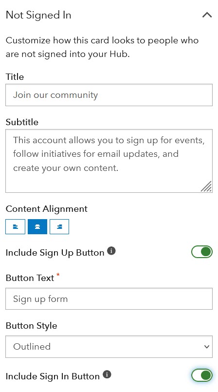

To make community accounts available to the public, an organization can set up a public site or page that includes sign up options, so that anyone can create a community account. Create separate public landing pages for different issues. Add a Sign up card to the site or page layout with a compelling call to take action that is related to the topic of the site or page: “Share your ideas” or “Stay up to date” or “Volunteer.”
Add a sign up card
Add a sign up card
Include clear information with the sign up button such as project goals and how a community member could participate if they sign up. You can use more than one sign up button and include it on relevant pages attached to your site.
Answer common questions about community accounts right off the bat. Link this information from the text around the sign up button to help community members be prepared to contribute productively. Customize these frequently asked questions to fit your needs.

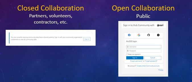

Sign up and other engagement options can be relatively open or closed (public or private) depending on the nature and purpose of your site. You can turn off the Follow button if you want a more focused or selective process for community member involvement. If you are using workspaces (beta), this setting is in the site workspace on the Followers pane (Settings tab).
Closed or open collaboration for community organization
You can also create initiatives and projects in your employee organization and add or invite specific community members to groups that are connected to these items. Note, it is not possible to prevent community members from creating duplicate accounts based on different email addresses.

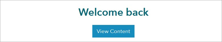

You can configure a Sign up card on a site or page layout to include a Sign in button for visitors who have an account but are not signed in. You can also set up this layout card for visitors who have an account and are already signed in. Consider including a welcome message, a link to content, or an external link.
Welcome message for signed in users on sign up card for community organization
