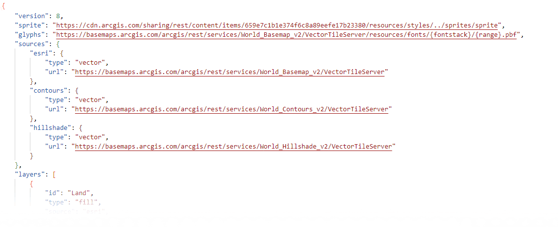

Our Vector Tile styles can be multi-sourced. Adding the hillshade and/or contour information to our Web Mercator basemaps is as easy as adding the URLs to the style’s header information. Here is the information from the ‘Outdoor Map’:
Header code showing the additions for the Hillshade and Contours
Once these services are established in the JSON, the feature layers can be positioned at any point – directly by adjusting the code, or by using the ‘Layers’ option in the VTSE.

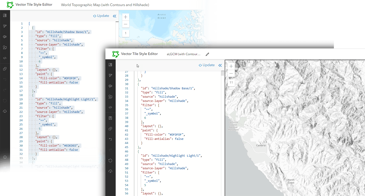

  • Open your new layer into the VTSE.
  • In a separate VTSE session, search ‘+ New Style’ for ‘ Hillshade’ and/or ‘Contours’ to access the default stand-alone styles.
  • Alternatively, open a map style  that has hillshade and contour layers (such as the ‘World Topographic Map (with Contours and Hillshade)’ or ‘Outdoor Map’). Choose the style that gets you closest to where you want to be.
  • Find the relevant code and copy it. You can search for it by source name (‘hillshade’ or ‘contours’).
  • Confirm that the source name for your new layers matches that in the header.
  • Paste it carefully into the code for your map wherever you think it is most suitable. Remember that the contours have labels that are usually in a different position within the code.
  • Update the code, and you should find the Contours and Hillshade displaying in your map.
An image of the Topographic Basemap in the VTSE, with the hillshade code selected, and another image showing the code inserted in the new map

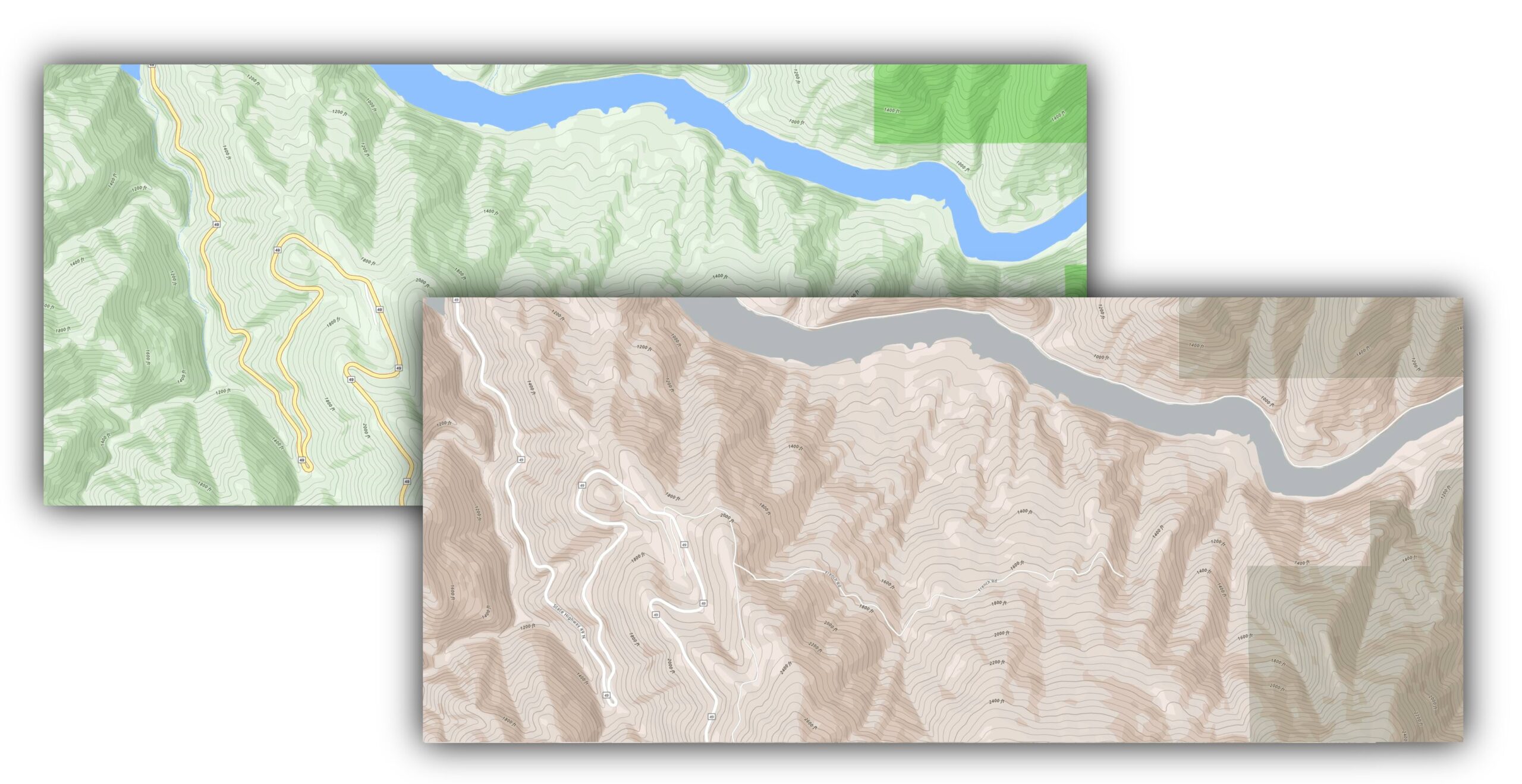

So, there are ways of inserting vector contours and hillshade services directly into your basemap, and adjusting them to improve the look. Neither is trouble-free, but the reward is a map/basemap that looks much more integrated than a series of separate map layers.  Here are two examples:
The Navigation Basemap, with vector hillshade/contours added in green, and the Light Gray Canvas Basemap with vector hillshade contours added in brown
