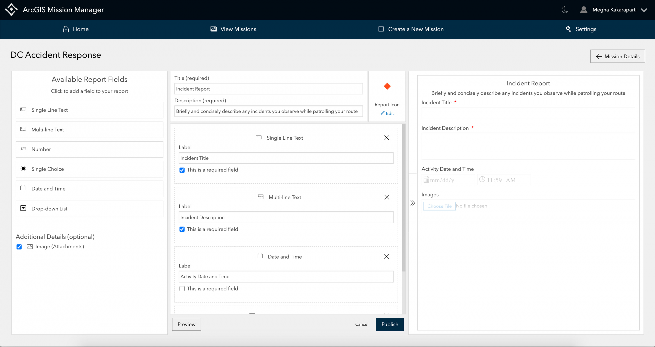

At the ArcGIS Mission 2021 Q2 release, we enhance the capability of reports by introducing the ability to create custom reports with different fields that apply to your mission’s purpose. These reports are created and published in ArcGIS Mission Manager by the mission owner or a portal administrator. When a report is created, you have the option to share it with your organization so others can leverage it as a template for a new report in a different mission. A Mission Report item and hosted feature layer is created in your portal each time a custom report is published. Once reports are submitted by mission members, they are displayed in a feed and displayed on the mission map. These reports can also be required as part of a mission task to help streamline the assignment of work .
Let’s look at the different field types that are available when creating a custom report:

Along with these field choices, you have the option to enable attachments on the reports layer, allowing members to include .jpeg or .png files when submitting their report. To visually customize how the report is displayed on the mission map, you change the report icon to fit the needs of your mission to include a color, shape, or size. Prior to publishing your report, you can preview it so you can see how it will look.

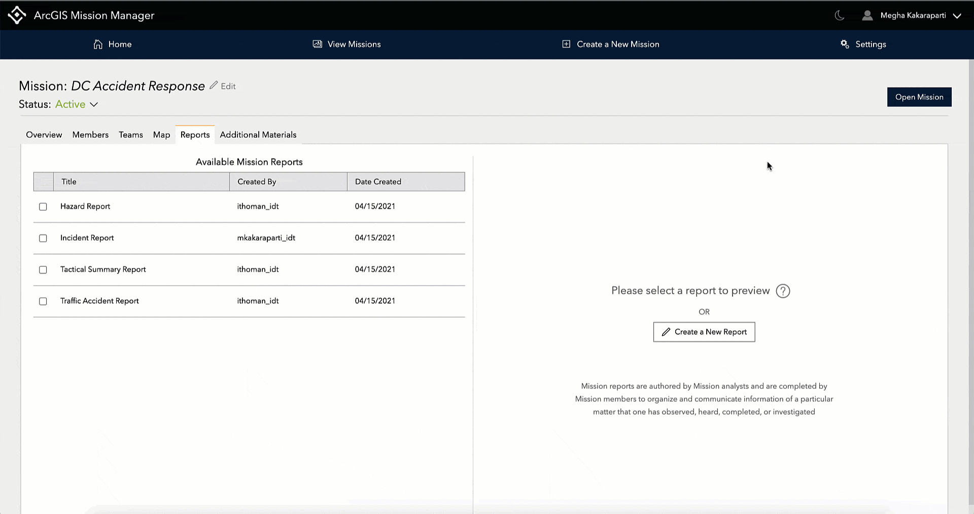

In addition to manually adding fields to your report, you can also leverage a report template and use it as a quick way to create a new report based on an existing schema . These report templates are available for use if they were  shared to your organization during their initial creation process. This is a quick way to use a report that is already created and fits your needs.
