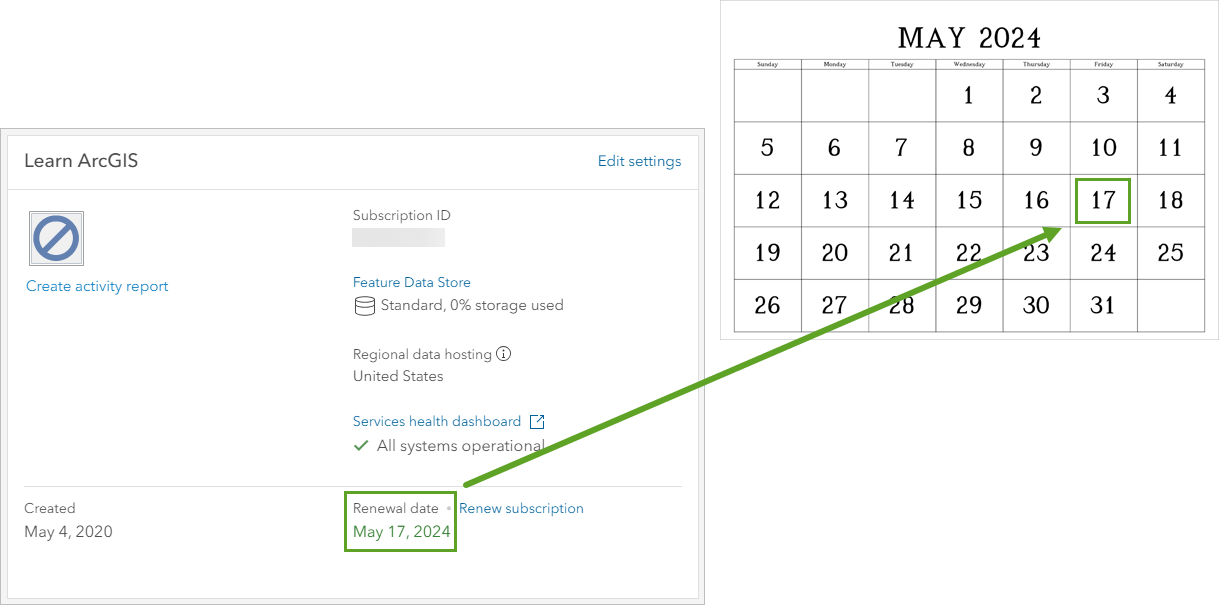

  Find your organization account’s renewal date and mark it on your calendar
The Renewal date is listed on the Organization > Overview tab, in your organization box (upper left). To ensure uninterrupted access to your organization, you don’t want to let it expire.
ArcGIS Online organization renewal date shown on calendar
Mark your organization renewal date on your calendar.

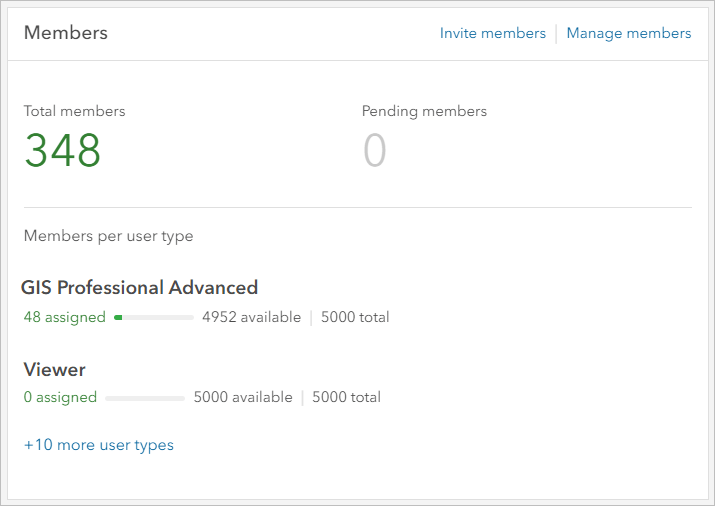

You’ll start by taking a look at how many members your organization has and how many can still be added. Some organizations may be very small, with one to five active members; some may be very big with 50,000 or more. Understanding the size of your organization will help you understand how frequently you’ll want to check in on it later, as more members and more activity means you’ll want to keep a closer eye on credit expenditure, content storage, and other categories that will be discussed in detail later.
ArcGIS Organization Overview page members view
  On the Organization > Overview tab, view the Members box to see how many members are in the organization and what user types are available.

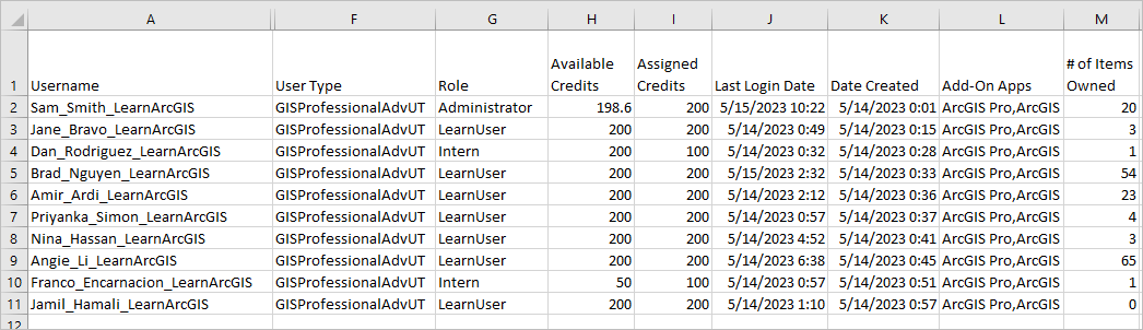

  On the Organization > Status > Reports tab, click Create a report. Choose Single Report, and for Report type, choose Member.
Sample User report

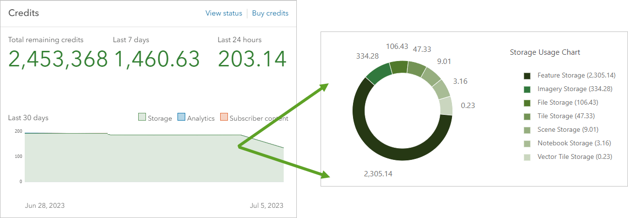

  On the Organization > Overview tab, use the Credits box to see how many credits your organization has available.
  On the Organization > Status tab, see how your organization’s credit usage over the last few weeks breaks down by storage, analytics, subscriber content, and published content.
  On the Organization > Members tab, use the Credits remaining column to see what credit budget each member has.
Credits dashboard on the Overview page and broken down on the Status page

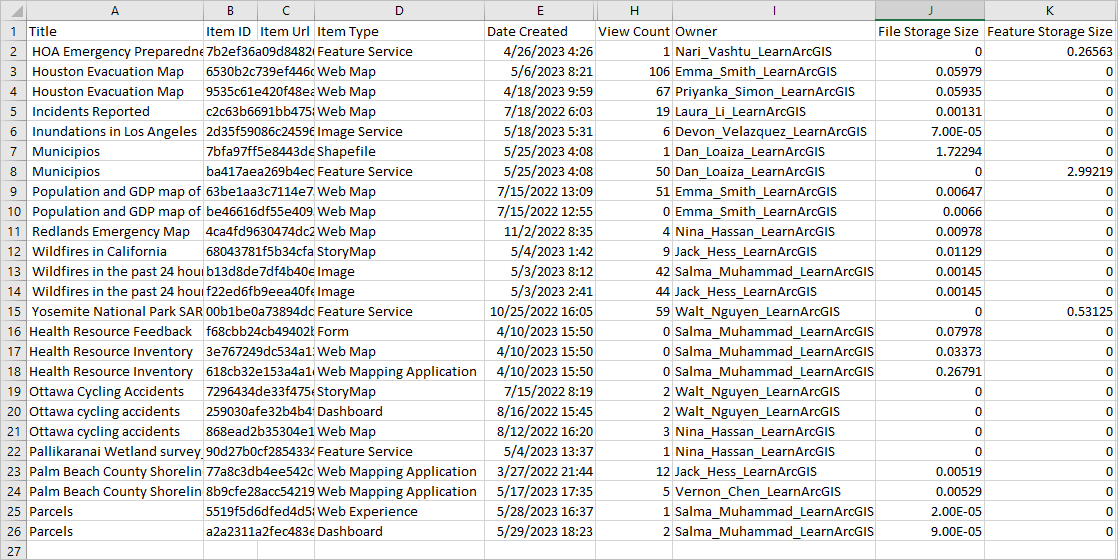

  On the Organization > Status > Reports tab, click Create a report. Choose Single Report, and for Report type, choose Item.
Like the Member report, this will serve as a snapshot of the organization on the day you create the report. Item reports show details such as the storage size of each item, its usage or popularity, and its sharing status.
  Schedule a Quarterly Item report.
Administrative report for items
