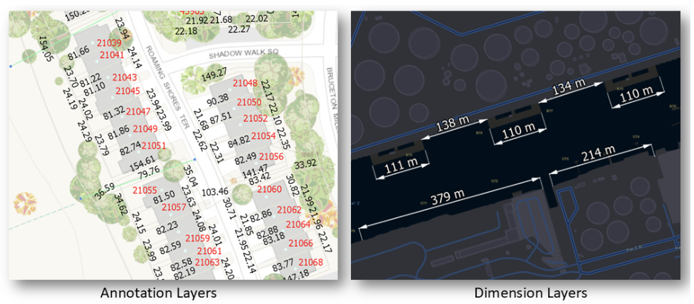

Annotation

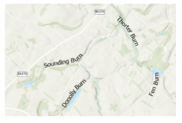

Annotation feature layers contain text that has been carefully placed and formatted to fit its surroundings. Unlike dynamic labels, annotation can be individually positioned, rotated, stretched, stacked, enlarged, or reduced to achieve a specific cartographic result. Think of it as labeling, but with way more control.
Annotation is like highly customized labels
Dimension

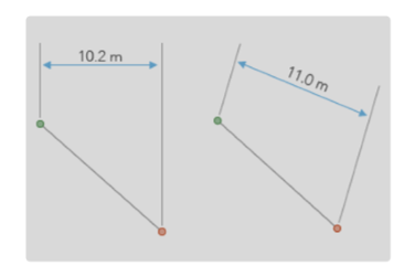

Dimension feature layers illustrate measurements on the map – think the length of a building, the offset from the curb, or the distance between two valves. They help provide important spatial context without requiring users to perform measurements themselves.
Dimensions quickly convey measurements on the ground

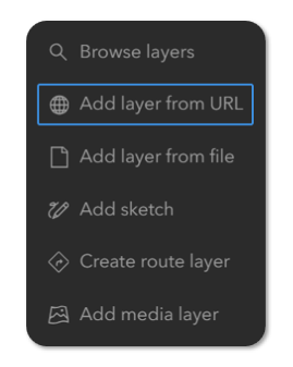

First, add a feature service containing annotation or dimension layers to the map using the service URL. Once added, the layers draw on the map alongside your other layers.
Add annotation and dimension layers to Map Viewer using the URL

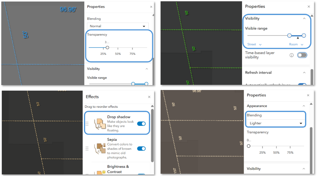

Fine-tune their appearance
Next, select the parent layer in the Layers pane, then you can adjust any of the following properties to change the appearance of the layers to better suit your map:
  • Add transparency to layers to help mesh them more naturally with the rest of your map, while keeping important information visible.
  • Set the visible range so the layers only draw at the appropriate scales.
  • Apply effects such as drop shadow, hue rotate, or adjust properties like saturation, brightness, or contrast.
  • Try blend modes such as Multiply, Overlay, or Screen to create visual effects that complement your basemap.
When you’re happy with your changes, you can save and share the map.
Adjust the properties to fine-tune the appearance of annotation and dimensions displayed on the map
