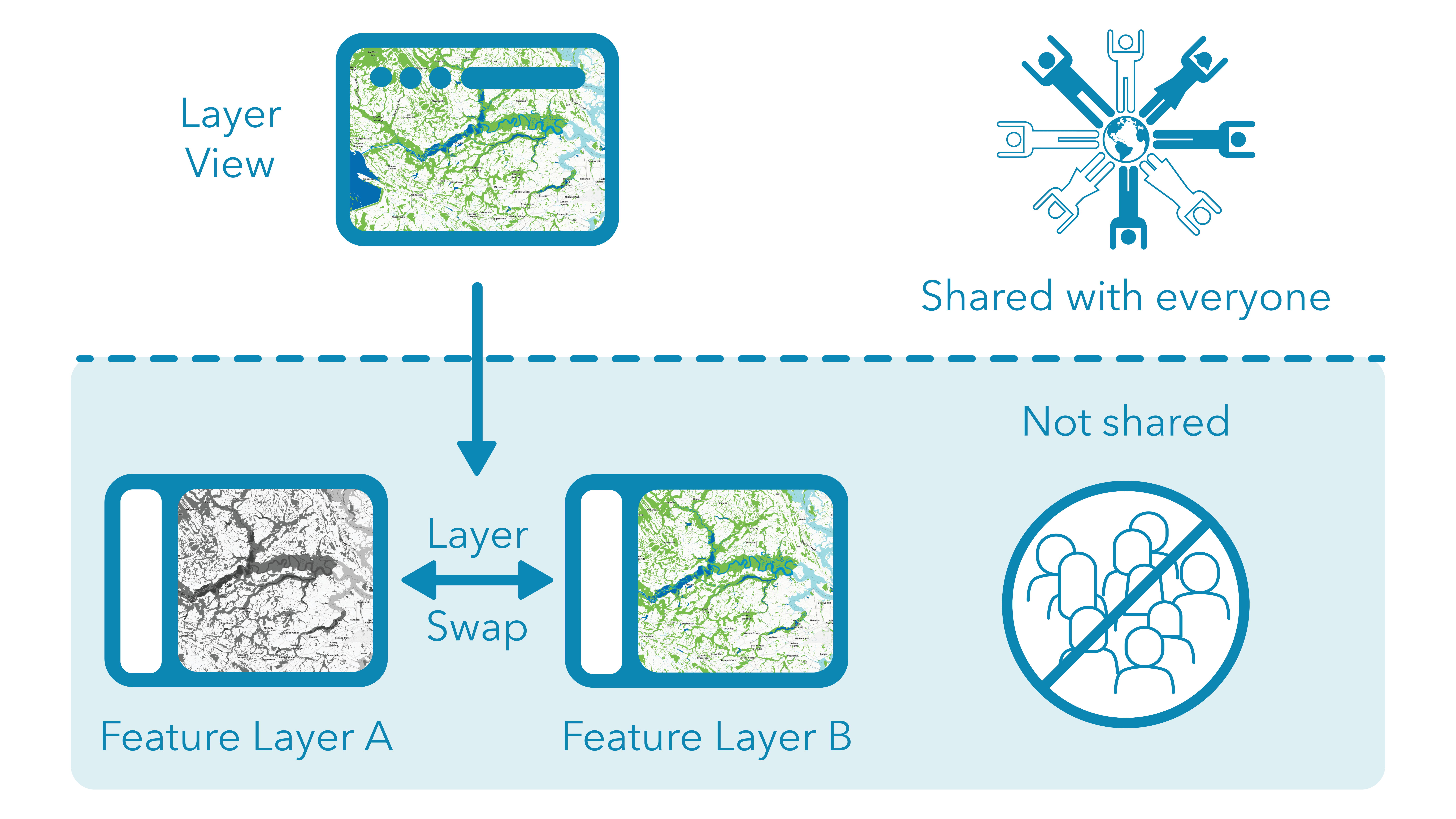

A hosted feature layer view looks and acts much like a hosted feature layer. However, layer views don’t have data of their own. As the name implies, layer views are simply a second view of a hosted feature layer that enables you to maintain a public facing layer view while keeping the feature layer behind it hidden.
This simple architecture of a shared layer view and a hidden feature layer enables us to do updates out of sight from our users and make updates with minimal impacts. ArcGIS Online provides a simple process to switch which feature layer a layer view uses. This layer swap is a powerful tool that will make your work easier.

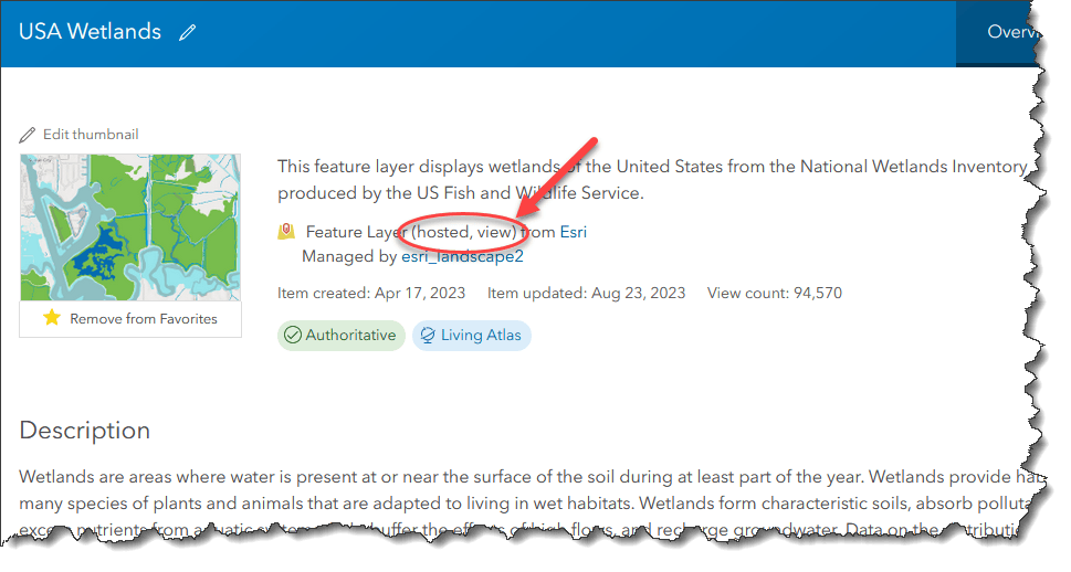

Start with a view layer. If you need help creating a view layer this blog will get you started. Note that you must be the owner or administrator of a hosted feature layer to create and manage layer views from it.
The item page tells us that this is a view layer

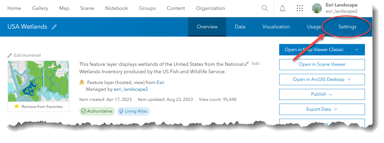

To swap layers, first click the settings tab, on the upper right of the layer view’s item page

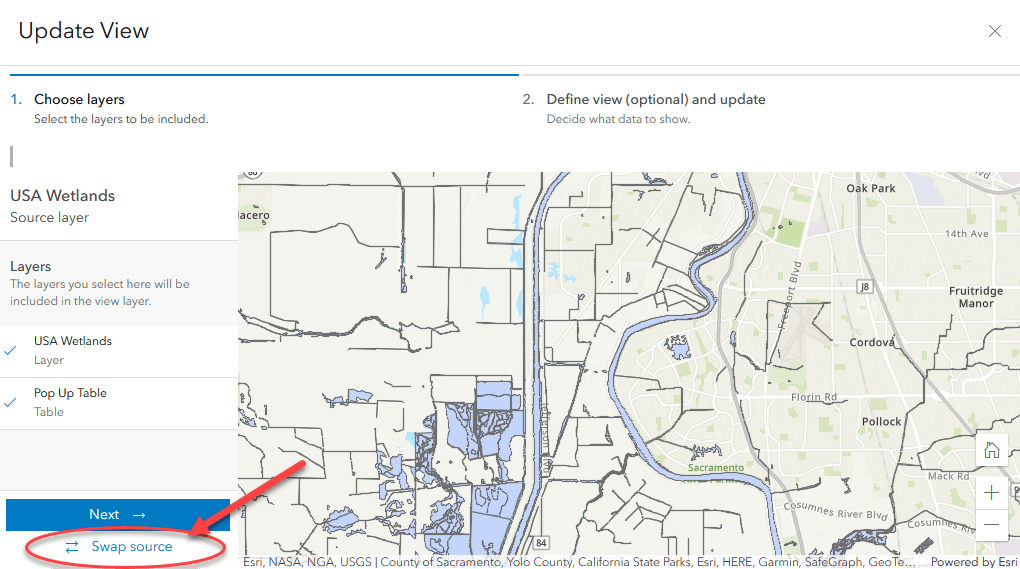

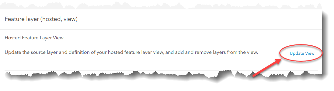

Then scroll down and click “Update View”

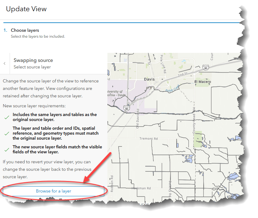

The Update View window will open. Select “Swap source” at the bottom of the window.
The window will remind you of the basic requirements for a layer swap to work. Click “Browse for a layer”.

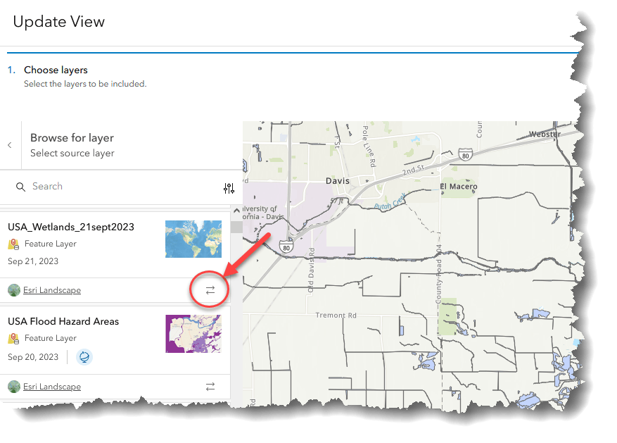

Find your replacement layer and click the arrows to swap layers.
