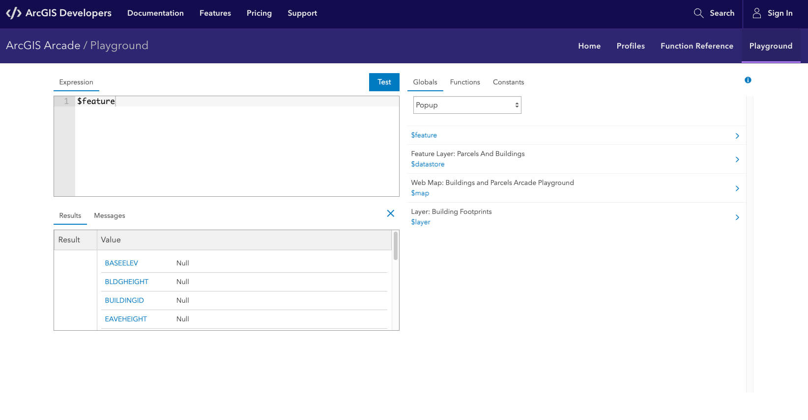

Updated Playground
The original Arcade playground was developed as a standalone environment for users to test their Arcade expressions and try out the latest features of Arcade.
The old Arcade playground as seen in the Developer doc site
As part of our ongoing effort to enhance the Arcade documentation site, we have updated the playground to use the new and improved Arcade editor. The new editor was introduced in the November 2022 release of ArcGIS Online and brought many powerful new features to enhance your experience with writing Arcade expressions. In the June 2023 release of ArcGIS Online, we’re bringing a new accessible color palette for better overall syntax highlighting / code colorization, meeting Web Content Accessibility Guidelines (WCAG 2.0).
Experience these enhanced capabilities firsthand in the new Arcade playground. With its user-friendly interface, along with advanced functionalities like syntax highlighting, auto-completion, and improved error messages, you’ll enjoy a seamless debugging and testing experience for your new functions. Witness instant results as you test and debug, empowering you to explore the full potential of Arcade in real-time.
The new Arcade playground as seen in the Developer documentation site

  1. Is the “old” version still available? We used to be able to change the values of profile variables for testing purposes. Now, it seems we are stuck with the one available feature, with only 3 fields (which can’t be changed) and the geometry.
    How are we supposed to test/evaluate if it is working correctly if we can no longer put in data values? As is, there isn’t even a way to test if the null/IsEmpty is working as expected, as there are no empty fields in the hard coded test feature.
    Would be nice to have this feature back so the playground is actually useable for something
    Thanks,
    R_
    • Hi Rhett, thanks for your feedback. You can easily bring in your own data values using any of the suggestions provided within the playground, such as “Feature from a portal item” or “FeatureSet from a portal item”. This will allow you to test your expression with your actual feature attributes, instead of updating a separate feature that is unrelated to your data.
      If you want to manually add/update data values, you can also just create a dictionary/array of values and use that for testing as well. Check out the debugging guide page for more info. Hope this helps!
