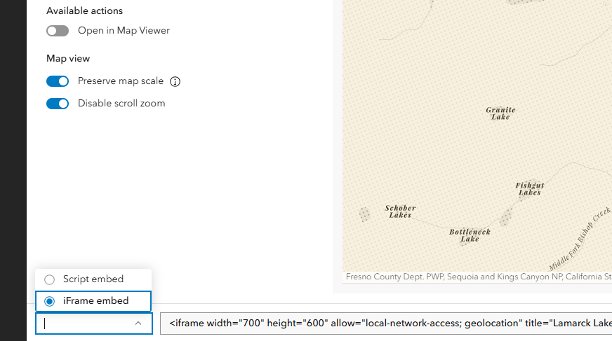

Both embed options can be accessed from the Embed map button on the Contents (dark) toolbar in Map Viewer (Ensure that you are logged in and have a publicly shared web map open).  The embed configuration window will open and you can customize the map elements you want to include in your output.
You will notice that there is now a new drop-down menu to the left of the HTML code. Script embed (the component approach) is the default, but you now have the option to select iFrame embed instead.
An image depicting a dropdown menu to choose an embed option.
The Map Viewer embed configuration now allows you to choose between script embed and iFrame embed.

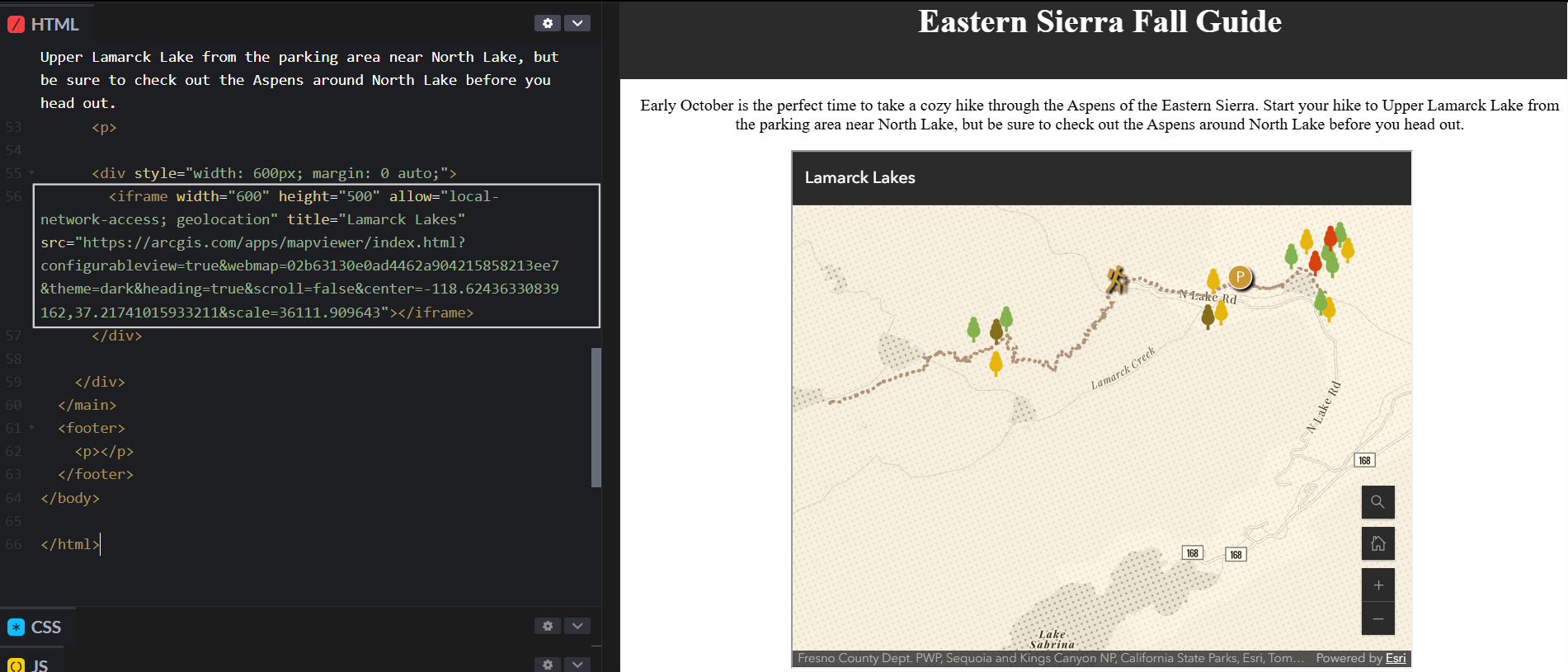

The iFrame embed leverages the new custom link sharing option from Map Viewer and wraps that link in an iFrame tag. You will see the HTML code update accordingly. As with Script embed, simply copy the HTML code and paste it into your web site.
An image showing the code and output from iframe embed.
Simply copy and paste the HTML code into your website to embed the map.
The visual output from both embed options should appear identical in your applications. Remember – with both script embed and iframe embed you can modify the code in your website at any time. Adjust the height or width of your map, add or remove map elements, update the zoom level, or even replace the webmap ID! Both options let you adjust these in the code after you have copied the HTML from the embed configuration window.

With this release we also added a toggle to the embed configuration to allow users more control over disabling scroll zoom when embedding. Scroll zoom continues to be disabled by default, but you now have control over whether you want to adjust that setting.  We will continue to explore adding additional map elements to the embed configuration and improving sharing options for non-public maps.
