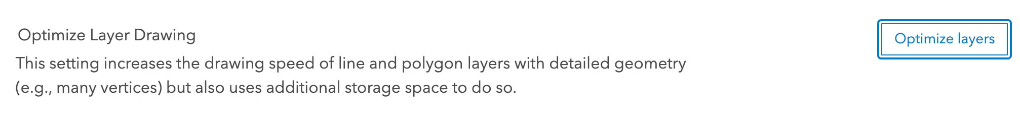

Tip #3: Run Optimize Layer Drawing
Alright, you have the layer in ArcGIS Online either from publishing from ArcGIS Pro or from uploading a GDB (do not publish from ArcMap). Now what? After fully configuring your Content Item, head over to the Settings tab. In the Feature Layer section, click the Optimize Layer Drawing option and let that run a few minutes.
optimize layers

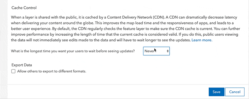

Tip #4: Cache the data on the CDN
After Optimize runs, scroll down to the last part of the settings page. You’ll see the cache is set to the default of 30 seconds. Now if your data is updating really fast, keep that. Most of us don’t run data updates every few minutes. For most layers, I crank that up to 1-hour. That means for 1-hour, any view, zoom level or query that someone makes will be held in memory.
Cache the data
