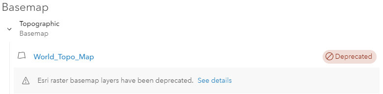

As we’ve announced previously, several of Esri’s raster basemaps moved to mature support in July 2021. If your web map is referencing one of these raster basemaps, you should notice that it is marked as deprecated in the item details (such as below).
Basemap with Deprecated Layer

If you find a web map that has a basemap layer marked as deprecated, you will want to update the web map to use another basemap. The easiest way to do that is via the Map Viewer basemap gallery, assuming you are using Esri vector basemaps in your gallery. Check out this blog article to confirm if you are, and learn how to update the basemap gallery if you are not.
Once you have confirmed that you are using the Esri vector basemaps in your basemap gallery, then it is a simple process to update your web map.
  1. Open in Map Viewer: on web map item details page, click button to Open in Map Viewer (or Map Viewer Classic).
  2. Open Basemap Gallery: in Map Viewer, click Basemap tool to display basemap gallery of options.
  3. Select a Basemap: after considering your options, choose the basemap style that will best support your web map.
  4. Save Web Map: once you’ve made a selection, click Save tool to update your web map, and test the behavior of the map.
  5. Check Item Details: just to be sure, reload the web map item details page to verify the basemap layer is no longer deprecated.
Voila! Your web map has a fresh basemap and you should be set for 2022 and beyond. If this web map is referenced by one or more web apps, the app(s) will use the new basemap the next time they are opened.
