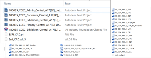

  • When multiple models have the same location for the base point, they were linked within a single or continuous structure sharing the same origin point. Thus, the universal projection or universal WLD3 can be leveraged to reduce the number of files and steps needed for the georeferencing process.
    • This is done by georeferencing a single model (the smallest file that has a clear depiction of elements that can be used for georeferencing), and after the georeference is completed, changing the name of the .prj file or .wld3 file using File Explorer to ESRI_CAD.prj and or ESRI_CAD.wld3.

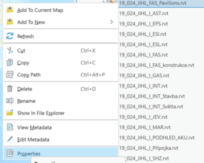

1. Select the BIM file workspace in the Catalog
2. Go to Properties.
Property Window for the Digital Model
The File Property window appears.

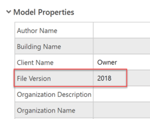

4. Go to Model Properties.
5. Look at the File Version.
Digital Model File Version
In this case, the file version is 2018, so you can upgrade the file.

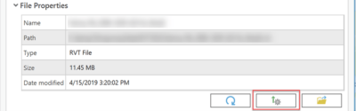

6. Go to General.
7. Click the Upgrade button.
Upgrade Digital Model Button
Upgrade Window Properties
This will take a few minutes.

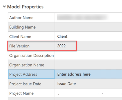

If you check Model Properties again, you will see that the file version is now 2022.
Upgraded Digital Model
Digital Model File Version (Upgraded)

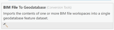

1. Click the Analysis
2. Click Tools.
3. Search for the BIM File To Geodatabase geoprocessing tool.
BIM File to Geodatabase Geoprocessing Tool
4. Click the geoprocessing tool.

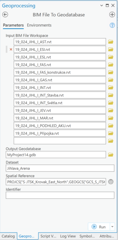

5. Fill out the required parameters in the geoprocessing tool.
  • For Input BIM File Workspace, select all the BIM File Workspace files.
Revit and IFC files can be used as inputs on the same run of the BIM File to Geodatabase geoprocessing tool.
  • For Output Geodatabase, select the default geodatabase created by the project.
  • For Dataset, rename the file to something that makes sense to you.
In this case, I named the dataset based on the contract.
  • For Spatial Reference, choose a reference based on the .prj file that the project is using.
  • Optionally, for Identifier, use a unique identifier that works for your organization.
In this example, I used the date that the dataset was created, but it could be used as way to identify the building on a campus\facility. This identifier is added to all the elements in the dataset.
BIM File to Geodatabase Geoprocessing Tool Populated
6. Click Run.

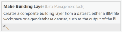

1. Search for the Make Building Layer geoprocessing tool.
2. Click the geoprocessing tool.

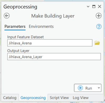

3. Fill out the geoprocessing tool parameters.
  • For Input Feature Dataset, browse to the dataset created in step 6.
  • Optionally, for Output Layer, give the layer name the same name as the dataset.
Make Building Layer Geoprocessing Tool
Make Building Layer Geoprocessing Tool Input
4. Click Run.

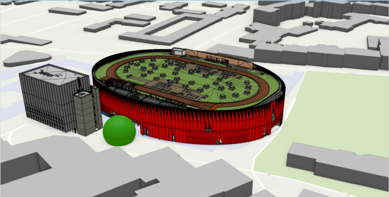

The run of the tool will take some time as the files are very detailed.
Jihlava Multipurpose Arena Single Building Layer
Jihlava Multipurpose Arena as a Single Building Layer

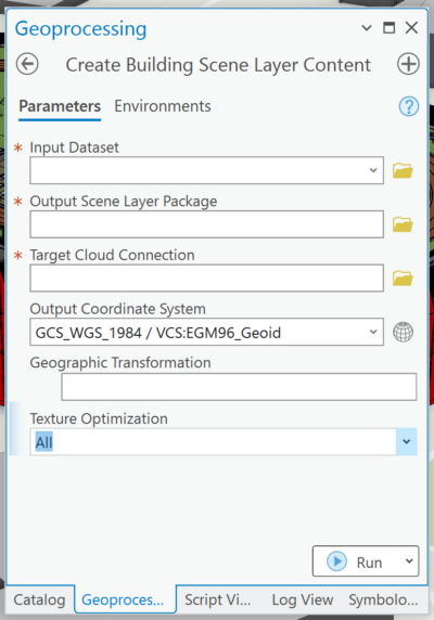

1. Search for the Create Building Scene Layer Content geoprocessing tool.
Create Building Scene Layer Content Geoprocessing Tool
Building Scene Layer Content Geoprocessing Tool Input
  • For Input Dataset, select the building layer c180035_CCEC_Layer.
  • For Output Scene Layer Package, select the location where you want the package to be stored.
  • For Output Coordinate System, accept the default coordinate system.
  • For Texture Optimization, select All.
For additional information on texture optimization, visit the help documentation.
Building Scene Layer Content Geoprocessing Tool Populated
4. Click Run.
