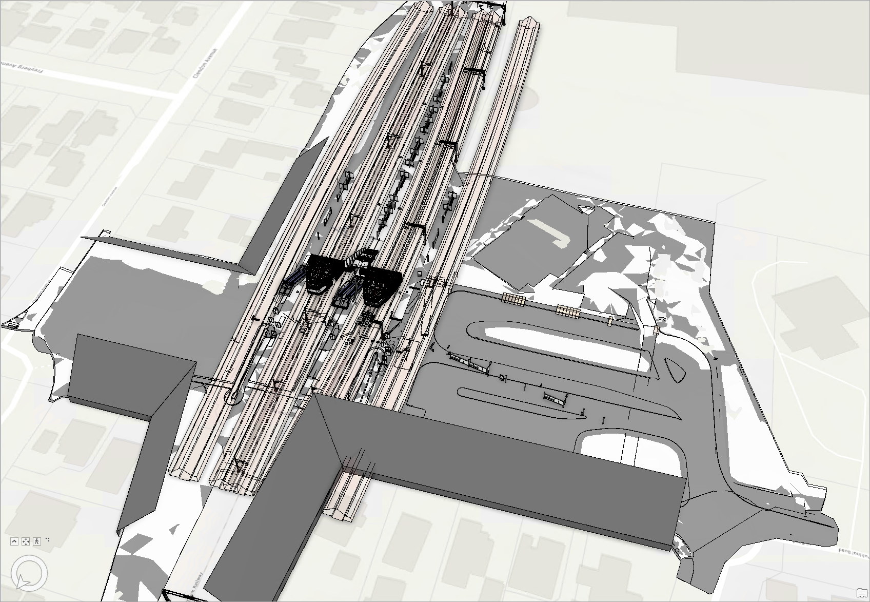

If you look in more detail at the images below, you can see that the generic model layer includes street furniture, catenary masts, escalators, and more. To meet operation and maintenance (O&M) requirements, you must move these elements to more appropriate and specific categories.
Generic Model Elements deatil
Example of Generic Model Elements

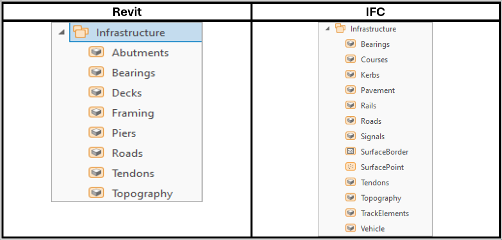

As you can see below, the BIM file workspace for the Revit infrastructure discipline is focused on bridges while the BIM file workspace for the IFC infrastructure discipline covers rails, roads, and bridges layer.
Infrastructure schema for Revit and ifc

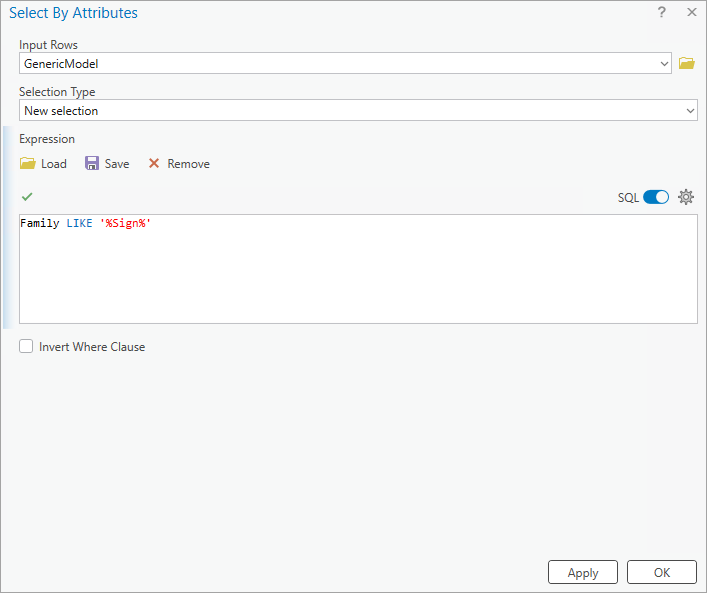

1. Click Select by attribute.
  • For Input Rows, select GenericModel.
  • For Selection Type, select New Selection.
  • For Expression, type Family LIKE ‘%Sign%’.
Select By Attribute Geoprocessing Tool
2. Click Apply.

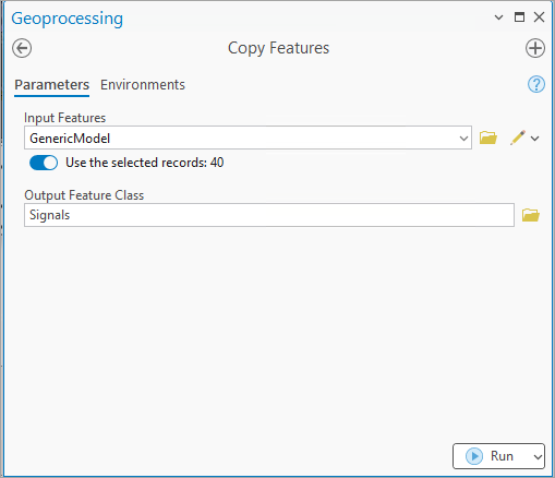

3. Open the Copy Features geoprocessing tool.
  • For Input Feature, select GenericModel.
  • For Output Feature Class, select Signals.
Copy Feature Geoprocessing Tool - Feature Class Signal
4. Click Run.
Only the selected elements copy to the new feature, based on the selection made in step 1.

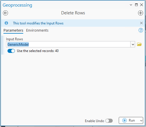

5. Open the Delete Rows geoprocessing tool.
6. For Input Rows, select Generic Model.
Delete Rows Geoprocessing Tool - Selected Element
7. Click Run.
Only the selected elements are deleted from the GenericModel feature class, based on the selection made in step 1.

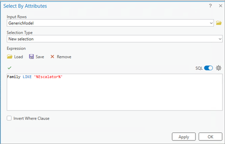

  • For Expression, type Family LIKE ‘%Escalator%’.
Select By Attribute Geoprocessing Tool - Append Step

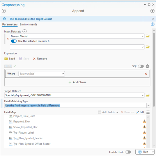

2. Open the Append geoprocessing tool.
  • For Input Datasets, select GenericModel.
  • For Target Dataset, select SpecialtyEquipment.
  • For Field Matching Type, select Use the field map to reconcile field differences.
Append Elements to the Specialty Equipment Feature Class
3. Click Run.
In this case, you are not interested in matching attributes between the source and the target as you only need a limited number of attributes, and you know those attributes are present since they were defined on the BIM execution plan.

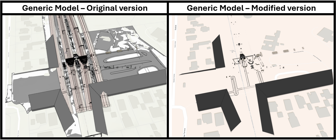

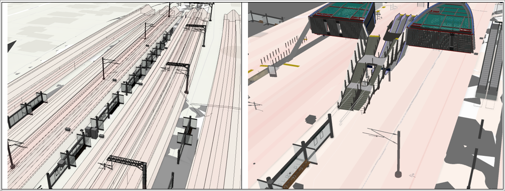

Result - Generic Element
Generic Model elements before and after the geoprocessing

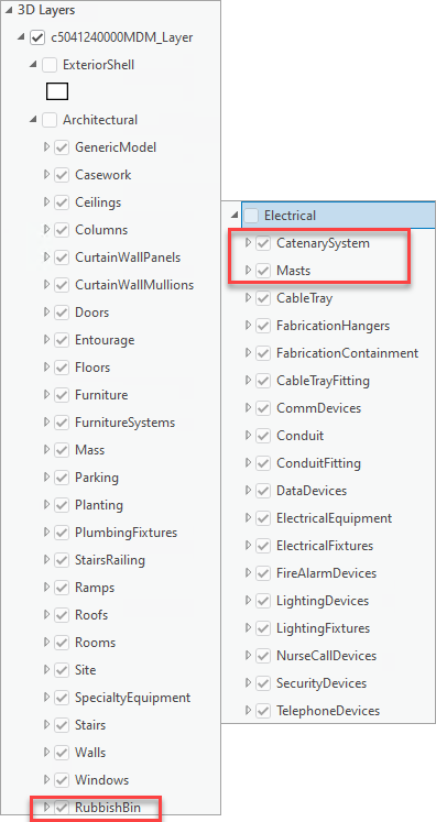

7. Run the Make building layer geoprocessing tool.

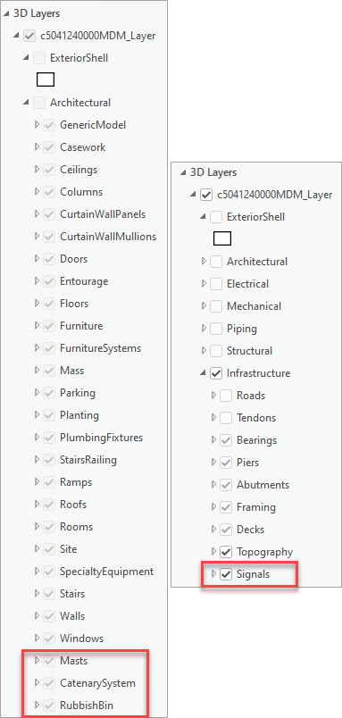

Now that the building layer has been created, look at the three new categories (Masts, CatenarySystem, and RubbishBin) created. The Signals and Rails categories are defined by the BIM file workspace IFC schema so you do not have to change their placement on the building layer. The building layer places custom categories in the architectural discipline, but in this case, you want to place Masts and CatenarySystem in the electrical discipline and leave RubbishBin in the architectural.
Default building layer after the geoprocessing
8. Drag the Masts and CatenarySystem layers to the electrical discipline.
Building layer feature layers rearrange
