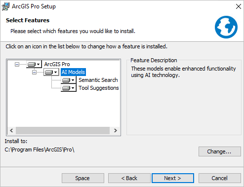

You can choose to install these features on the Select Features page of the ArcGIS Pro Setup dialog by clicking on the drop-down next to each AI Model.
The Select Features page of the ArcGIS Pro Setup dialog.
Select the AI features you would like to enable during installation.
The models are installed locally on your system with ArcGIS Pro, so there is no communication with an external service or transformation of data related to tool search or suggestions through a network. The functionality requires no internet connection, only installation.
Note: If you’ve already installed Pro 3.3, and missed the AI features, don’t worry, you can still install them! In the Windows Control Panel, select Uninstall a program, then select ArcGIS Pro from the list of applications, and click Change. You’ll get the ArcGIS Pro installation dialog with the option to Modify the install and enable the desired AI models.

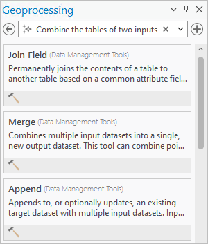

For example, on the Geoprocessing pane’s search bar enter: Combine the tables of two inputs.
You will receive relevant results such as Join field, Merge or Append.
Geoprocessing tool search results
Example of the top 3 search results when you make a query using semantic search.

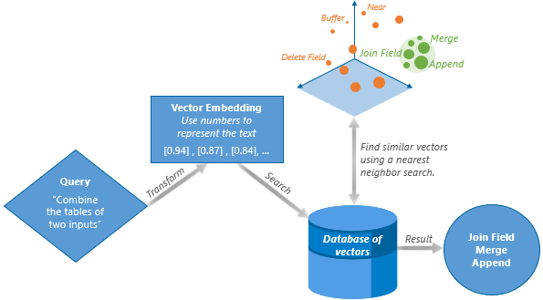

Semantic search is a foundation of AI technology and works by transforming text into a meaning vector (or embedding). A meaning vector is a numeric representation that describes the text using the many dimensions or aspects of semantic meaning in language. The semantic search engine compares your search query to a database of meaning vectors to find the tools that most closely match your search.
Flowchart showing how semantic search works with a vector database
Behind the scenes of the semantic search engine.
The first time you start ArcGIS Pro 3.3, it will take a few minutes to build the embeddings database for all geoprocessing tools. But don’t worry, this happens in a background thread so you can still perform other tasks, including searching for geoprocessing tools using the standard search engine.

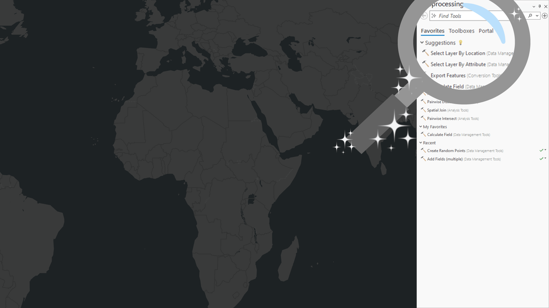

Have you ever started an analysis, then asked yourself, “which tool could I use next”? Or maybe you know the next tool to use, but wish you could get to it in fewer clicks. New in ArcGIS Pro 3.3, geoprocessing tool suggestions are  provided after each tool you run to help you get to the next step and complete your analysis.  You can find tool suggestions on the tool status banner and Geoprocessing pane Favorites tab.
Tool suggestions in the status banner and favorites tab
Tool suggestions in the status banner (left) and Favorites tab (right)
To provide tool suggestions, the ArcGIS Pro development team created a sequence prediction model for geoprocessing tools. The model is trained using hundreds of thousands of tool usage logs from ArcGIS Pro users that participate in the End User Experience Improvement (EUEI) program. The model suggests tools that are often used after the tools you’ve already run in your project, which are logged in your geoprocessing history. Suggestions automatically update every time you run a tool.
If none of the suggestions are relevant, you can click Try Again Try Again to generate alternative suggestions.
Note: When you click a suggestion on the tool status banner, the tool will open in a new tool tab. You can switch between multiple open tools using the Add button  in the upper right corner of the Geoprocessing pane.
