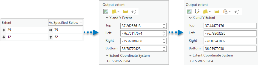

The processing extent control from ArcGIS Pro 1.0 to 3.3
The extent control in ArcGIS Pro 1.0 - 3.1 (left), 3.2 (middle) and 3.3 (right).

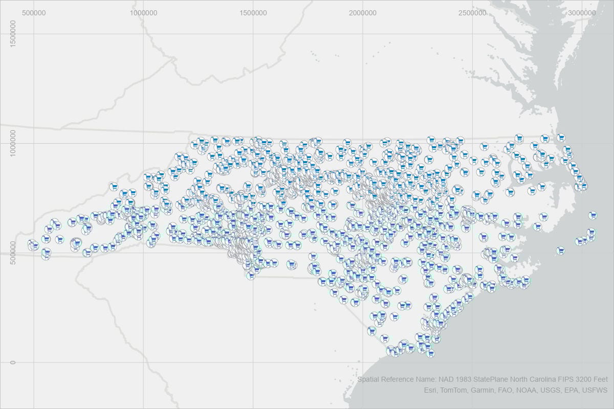

Using the point locations of grocery stores in North Carolina, find the distance to a store within a specified area.
Grocery stores in NC
Grocery stores in North Carolina

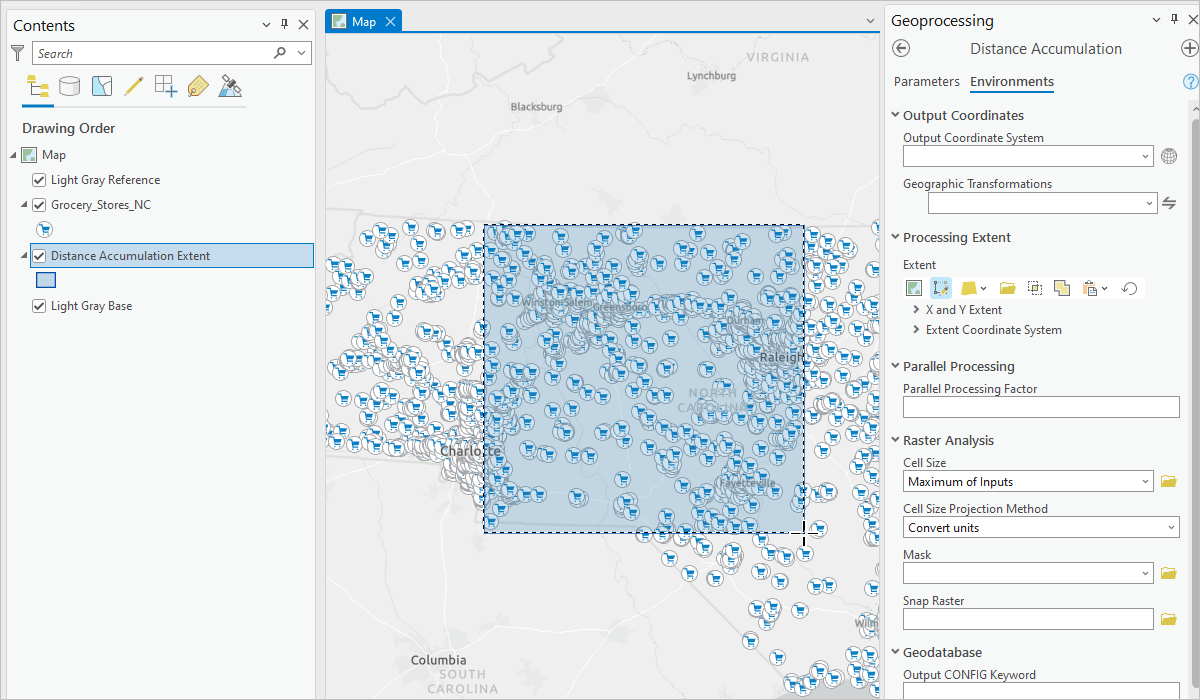

Draw Exent
Use Draw Extent Draw Extent to interactively draw a rectangle on the map around your area of interest.
Clicking Draw Extent Draw Extent adds a new layer to the map and creates a feature class in your default geodatabase to store the extent you will draw. An edit session will start, and a rectangle drawing tool will activate. Click on the map to place the first corner of the extent rectangle, then a second click will complete the drawing and automatically save the edits. Since the drawn extent is saved in your default geodatabase, you can close your project and still be able access the same extent or use it in other projects.
Note: The feature class name may not match the new layer name. Refer to the layer properties to determine the feature class name and location.
Draw Extent example
Sketch an extent using the Draw Extent option
Tip: When the drawing tool is active, you can right-click on the map to see more options! Including the options to specify the absolute X, Y, and Z values, the length and width of the rectangle, or finish or cancel your drawing.

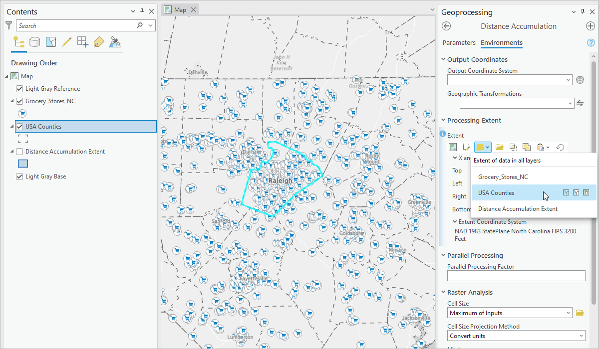

Extent of a Layer
If you would like to focus on a specific location, such as a county or census tract, you could choose a layer from the Extent of a Layer  menu  Layer. New in ArcGIS Pro 3.3, you can now choose between 3 different options on each layer to get the extent from the following:
  • All Features of a layer.
  • Selected Features of a layer.
  • Visible Features  of a layer.
Get the extent from a layer
Choose between 3 new options to get the extent from a layer.
Note: When using visible or selected features of a layer, the extent will still be a rectangular bounding box. It will not be an irregular polygon shape that matches the exact geometry of the features.

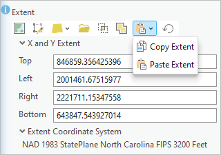

Clipboard
The processing extent control now has a Clipboard menu  clipboard  that you can use to copy or paste the X and Y Extent and the Extent Coordinate System to your clipboard.
Clipboard menu
Use the Clipboard menu to copy or paste the coordinates and coordinate system
The copied and pasted extents use the same formatting as the ArcPy Extent object: {XMin} {YMin} {XMax} {YMax} {spatial_reference}. Making it easy to copy and paste between the geoprocessing tool UI and a Python script!
For example, copy the following X and Y Extent for Wake County, NC with the Extent Coordinate System set to NAD 1983 State Plane North Carolina and paste it in the extent control:
2001461.67515977 643847.543927014 2221711.15347558 846859.356425396 PROJCS[“NAD_1983_StatePlane_North_Carolina_FIPS_3200_Feet”,GEOGCS[“GCS_North_American_1983”,DATUM[“D_North_American_1983”, SPHEROID[“GRS_1980”,6378137.0,298.257222101]],PRIMEM[“Greenwich”,0.0],UNIT[“Degree”,0.0174532925199433]], PROJECTION[“Lambert_Conformal_Conic”],  PARAMETER[“False_Easting”,2000000.002616666],PARAMETER[“False_Northing”,0.0],PARAMETER[“Central_Meridian”,-79.0],PARAMETER[“Standard_Parallel_1”,34.33333333333334], PARAMETER[“Standard_Parallel_2”,36.16666666666666],PARAMETER[“Latitude_Of_Origin”,33.75],UNIT[“Foot_US”,0.3048006096012192]]

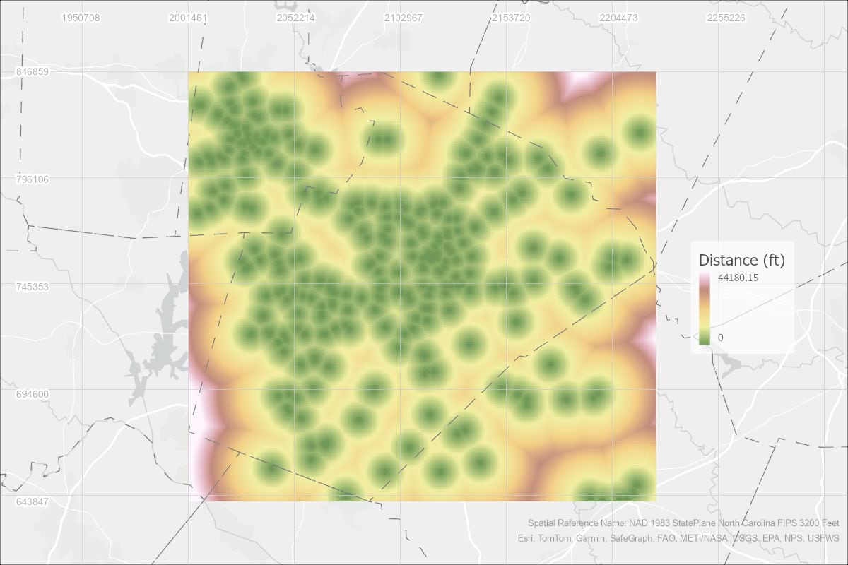

Result
Run the tool using the pasted extent.
The output is a raster dataset of the distance (in feet) from each grocery store within the specified extent.
output raster
The output raster for the Distance Accumulation tool
Note: The processing extent is always a rectangular area. You can use the Mask (Environment setting) if you would like the output to contain only the cells that fall within the county boundary.
