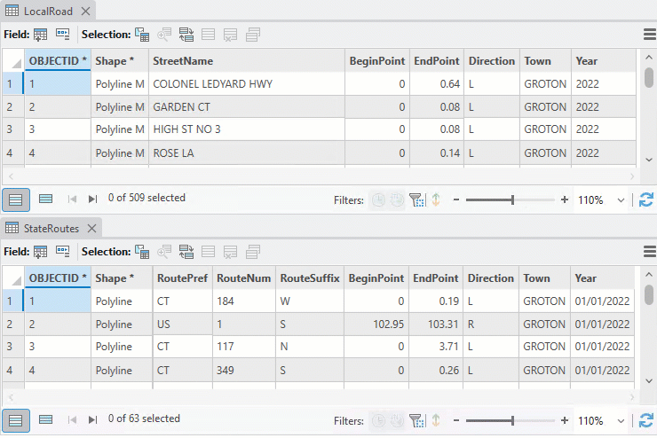

Below are the attribute tables for a LocalRoads and StateRoutes dataset.
Notice how the fields differ between the two datasets? The StateRoutes dataset has three fields for the road name, and the year field is formatted differently in each dataset.

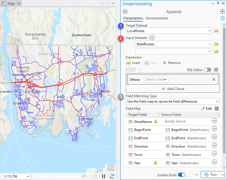

Using the Append tool, specify the following parameters to load the line features from the StateRoutes dataset to the LocalRoads dataset:
  1. Target Dataset: LocalRoads
  2. Input Datasets: SateRoutes
  3. Field Matching Type: Use the field map to reconcile field differences
    This activates the field map parameter, where two target fields have a warning: StreetName and Year.
Append tool with steps

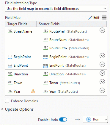

The StreetName field has a warning because there’s no matching field with the same name in the StateRoutes dataset. To map source fields to the StreetName field:
  1. Click the first drop-down under the Source Fields
  2. Check the RoutePref, RouteNum and RouteSuffix field boxes in the menu.
  3. Set the Action to Concatenate, and use a dash (–) as the delimiter.
    This step is necessary to combine multiple source fields into one target field. If the default action (First) is used, only the first listed field would get written to StreetName.
  4. Click OK to add three source fields to the StreetName target field.
  5. The route prefix should appear first, so drag RoutePref above RouteNum.
Field mapping with steps
The Year target field is already matched. So, why does it have a warning?
Hover the Year field’s warning: The field length is shorter than the source fields. This message appears on text fields when the target field length is shorter than the source field length. In this example, the Year target field length is 4 whereas the source field length is 10. Attempting to load values that do not fit into a target field can cause a big problem when running Append!

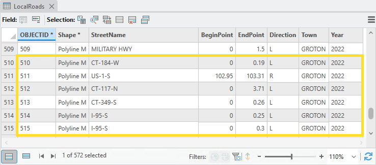

Now that all field differences have been reconciled, run the Append tool.
Result: The target dataset, LocalRoads, should update from 509 to 572 total line-features.
Appended records
Appended records in the Target dataset
