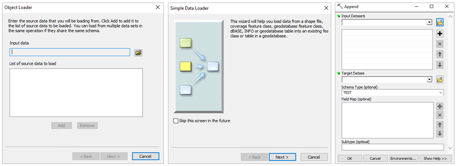

ArcMap includes 3 ways to load data into an existing feature class or table:
  • Object Loader
  • Simple Data Loader
  • Append tool
Load new records using these 3 options in ArcMap
The Object Loader, Simple Data Loader, and Append tool in ArcMap
You may have noticed only one of these options available in ArcGIS Pro: the Append tool.

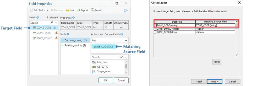

Append VS Object Loader

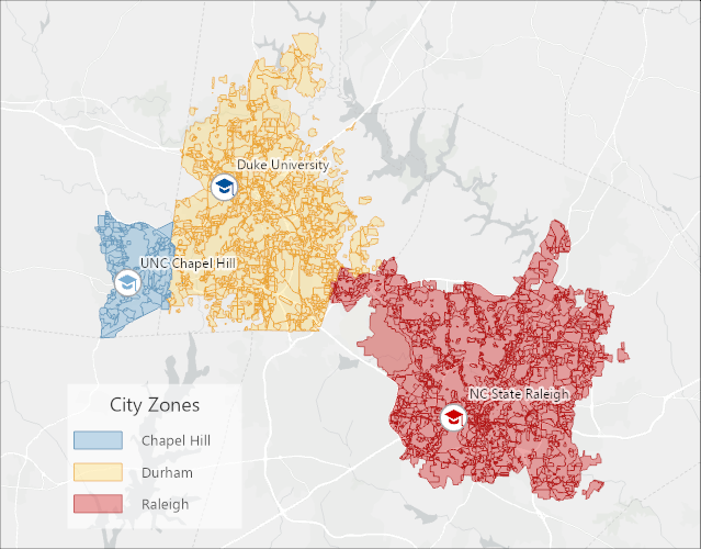

This example demonstrates how to load 2 zoning datasets for the cities of Raleigh and Durham into the Chapel Hill dataset.
These cities make up the “Research Triangle” of North Carolina, which gets its name from the 3 universities: Duke, UNC, and NC State.
Example datasets
City Zones
All three zoning datasets have 3 fields that contain the following information: Zone Code, Description, and Date. But the attributes for each city have differing schema. Meaning attributes that represent the same data may have a different field name, alias, field type, domains, etc.

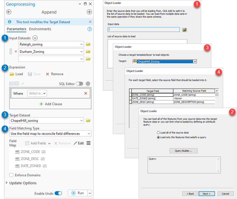

Open the Append tool and set the following parameters:
Append
How to use the Append tool
  1. Target Dataset: ChapelHill
  2. Input Datasets: Raleigh ; Durham
    Recall the Simple Data Loader and Object Loader require all inputs to have matching schema.

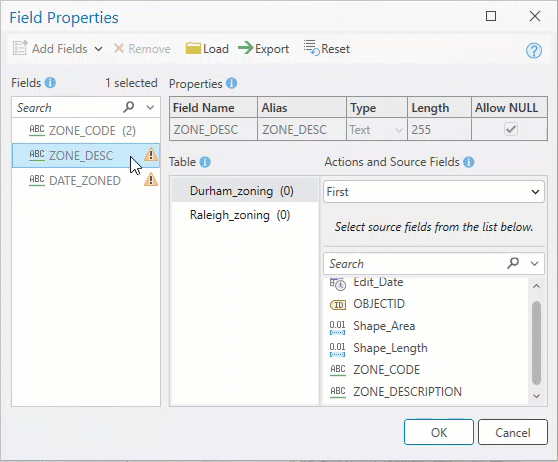

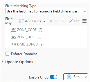

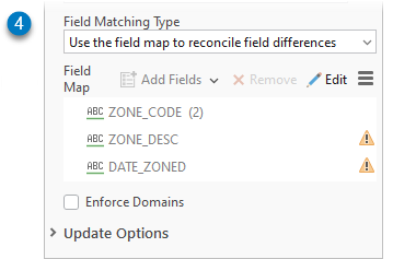

  3. Field Matching Type: Use the field map to reconcile field differences
    This option activates the field map which you can use to match fields, perform simple calculations, or concatenate field values.
Field matching
Field matching using the Field Properties window
Fields with matching schema will match automatically. The warning beside the DESCRIPTION field means that no match was found. Unlike the ArcMap loaders, you can use the Append tool field map to match source fields with different schemas. To match fields, you can work directly in the tool dialog or click Edit for a more detailed view of the target fields and actions in the Field Properties window. For the unmatched target fields, use the Source Fields drop-down to select the matching input fields.

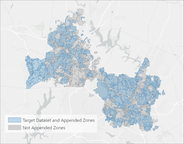

Result: The residential areas for the Durham and Raleigh datasets are appended to the ChapelHill dataset.
Result
The Chapel Hill zoning dataset with the appended residential zones.
After you run the tool, you can use the Pending Edits banner at the top of the Append tool to review, save, or discard your edits.
