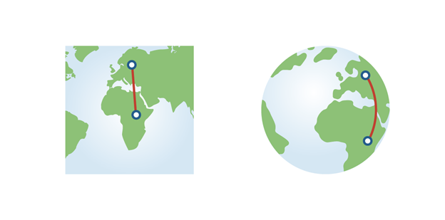

Planar distance is a distance between locations that is calculated in a 2D Cartesian coordinate system. While these projected coordinate systems do account for Earth’s curvature, they are limited. When projecting the Earth from 3D to a 2D representation, it is impossible to preserve distance, area, direction, and shape all at once. Each projected coordinate system is designed to preserve one or two of those at the expense of the others. Between the 2D representation and the inability to preserve all elements, planar distances are always inaccurate.
Geodesic distance, on the other hand, is the distance between two points connected along the curved surface of the world. It is calculated in a 3D spherical space rather than on a 2D plane. This is done using a geoid to approximate the curvature of Earth’s surface in calculations. A geoid is an irregularly shaped ellipsoid that approximates geographic formations that make up the Earth’s surface. Compared to Earth’s actual physical surface, the geoid is still considerably smoother but accounting for the Earth’s curvature through such an approximation is more accurate than a 2D representation of it.
Planar vs. geodesic distance
Comparison of the conceptual difference between planar and geodesic distance.

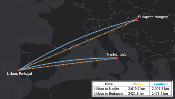

To highlight the difference between geodesic and planar distance, we can calculate and compare the distance between Lisbon, Portugal, and Naples, Italy, using a Web Mercator projection. We can see that the planar distance is significantly overestimating this distance. The geodesic result is just over 600 kilometers shorter than the planar distance, which equates to a 30 percent difference. If we choose locations even farther apart, such as Lisbon and Budapest, Hungary, that difference increases to about 950 kilometers which is about a 40 percent difference.
Web Mercator example
Optimal paths between Lisbon, Portugal, and Naples, Italy, as well as Lisbon, Portugal, and Budapest, Hungary. The projection is Web Mercator.

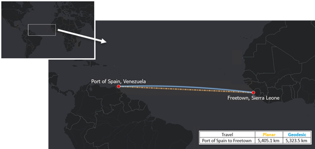

As another example, we can compare the Euclidean distance between Port of Spain, Venezuela, and Freetown, Sierra Leone, using a map projection more suitable for distance calculations in this area, the WGS 1984 Equidistant Cylindrical (standard parallel=0) projection. This projection preserves distance near the equator and is a choice suitable for this use case. While the total distance between the two cities is much larger than in the previous example, the planar calculation is only distorted by 1.5 percent.
WGS 1984 Equidistant Cylindrical (standard parallel=0) example
Optimal path between Port of Spain, Venezuela in South America, and Freetown, Sierra Leone in Africa. The projection is WGS 1984 Equidistant Cylindrical (standard parallel=0).
While selectively choosing a more suitable projection can give us a better answer, we still see there is a noticeable difference of 80 kilometers between the two calculation methods. Depending on your application, this error can have downstream consequences if the limitations of the planar calculations are not understood.
