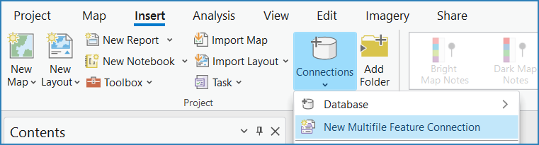

Insert tab in ArcGIS Pro

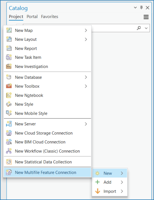

  • In the Catalog pane (or Catalog view), right-click and select New, then choose New Multifile Feature Connection
Add MFC by right-clicking inside the catalog pane

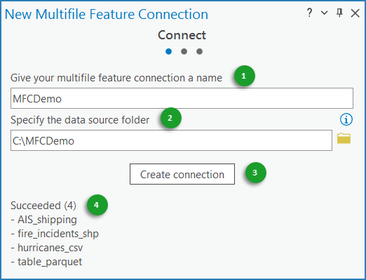

Step 2: Name your multifile feature connection (1); specify the data source folder (2); click Create connection (3); a list of the successfully connected data sources will appear below (4):
New Multifile Feature Connection pane

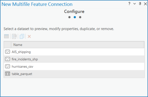

Step 3: The dialog box will prompt you to configure your multifile feature connection datasets. Here you’ll notice that the datasets maybe have geometry enabled immediately. For example, AIS_shipping, composed of 3 .csv files contained in the AIS_shipping subfolder, shows it has a point geometry point_icon. This is because when you create the connection, the tool automatically detects field names that may contain geometry or time information and sets those properties for you! So easy.
New multifile feature connection pane configure panel
In the Configure panel, you can choose the following actions for your dataset: previewing your data, editing a dataset’s properties, and duplicating or removing a dataset. For example, you could set geometry or time properties for your dataset without needing to calculate new fields or add a filter to turn your full dataset into an actionable subset.

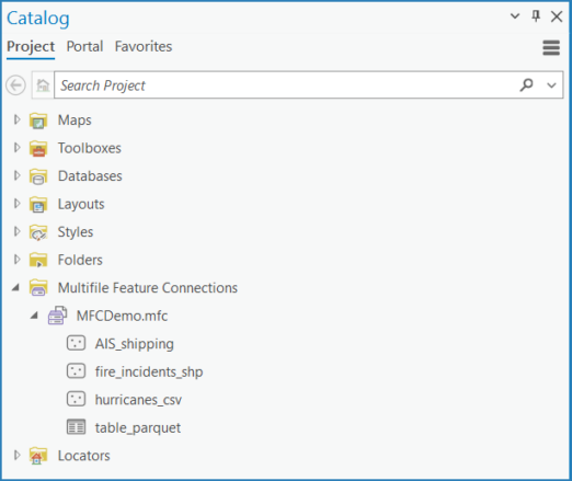

A multifile feature connection (.mfc) with four feature classes will appear in its own project container in the Catalog pane.
Recall: In the source folder, MFCDemo, there are four folders, each representing a dataset. In the .mfc file, each dataset became a new feature class or table within the MFC.
Catalog pane with MFC project container

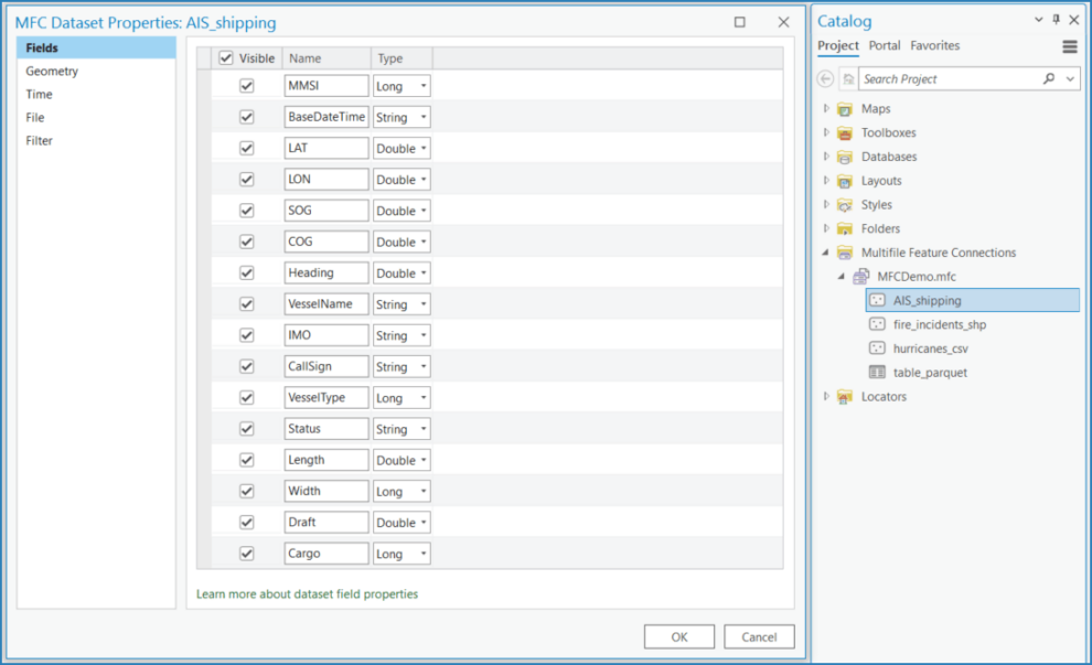

In previous releases, you would have had to either set properties simultaneously as connecting or use a geoprocessing tool to update them. Now in 3.0, we’re excited to say you can continue to configure your MFC datasets after they are created using the properties page:
  • Right-click the multifile feature connection in the Catalog pane and choose Properties.
    This opens the same properties pane found in the New Multifile Feature Connection dialog, and can be accessed anytime.
Properties dialogue box for the AIS_shipping dataset
Properties dialogue box for the AIS_shipping dataset.
