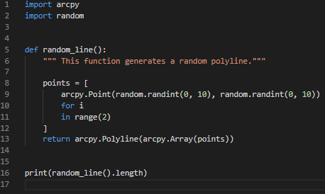

Both flake8 and black help you format your code according to PEP-8. Take the example script below (if you want to follow along, save it to a local Python file like my_script.py):
The quickest way to see linting and autoformatting in action is to open the Python Command Prompt and enter the following commands (make sure that arcgispro-py3 is your active environment and you have ArcGIS Pro 2.7 or later installed):
flake8 C:\Path\To\Your\my_script.py
Note that you’ll need to substitute your own path. You’ll see that programming and style errors will be printed below the flake8 command along with details on their location in the script. If you have the script open, you’ll note that the code hasn’t been changed. Now try running black:
black C:\Path\To\Your\my_script.py
You’ll see that after running black, your code has been reformatted to correct the styling. Try running the flake8 command again to see how many of the flagged formatting errors have been taken care of. Some of the remaining items are flags for unconventional programming practices, but some may still be formatting errors that black thinks you should fix yourself. Can you remove all of them?
