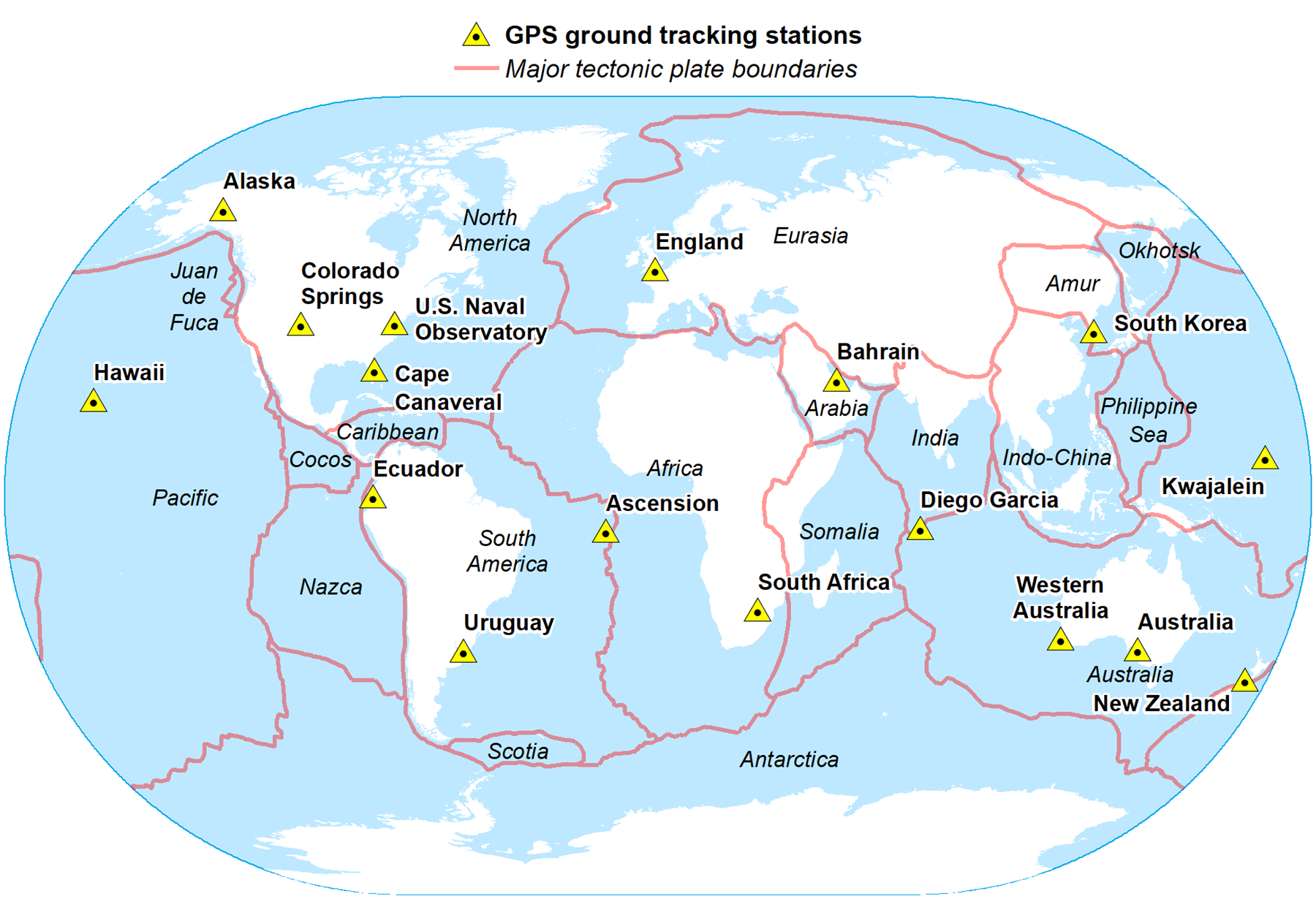

A widely used TRS/TRF is WGS 84. WGS 84 is a reference system that becomes tied to the real Earth by using the measured coordinates of 17 Global Positioning System (GPS) tracking stations around the world. When WGS 84 is anchored this way, it becomes a realization, known as the WGS 84 terrestrial reference frame (TRF).
Ground tracking network for the U.S. GPS satellite navigation system.

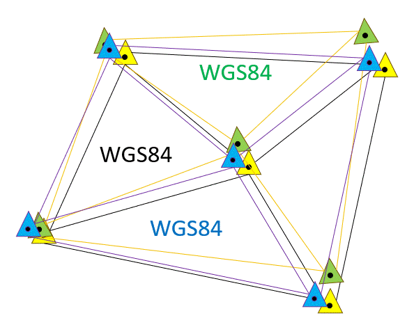

As technology improves with better instruments, better processing methods, and more tracking stations, we can create more accurate realizations (or versions) of a reference system. For WGS 84, there have been eight different realizations so far. Each realization is tagged with a “G‑number,” which refers to the GPS week during which satellite observations were collected to define that version (e.g. the current realization of WGS 84 is WGS 84 (G2296)).
Even though the WGS 84 TRS (the abstract definition) stays the same, each new realization becomes a slightly updated WGS 84 TRF, with small differences in coordinates. The underlying reason for this is that WGS 84 is a dynamic datum, meaning that coordinates change slightly over time – something we can dive into in another blog post!
Because all eight slightly different realizations of WGS 84 are closely related and based on the same TRS, they together represent the WGS 84 datum ensemble. As new data and better technology become available, we can expect more updated WGS 84 realizations in the future.
