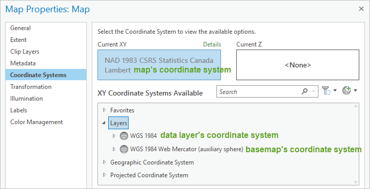

Map Properties Coordinate System window
Projection on the fly ensures that the data draws in the map’s coordinate system (NAD 1983 CSRS Statistics Canada Lambert), even though it is still stored in two other coordinate systems (WGS 1984 and WGS 1984 Web Mercator).

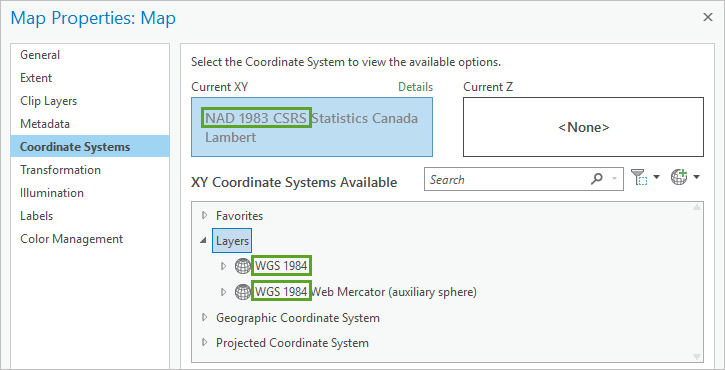

In the example above, the map is in a projected coordinate system (PCS). But keep in mind that every PCS contains a GCS as part of its definition. The GCS used by this map is NAD 1983 CSRS.
Geographic coordinate systems highlighted in the Map Properties Coordinate Systems window
Both coordinate systems used by the data layers have the same GCS: WGS 1984. Because WGS 1984 and NAD 1983 CSRS are not the same, this map needs a transformation.

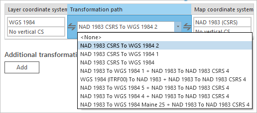

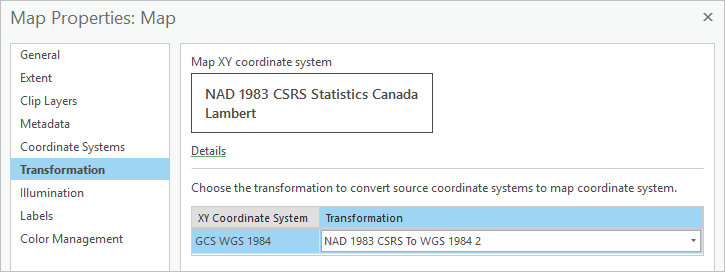

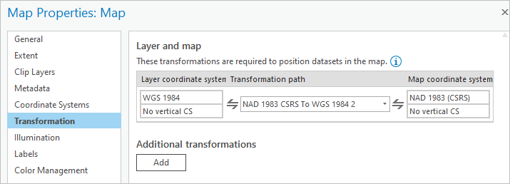

You can choose which transformations to use! In Map Properties, on the Transformation tab, you can see the transformations your map is currently using for projection on the fly.
Transformations in the Map Properties window
In this example, the transformation NAD 1983 CSRS To WGS 1984 2 is used. (The order specified in the name doesn’t matter. Transformations work in either direction.)

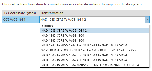

Sometimes there are a lot of transformations to choose from. Be warned that choosing <None> will likely cause your data to draw in the wrong place.
List of available transformations
The good news is that if you don’t know which one to choose, you can just pick the first one. They are ordered based on extent and accuracy. The transformation that covers the most of your data’s extent will be first on the list.
The bad news is that the recommended order can vary with the location and extent of your data. Government-sanctioned transformations may not show at the top of the list. Furthermore, new transformations are frequently added to the list. All these factors introduce possible inconsistencies. Sometimes there may not be any transformations available.

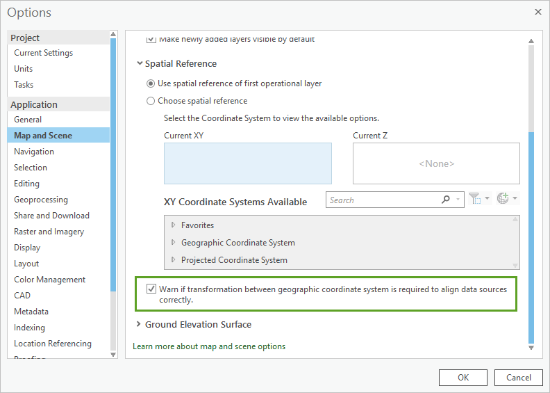

Want ArcGIS Pro to warn you when you’re using a transformation, like ArcMap does?
  • Go to the Project tab > Options > Map and Scene > Spatial Reference and check the box for Warn if transformation between geographic coordinate system is required to align data sources correctly.
