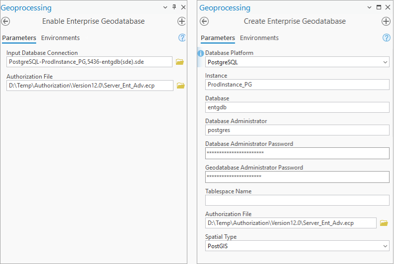

Geoprocessing tools to create a geodatabase in ArcGIS Pro
| Tool | When to use it | What it does | Deployment options | Key requirements |
Enable Enterprise Geodatabase |
Use when the database already exists. Common when DBA and geodatabase admin responsibilities are separated, and typical in DBaaS workflows. | Creates geodatabase system tables, views, functions, and procedures in the existing sde schema. |
Self-managed and DBaaS |
Requires an existing database, an sde login with required privileges, an sde schema, and a saved database connection as sde. |
Create Enterprise Geodatabase |
Use when you want ArcGIS to create the PostgreSQL database and geodatabase components for you. Common when the same person is both PostgreSQL admin and geodatabase admin. | Creates the database, creates or uses the sde login, creates the sde schema, and creates the geodatabase. |
Self-managed only |
Requires PostgreSQL superuser credentials (typically postgres). |
Note: Obtain the ArcGIS Server keycodes file and place it in a location accessible from the ArcGIS client machine you will use to enable or create the geodatabase.
This distinction is important: you do not always need to create the PostgreSQL database manually first. If you use the Create Enterprise Geodatabase tool, ArcGIS can create the database using PostgreSQL’s default template unless you choose to pre-create it.
If you need a different database template, or your administration model separates database administration from geodatabase administration, create the database first and then use the appropriate workflow.

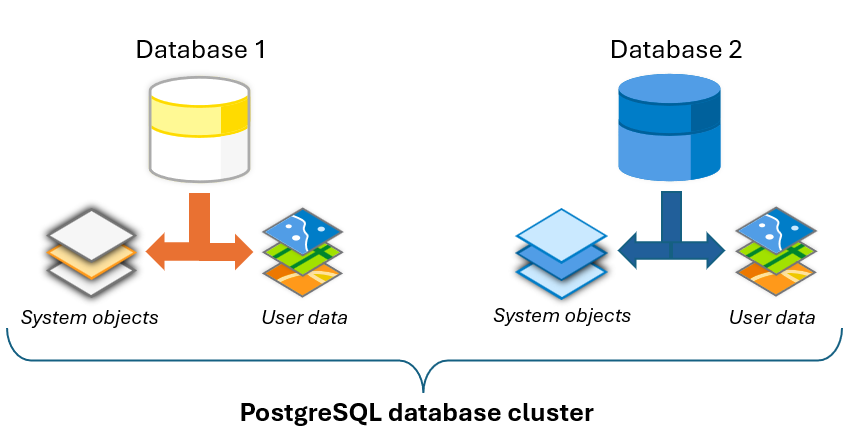

What creating or enabling a geodatabase does
Whether you use the Enable Enterprise Geodatabase or Create Enterprise Geodatabase tool, ArcGIS creates the system objects required for geodatabase behavior.
These include geodatabase system tables, views, functions, and procedures, primarily in the sde schema. In PostgreSQL, one geodatabase system table is also created in the public schema, which is why the public schema must exist when enabling a geodatabase in an existing database.

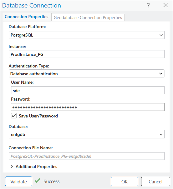

Connect to your geodatabase in ArcGIS Pro
Once the geodatabase exists, connect to it from ArcGIS Pro.
To create a database connection file in ArcGIS Pro:
- Open the Catalog pane.
- Right-click Databases or a folder under Folders, and click New Database Connection.
- Choose PostgreSQL from the Database Platform list.
- In Instance, provide the database cluster name, host name, or IP address.
- Choose the authentication type.
- Specify the database name.
- Provide the connection file name.
- If PostgreSQL uses a nondefault port, expand Additional Properties, choose Port, and enter the port number.
- Click Validate.
- Click OK.
