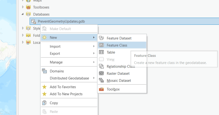

  • Create a new point feature class on the project file geodatabase

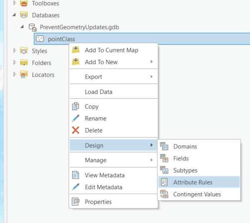

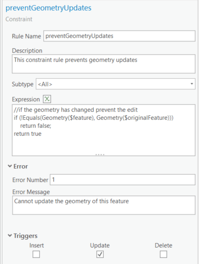

  • Add a constraint attribute rule that triggers on update to your class with the following script
//if the geometry has changed prevent the edit
if (!Equals(Geometry($feature), Geometry($originalFeature)))
       return false;
return true

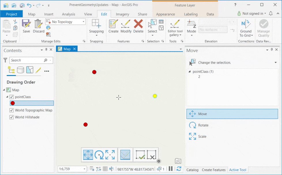

Finally save your attribute rule and test, you can see that you can edit attributes on features but not the geometry.
