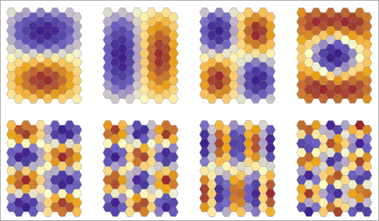

Spatial components are constructed by decomposing a spatial neighborhood (also called a conceptualization of spatial relationships) into a series of components that represent various possible spatial patterns of spatial variables. The first several components usually represent broad spatial trends (such as east-west or north-south trend), and later components represent more local patterns.  The following image shows various spatial components of a hexagonal tessellation:
Spatial components of a hexagonal tessellation
Various spatial components for a hexagonal tessellation are shown.
