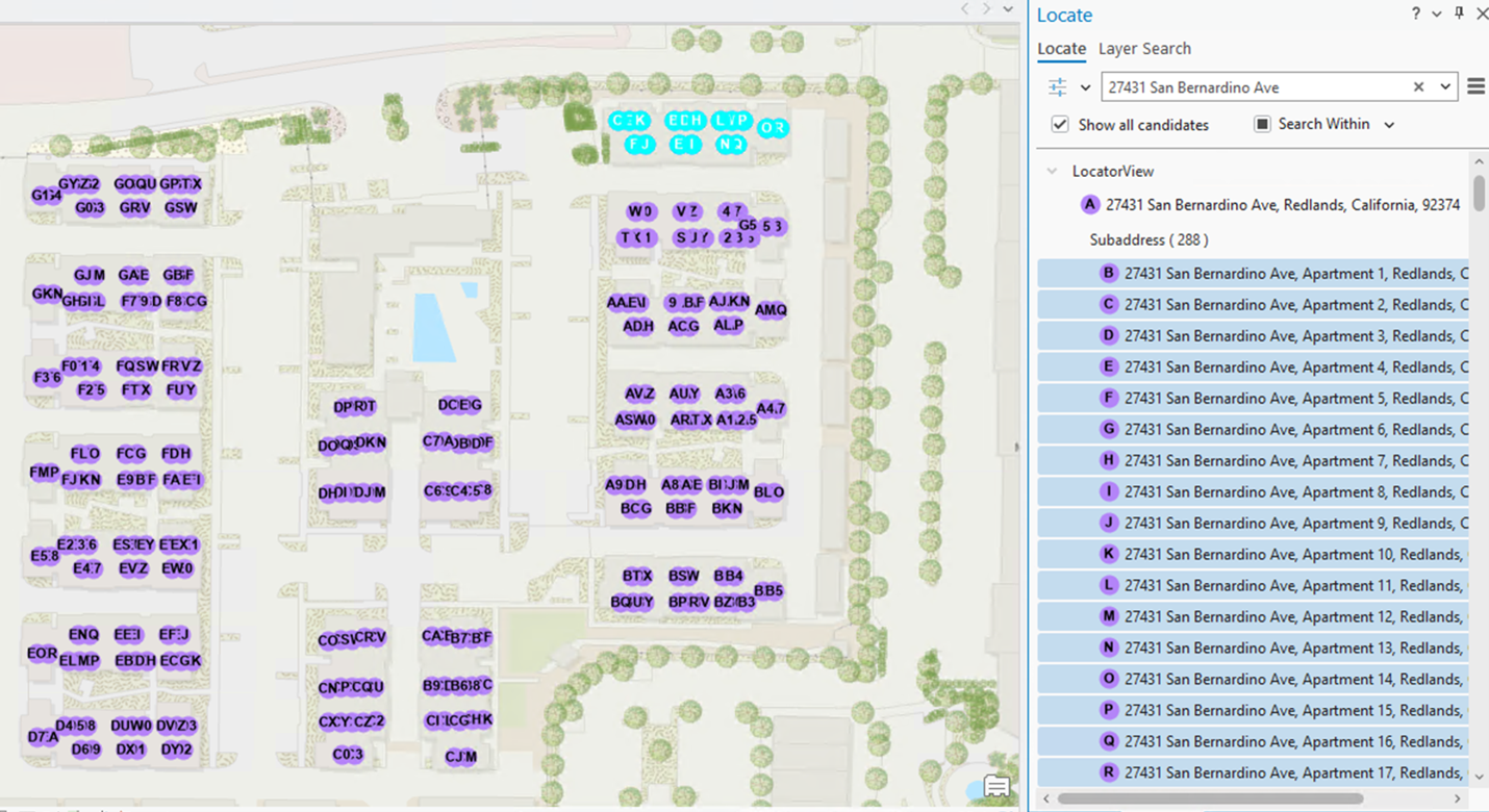

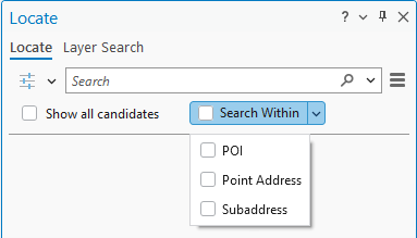

Searching for specific address types: The “Search Within” button on the Locate Pane lets you pick the type of address to search for. Whether it’s Points of Interest (POI), building numbers (point address) or apartments (Subaddress), the Locate Pane will generate a list of records associated to an address. The dispatcher will see all of the units in a building, or businesses at an address, and help the caller confirm where resources need to be deployed.
Search Within property on Locate pane.

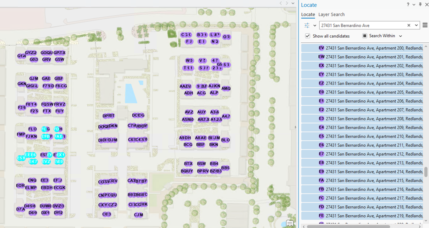

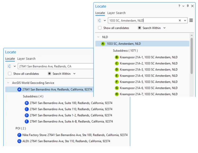

Reviewing a long list of addresses: If the caller is in a building with a lot of units, the dispatcher may see a long list. To assist with this, the Locate Pane sorts the matches based on their type: address, subaddress, or POI, and provide an indicator of the number of matches. Further, the Locate pane will show the first 50 candidates, and as you scroll in the pane, they will see more candidates listed. The map display will update to highlight the current list of candidates in the Locate Pane. The Locate Pane provides further insight through the address summary.
Dynamic selection of associated features returned for an address. This is what a dispatcher would see when they get an address match.

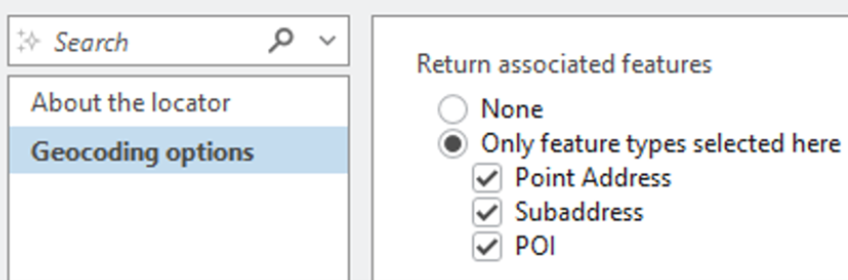

Activate SearchWithin: If you are a GIS analyst building your own Locator, the Return associated features setting enables the SearchWithin button on the Locate Pane. This setting gives you control into what a dispatcher will see in their match results.
Locator properties setting for Return Associated features.
For more information, see Locate features associated with an address

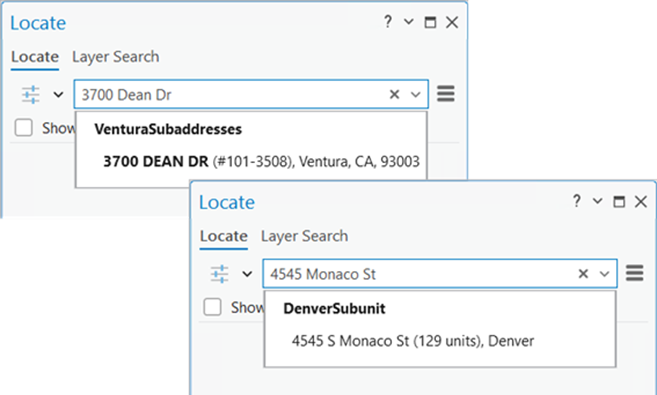

Viewing a summary: When a first responder asks the dispatcher for more information about the destination, the dispatcher can quickly see an indicator of how many units are at the destination.
Indicator of units associated features with an address.

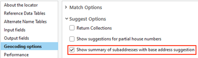

Enable summaries: Activating the Show summary of subaddresses with base address suggestion setting provides an indication of the subaddresses at an address.
Locator properties setting for Show summary of subaddreses with base address suggestion.

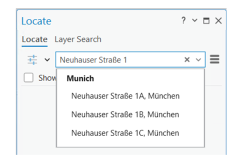

Working with a partial input: When a caller is unable to provide the full house number, a Dispatcher needs to see a list of addresses that start with one number. Note: This option only applies for countries where the house number follows the street name.
House numbers associated with a base address input.

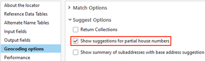

Search with a partial input: Electing to use the Show Suggestions for partial house numbers setting will allow users to see suggestions when the input address is partially complete.
Locator properties setting for Show suggestions for partial house numbers.

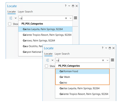

Search by category: Sometimes a caller is uncertain of the name of the business, but they know it is a specific type of business like a restaurant. The Return Collections setting allows the dispatcher to see suggestions based on POI categories. The examples below illustrate the list of restaurant names when the setting is off, and a list of business categories when it is turned on.
Search results by POI category.

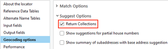

Search for POI features: Enabling the Return Collections setting allows user to search for features by category.
The locator properties setting for Return Collections.

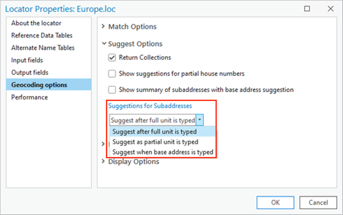

Configuring subaddress suggestions: Control over the type-ahead experience is managed by the Suggestions for Subaddresses setting. Due to the urgency required for dispatchers, the presentation of subaddress suggestions can help them to route first responders with more specific details.
The locator properties setting for Suggestions for Subaddresses.
