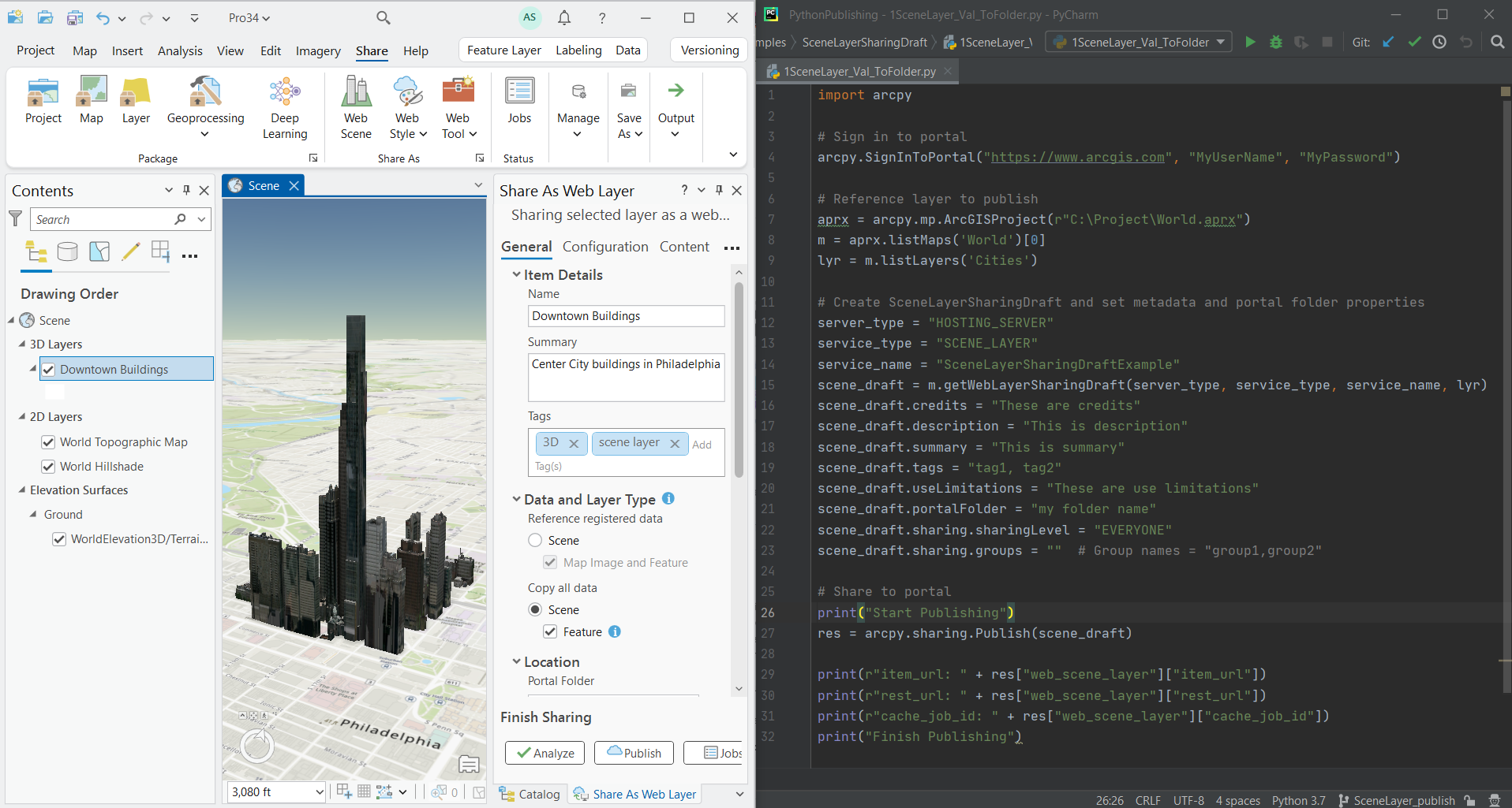

With the SceneLayerSharingDraft class, you can use Python to share scene layers in your ArcGIS Pro project as web scene layers with associated web layers to a portal.
Here’s how it works…
Like other sharing classes such as FeatureSharingDraft and MapImageSharingDraft, the SceneLayerSharingDraft is created using the Map object’s getWebLayerSharingDraft method:
getWebLayerSharingDraft (server_type, service_type, service_name, {layers_and_tables})
To create a sharing draft for a web scene layer, specify the following parameters:
  • server_type—Set HOSTING_SERVER if you want the web scene layer to copy all data; an associated web feature layer is included. Set FEDERATED_SERVER if you want the web scene layer to reference registered data; an associated map image layer and web feature layer are included.
  • service_type—Set SCENE_LAYER.
  • layers_and_tables—Reference the layer in the 3D scene in the project you want to publish using the listMaps function from the ArcGISProject object and the listLayers method on the Map class. The parameter must be a list with a single layer referencing a point, 3D object, or building scene layer.
Once the SceneLayerSharingDraft object is configured, you can set service level properties on the web scene layer and associated web layers. For example, you can configure cached attributes and enable texture optimization on the web scene layer. You can also configure editing, synchronization, and querying capabilities on the associated web feature layer. For a complete list of configurable properties, see Properties.
Next, you can optionally use the new analyzeForSharing method to analyze the SceneLayerSharingDraft object and review any errors, warnings, and messages.
Finally, publish the web scene layer and any associated web layers using the Publish function:
