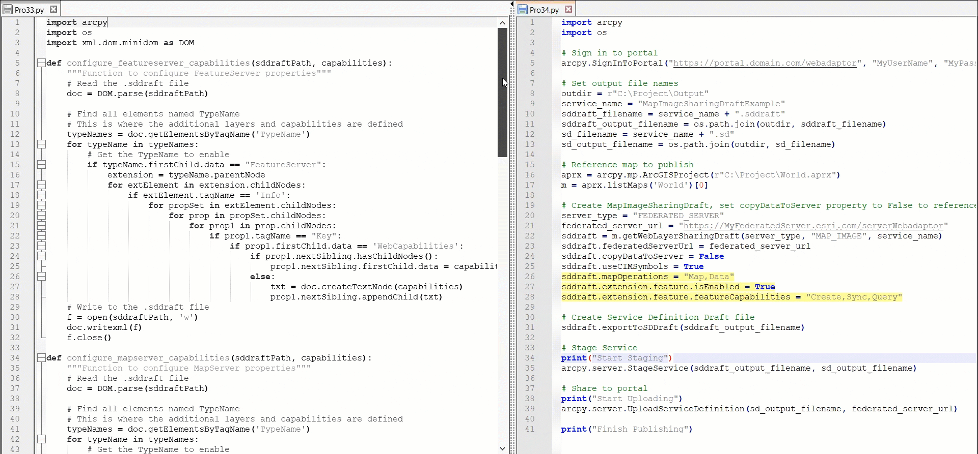

Previously, these sharing drafts only contained the most common web layer or service properties. To configure settings such as time zone, pooling type, and WFS, you probably modified the service definition draft file (.sddraft) using third-party XML editors or XML Python libraries. Now, you no longer need to modify the .sddraft file to configure these settings. Instead, simply set the desired property on the sharing draft object.
In the example below, extensive code in ArcGIS Pro 3.3 (left) modifies the .sddraft file to set map operations, include an associated feature layer, and enable feature capabilities for a map image layer. You can now set the same properties with three simple lines of code in ArcGIS Pro 3.4 (right).
Comparison of code to set properties in ArcGIS Pro 3.3 (left) and ArcGIS Pro 3.4 (right). Extensive code in 3.3 to set map operations, include a feature layer, and enable feature capabilities, contrasted with three simple lines of code in 3.4 achieving the same tasks.

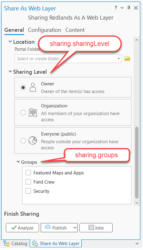

sharing.sharingLevel
sharing.groups
The sharing level of the web layer:
  • OWNER
  • ORGANIZATION
  • EVERYONE
The group names, separated by commas.
Sharing level settings

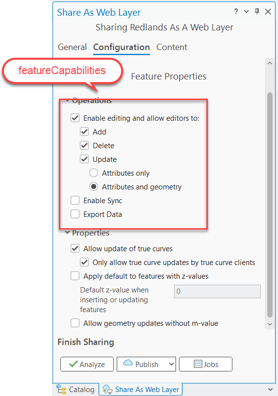

featureCapabilities
The enabled capabilities, separated by commas. The following capabilities are supported:
  • Query
  • Create
  • Update
  • Delete
  • Sync
  • Extract
  • Editing

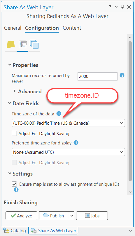

timezone.ID
The time zone in which date values are stored. The string value must match one of the official time zone IDs recognized by the Windows operating system. For a list of time zones, see Time zones in the Microsoft documentation. Embedded Image

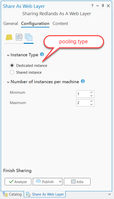

pooling.type
The type of instance pooling that will be used.
  • SHARED
  • DEDICATED
Embedded Image
