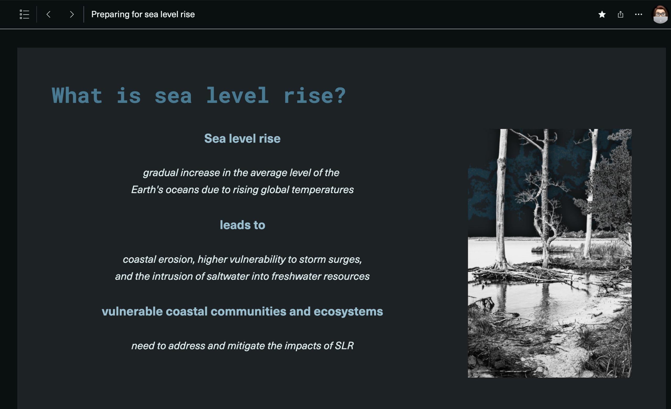

This slide includes text and an image added directly to the briefing.

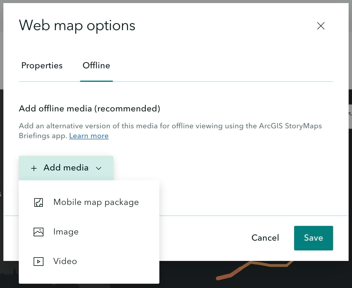

  • Web Maps and Web Scenes: For offline interactivity, upload mobile map packages (.mmpk) or mobile scene packages (.mspk). These are designed in ArcGIS Pro and maintain a consistent look and feel with online versions, constrained only by the included layers and basemaps. Offline support includes functionalities like search locators, bookmarks, legends, and pop-ups, which are configured at the time the mobile map or scene package is created. Mobile map and scene packages need to be added as an ArcGIS content item and shared appropriately before they can be selected as an alternative media option in the briefing. For additional information on this workflow, refer to these documentation links: Create mobile map package, Create mobile scene package, and Share a mobile map package. If an image or video replaces a map or scene, it will appear on the briefing slide.

Screenshot of web map options showing that a map package, image, or video may be added as offline media

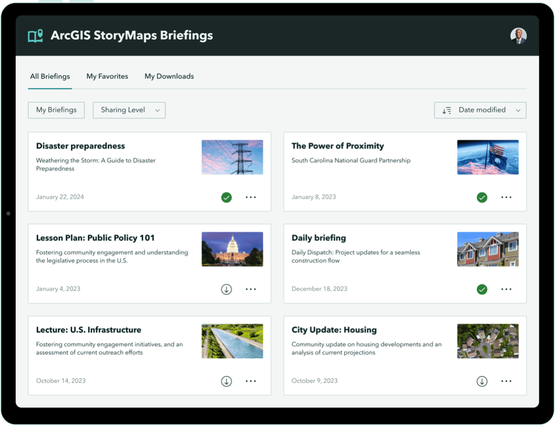

A green checkmark icon indicates briefings that have been downloaded to your device using the ArcGIS StoryMaps briefing app.
