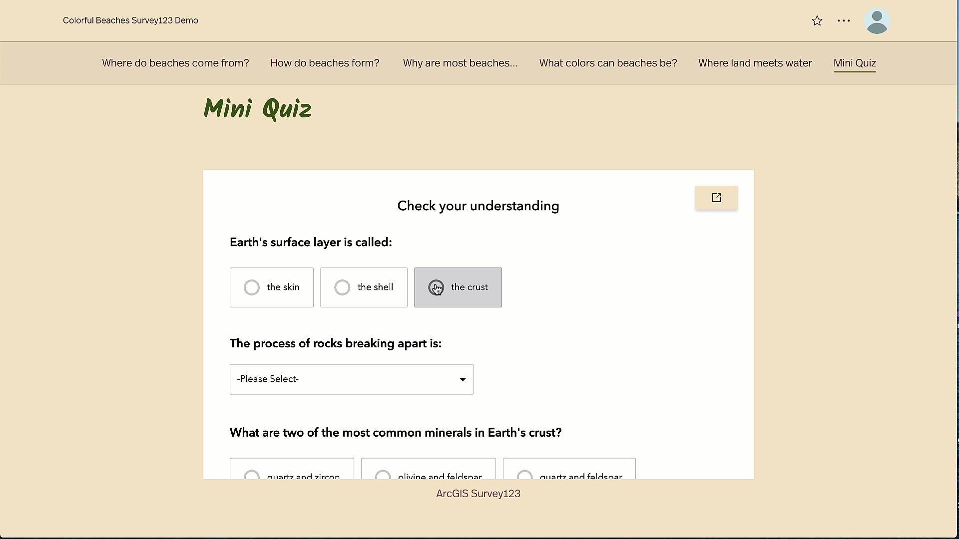

Are you one of the many educators who use ArcGIS StoryMaps as a teaching tool? If you’re using ArcGIS StoryMaps in your K-12 classroom, this article will show you how to create a self-check quiz so your students can check their content comprehension while they read the story. A new workflow using ArcGIS Survey123 makes it more convenient than ever to integrate self-assessments into your stories.
animated gif of an ArcGIS Survey123 self-check quiz embedded in an ArcGIS StoryMap
A preview of the embedded quiz within a story.
Using self-check quizzes
Self–checks are a helpful tool for both students and educators. Students can use this tool to gauge their reading comprehension and understanding of class materials. And educators can use it to assess whether the lesson is effective or if they need to make adjustments in the lesson. This is particularly useful when sharing your content asynchronously, or assigning students content to view before a discussion, for example, in a flipped classroom experience. Self-checks using this workflow may also be helpful for students who need to learn at their own pace.
Self-check in action
To get a better idea of how you can use this “knowledge check” workflow to augment reading comprehension we created a story about colorful beaches that uses an embedded Survey123. In this Colorful Beaches story we discuss weathering and erosion and how it applies to beaches, specifically, to beaches with unusual colored sand. To help students check that they comprehend the material we cover, we include a self-assessment at the end of the story. The self-check questions include links that refer the student back to the section of relevant material they should review if their answer is incorrect.

  1. Open a new ArcGIS StoryMap story and create a new Survey123 survey.
  2. Add the content you want to include a knowledge check about to your story.
  3. If you haven’t already written them, write and save your questions and responses in a separate document.
  4. Add relevant questions to your survey.
  5. Ensure the required conditional formatting is in place on the  survey questions including that the questions and responses are grouped together in the survey.
  6. Complete and publish the survey, ensuring that the survey is shared publicly.
  7. Embed the survey in the accompanying story. Publish your story.
