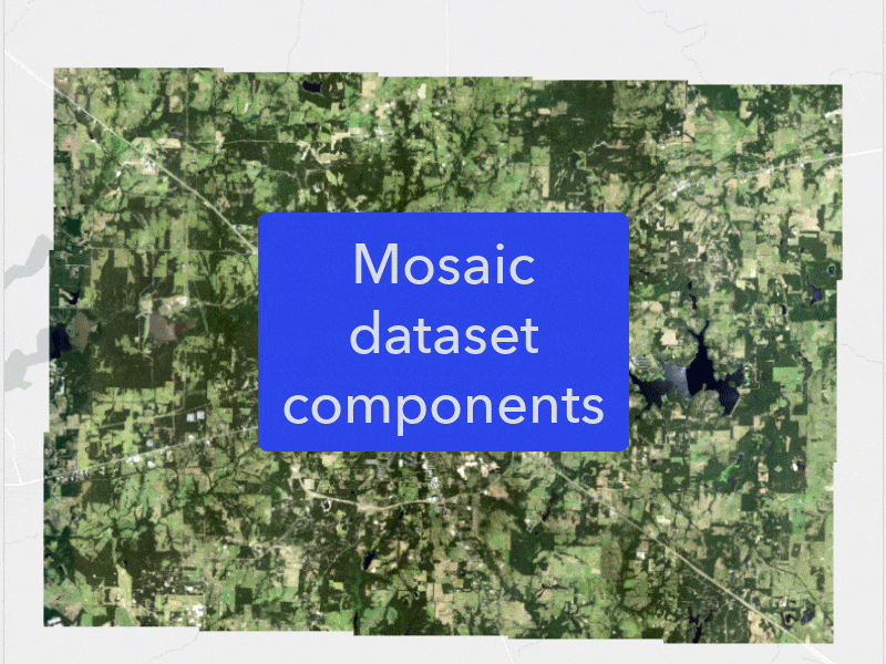

Components of a mosaic dataset
Mosaic datasets are comprised of three feature layers based on the input imagery and an image layer, rules about how those input images will be displayed, and properties of the mosaic dataset that will affect imagery extraction and mosaicking of the input images. When viewed in an ArcGIS Pro map, the two feature layer components (boundary and footprint) and the top layer of the on-the-fly mosaic (imagery layer) output will be visible by default. In the graphic below, the footprints and overviews are displayed separately, but both will appear in the same layer within the mosaic dataset.
Mosaic dataset components
Mosaic datasets have imagery layers, footprints with overviews, and boundary layers.
Imagery – The imagery layer controls the visualization of visible data within the boundary layer like a single imagery layer in ArcGIS Pro. What portion of each dataset within the mosaic dataset that is visible and controllable through the imagery layer is by a combination of the sorting, overlap resolution and mosaicking rules in addition to any other visualization processes applied to the mosaic dataset such as a time filter, using date information in the footprint, and on-the-fly processes from raster functions.
Footprint – The footprint layer contains a feature for each added input image, where the spatial extent of the image is used to create the geometry of the feature. The fields in the footprint layer provide a set of attributes that affect how the input imagery will be displayed, queried and organized. These attributes can be key metadata information such as visibility based on map scale, acquisition date for a satellite sensor, climate variable for a scientific raster dataset, and sensor type used to generate a topographic surface raster.
Overviews – Using the source images or raster data, the visual display performance of the mosaic dataset can be improved through the creation of  overviews. Overviews are pyramids or reduced-resolution versions of the mosaicked results of all the input images. The spatial extent of the individual overviews will extend beyond the spatial extent of individual input images. Overviews are generated at different levels based on the spatial extent of the mosaicked images.
Boundary – The boundary layer controls what is visible in the imagery layer when all the input images are mosaicked together, including source data and overview images. The output will be the merged output of all the footprint images. If you want to remove the visibility of certain portions of the imagery layer, modifying the geometry of the boundary file will control what areas are visible in the imagery layer.

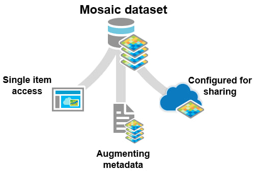

Mosaic dataset advantages
As the backbone of your imagery investment, mosaic datasets can both be a way to use imagery locally and use it to manage imagery layers that are shared. Using a mosaic dataset to organize your imagery provides a few advantages when using and maintaining your imagery. These advantages include the following:
Single item access – When added to a map in ArcGIS Pro, the mosaic dataset appears as a single item rather than all of the input images. So that when you want to use the mosaic dataset in a raster function or raster analysis tool, you can add the mosaic dataset. You can also control the visualization for the entire set of images in the Symbology pane.
Augmenting metadata – Beyond compiling, organizing, and simplifying your experience with one or more rasters, mosaic datasets also support workflows for adding more information, associating simple or complex on-the-fly preprocessing functions, serving as inputs for imagery or raster analysis tools, and even being shared to ArcGIS Online or ArcGIS Enterprise for scalable imagery visualization and analytics through the cloud.
Configured for sharing – Mosaic datasets allow you to control how overlapping imagery is used, the bit depth, number of raster bands, spatial resolution, and projection information. During the building of the mosaic dataset, you control these aspects of the mosaic dataset and can create your desired output. These defined properties will be used to define properties of the imagery layer created from the mosaic dataset. Once shared, your mosaic dataset becomes the backbone of an imagery service, providing access to the well-managed dataset created across your organization. It’s more than an organizational catalog; it’s a GIS engine fueled by your content to power your work.
Mosaic dataset advantages aid your use of imagery.
