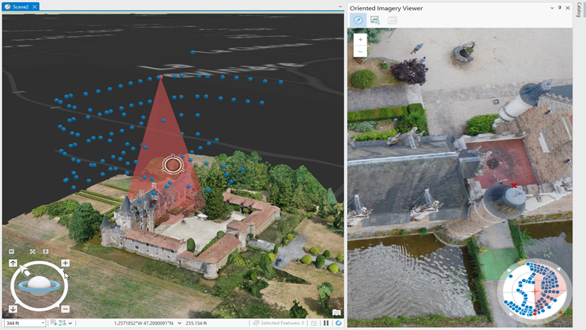

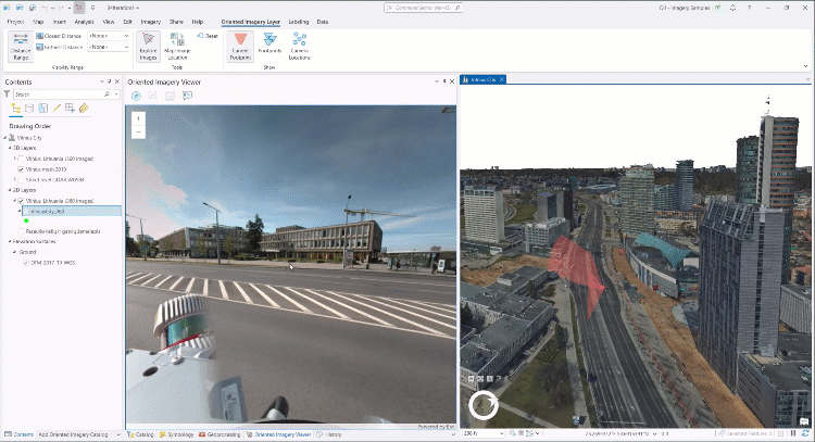

Visualize 360-degree and panoramic images
GIF of someone panning and zooming in a 360 image in the oriented imagery viewer in ArcGIS Pro, with a 3D coverage feature updating dynamically in a 3D scene showing a mesh of city buildings.
Expand the imagery modalities you can visualize in your desktop GIS to add insight and new perspectives, and improve your oriented imagery management workflow by visualizing your 360 and panoramic images in Pro before you publish your oriented imagery layer.
The 3.4 release of ArcGIS Pro supports equirectangular 360 images stored as JPEGs (the most common format). In future releases, we’ll expand 360 support to include stitched and unstitched cube maps, and to include tiled file formats like TIFF, COG, and MRF.

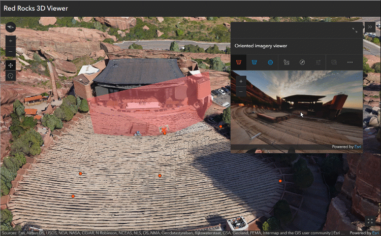

Create a 3D oriented imagery web app with ArcGIS Instant Apps
GIF showing a 3D Viewer app template built with a 3D mesh and oriented imagery layer, with the user panning and zooming in the image while a red 3D coverage feature dynamically updates on the mesh
Use the 3D Viewer template to create and share a focused 3D oriented imagery web app, so you can quickly visualize imagery from an intuitive perspective in the context of 3D data (like integrated mesh or point clouds). Stakeholders can use the app to improve situational awareness, supplement inspection workflows, and better understand the spatial relationship between images and 3D layers.
Start by adding an oriented imagery layer and relevant 3D data to a web scene, then configure a web app using the 3D Viewer template with the oriented imagery viewer widget enabled. In the app, the user can click on the web scene to view an image of that location, see the 3D viewshed of the image dynamically update in the scene as you pan and zoom in the image, and explore other images of that location from different directions.
