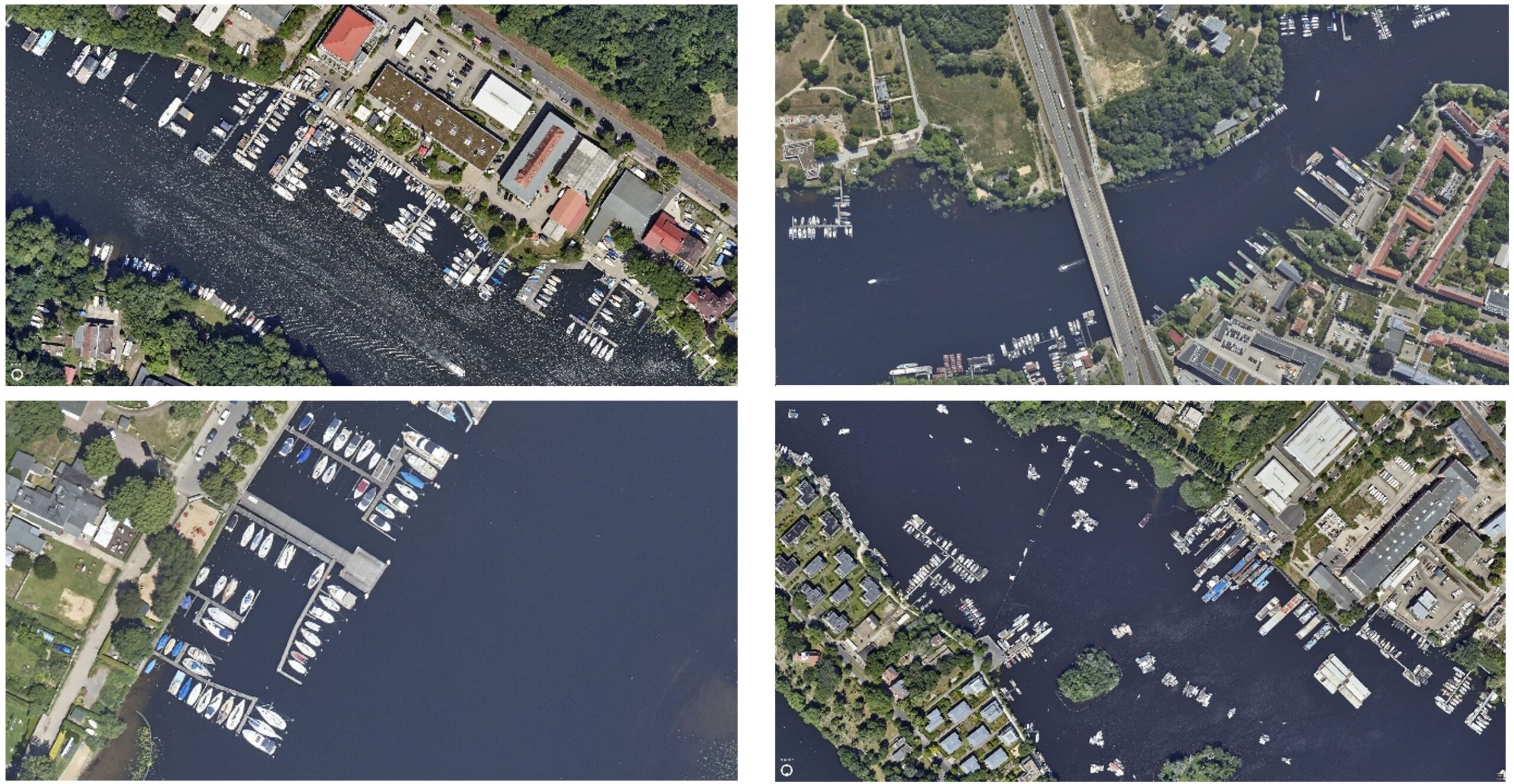

A first glance at the project area on the Globe in ArcGIS Reality Studio shows the extent of the water bodies (in dark blue). Out of ~1200 Km2 of the total area, ~90 Km2 is water, delimited by ~850 Km of shoreline. However, the true complexity of the water lines becomes apparent when inspecting the captured aerial images, which reveal the situation at the time the dataset was captured.

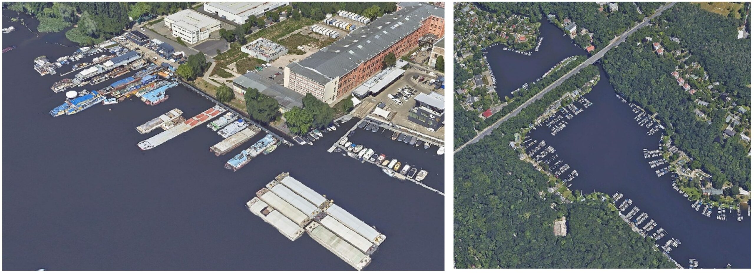

Aerial images capture the infrastructure along the water lines. Bridges, piers and boats increase the complexity of delineating the water contour.
In these circumstances, a precise digitization of the Water Body Geometries would involve a high effort. The collection of features in ArcGIS Reality Studio mentioned earlier reveals a better strategy. The contour of all water bodies can be loosely indicated through a Coarse Water Body Geometry, which can be specified for the Reconstruction. Any remaining noise or inconsistency following this first processing iteration can be resolved by adding a Precise Water Body Geometry in a subsequent localized processing iteration, which will ensure that all water surfaces are constrained to planes at the right elevation.

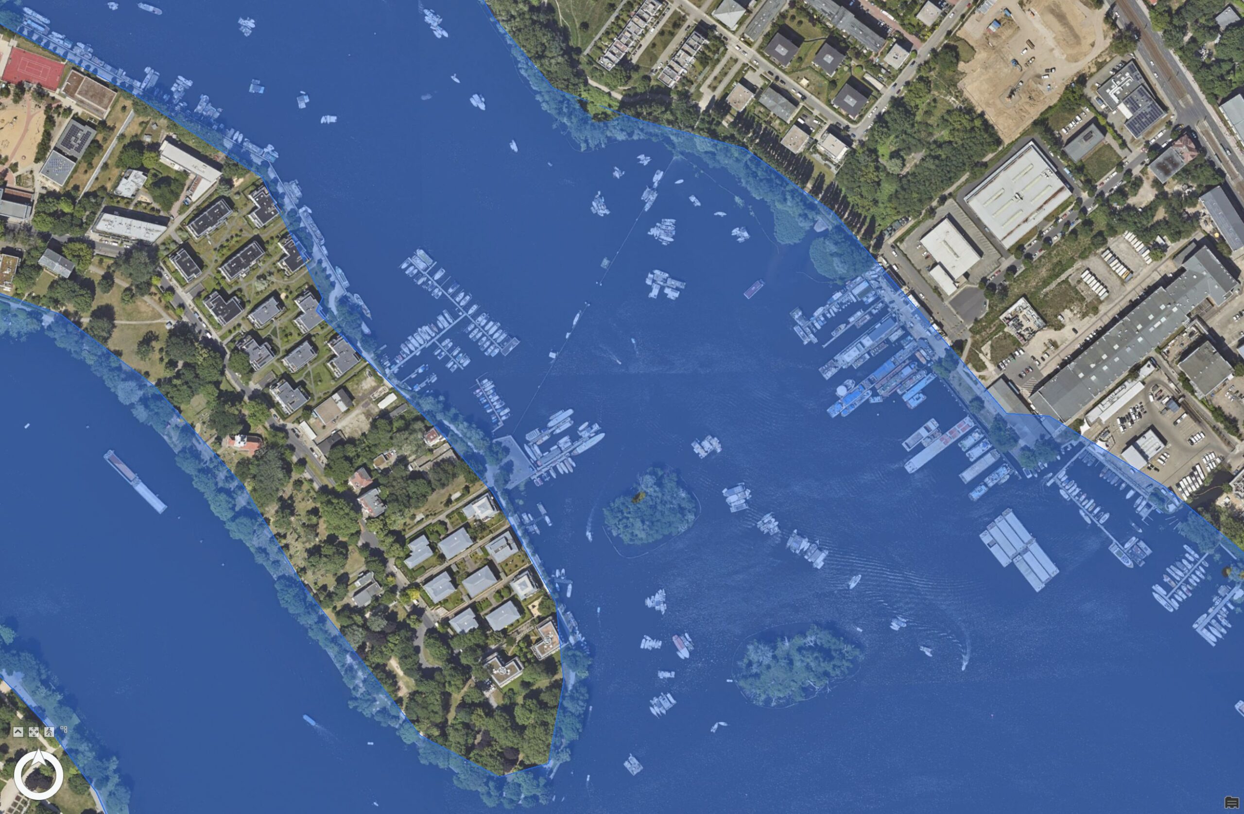

Digitizing Coarse Water Body Geometries over True Ortho in Rapid quality
The digitization of the Coarse Water Body Geometry avoids the intricacies of the complex water lines, with all the objects along them. Instead, the outline is drawn outside the actual shoreline, requiring few vertices and consequently less effort.

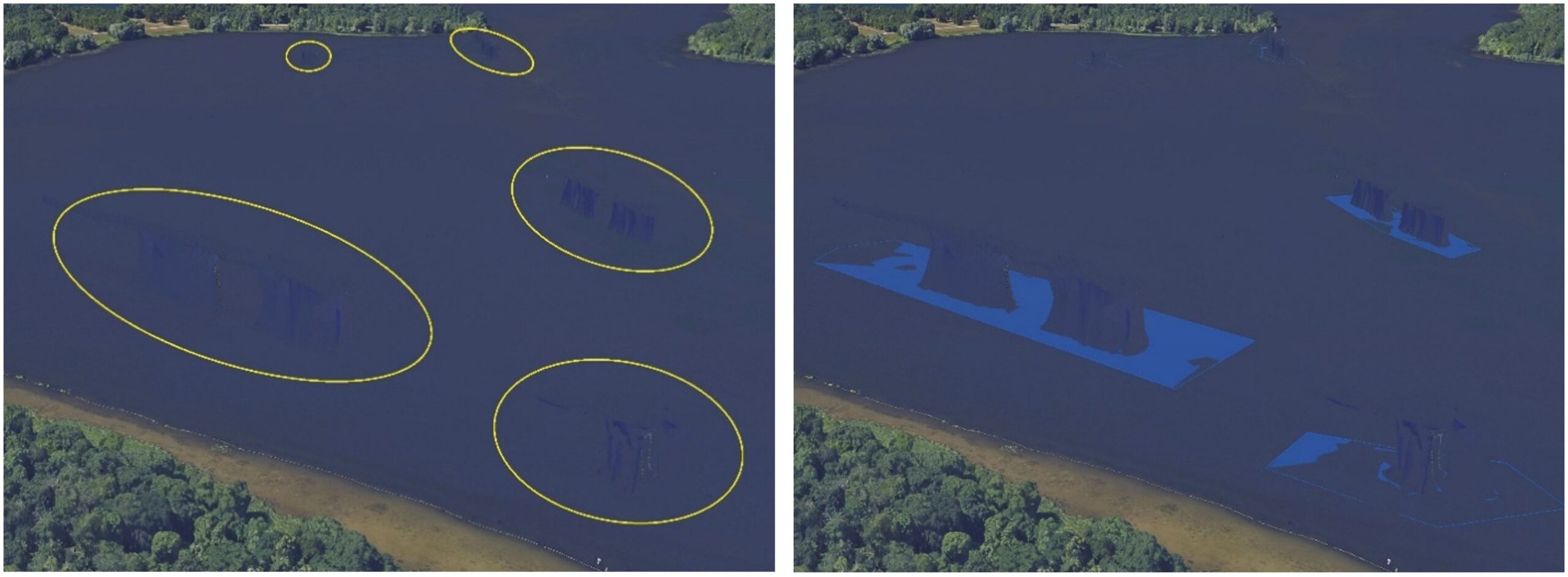

For these cases, Precise Water Body Geometries may be applied in a subsequent processing iteration. In contrast to the Coarse type, the Precise one guarantees the flattening of the surfaces inside its borders. This is the reason why Precise Water Body Geometries should include only water surfaces, while any solid objects must be excluded from within their borders, otherwise they are also flattened.
In this context, the digitization of the Precise Water Body Geometry is fast and limited to the few positions where it is needed. It is sufficient to roughly encompass the noisy patches with polygons containing a minimum number of vertices.
Precise Water Body digitization around noisy patches (right image, in light blue)

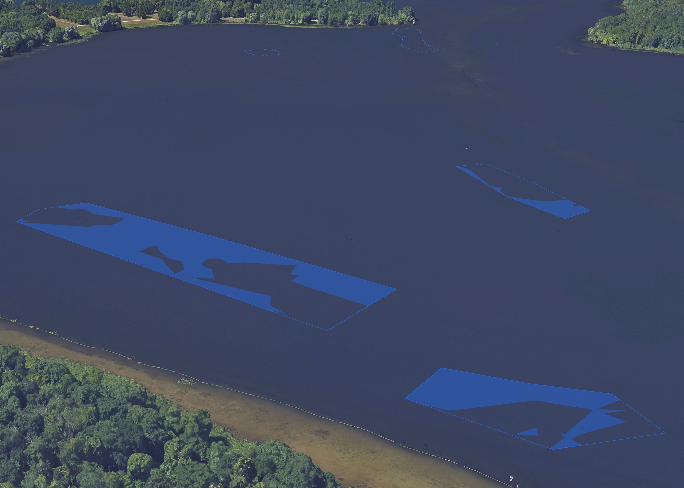

Final Results
After the second processing iteration, the noisy patches are replaced by flat surfaces, which integrate seamlessly with the context.
Results after second processing iteration. Patches where noise existed initially are now flattened (Precise Water Body overlaid In light blue).
