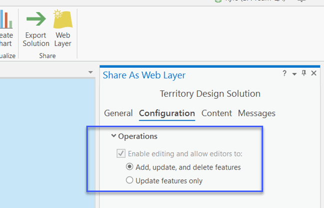

Here I show ArcGIS Pro and a Territory Solution for the Chicago area.  I want to share this layer as a web layer to my organization.  To do so, in the Territory Design ribbon I click Share > Web Layer.
As this follows the standard ArcGIS sharing model – I can share this to my whole organization, keep it to myself, or open it to specific groups.
I can even control how collaborators can interact with the layer…
