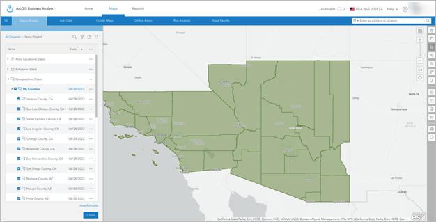

  1. In another Geography (Sites) layer, I have a collection of counties saved as separate sites for some analysis I am doing in the southwestern United States:
Counties in U.S. Southwest

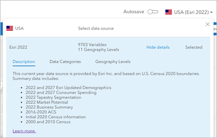

As long as I am working in the Esri 2021 data source, I can continue to work with these standard geography-based sites and create reports, infographics, and run analyses. However, if I switch to the latest Esri 2022 data source using the country switcher:
Select a data source
I see that “No data” is listed under each of these areas, where I’d expected to see my geography sites:

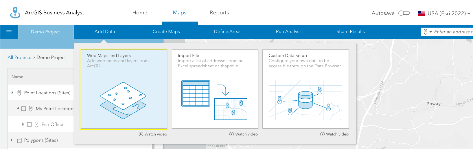

In the Maps tab, start by clicking Add Data and select the Web Maps and Layers option.
Add web maps and layers

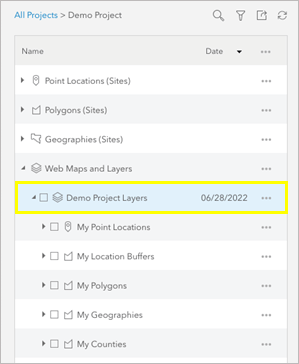

All the map layers from your project are contained in the feature service with your project name. For example, all the content for my “Demo Project” can be added by selecting this card and clicking the Open button.
All the sites and content for this project are automatically added to the map. A tip here is to uncheck the entire folder contents so that it does not take a long time to add all the content to the map:

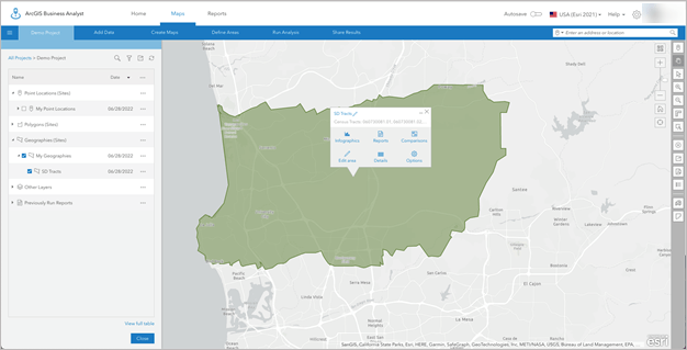

Here you can see that I’ve added the geography site with the collection of Census tracts in San Diego previously created with the 2021 data.
Site added to map

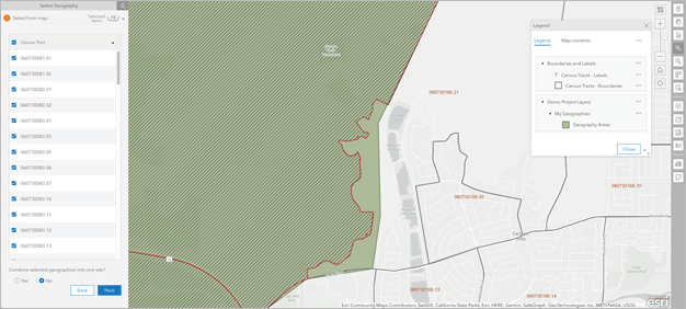

I can then select Define Areas > Select Geography and use the Select From Map option to rebuild a similar analysis area using the Esri 2022 data source with the new Census 2020 boundaries. After the Census tracts are added to the map, I select the tracts that correspond to my previous site and build a close approximation of the analysis area:
Selecting Census tracts
Zooming in to one of the areas, you can see the differences in the IDs for the Census tracts and how the boundaries have changed. The green shaded area represents the area created with 2010 Census Tracts, while the diagonal-shaded areas represent the new tract boundaries. Notice that a portion of this neighborhood is now moved to another Census tract as of Census 2020:
Comparison of Census tracts

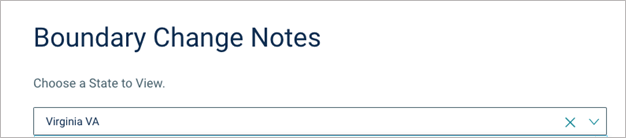

To give an idea of the scale of changes that users can expect, if I select the State of Virginia to view boundary change notes:
Boundary change notes
There are 502 boundary change notes in Virginia, including 66 different county boundary corrections/changes!

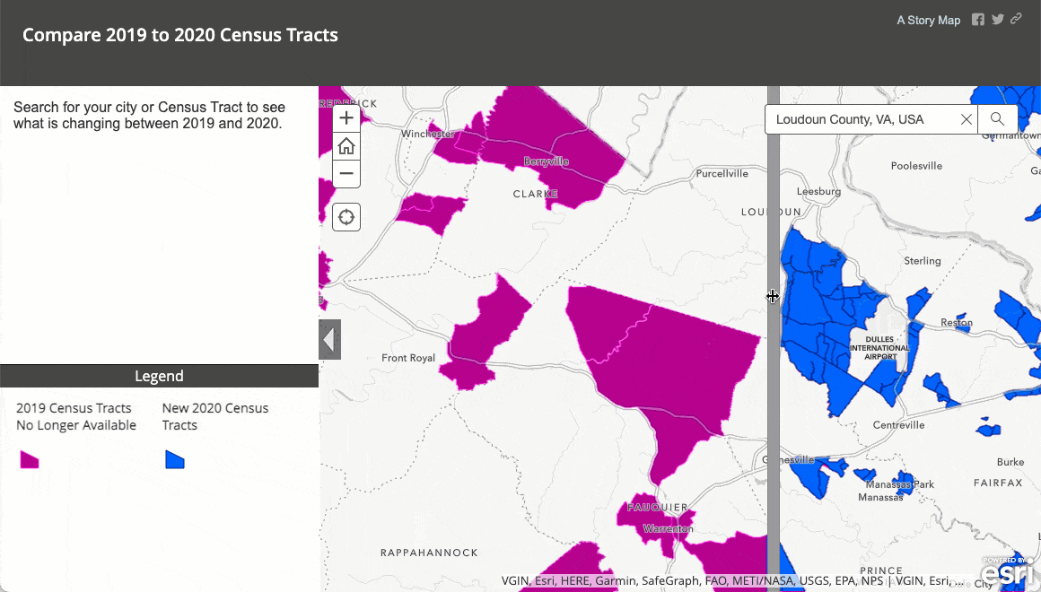

You can see this issue in this great swipe story map from the Living Atlas Team: Compare 2019 to 2020 Census Tracts

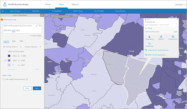

Here is one example, again using Loudoun County to illustrate. The magenta Census tracts are used in the Esri 2021 data source. Look how the FIPS code changed in the new Census 2020 blue boundaries and see how the selected tract is a dramatically different size!
Census tract swipe between 2019 and 2020
Looking at the same Census tracts in Business Analyst, you can see that the single tract selected in the example above in the Esri 2021 data source is split into two separate tracts with a combined population of over 6,000 people.
Example Census tract
