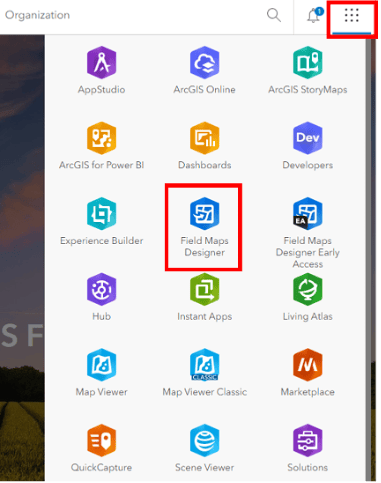

Question: How do I get access to Field Maps Designer?
Answer: You can access Field Maps Designer from the app launcher in ArcGIS Online or ArcGIS Enterprise portal.
app switcher to open Field Maps Designer
Use app switcher to open Field Maps Designer

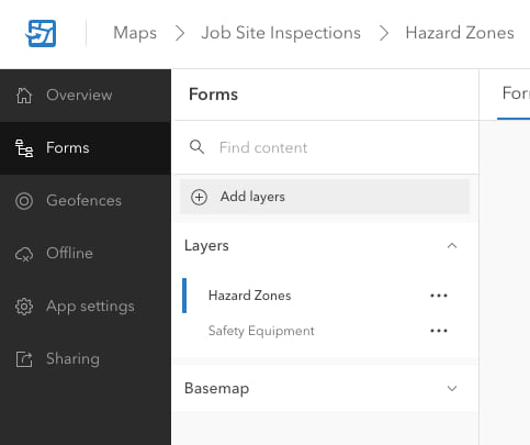

Question: Can an existing layer be used in Field Maps Designer?
Answer:  Yes, you can use existing maps and layers within Field Maps Designer. Whether you have created a web map in Field Maps Designer, ArcGIS Online or Enterprise, or ArcGIS Pro, you can add an existing layer to the map in Field Maps Designer. From the Forms tab, click on add layers to search your content and select the layer you wish to add.
add layers screenshot in Field Maps Designer
Add layers in Field Maps Designer

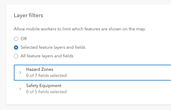

Question: Is there a way to pre-set the filters for the field users?
Answer: In Field Maps Designer, under App Settings, you can enable layer filters and also indicate which feature layers and fields the mobile user can filter with.
layer filter settings
