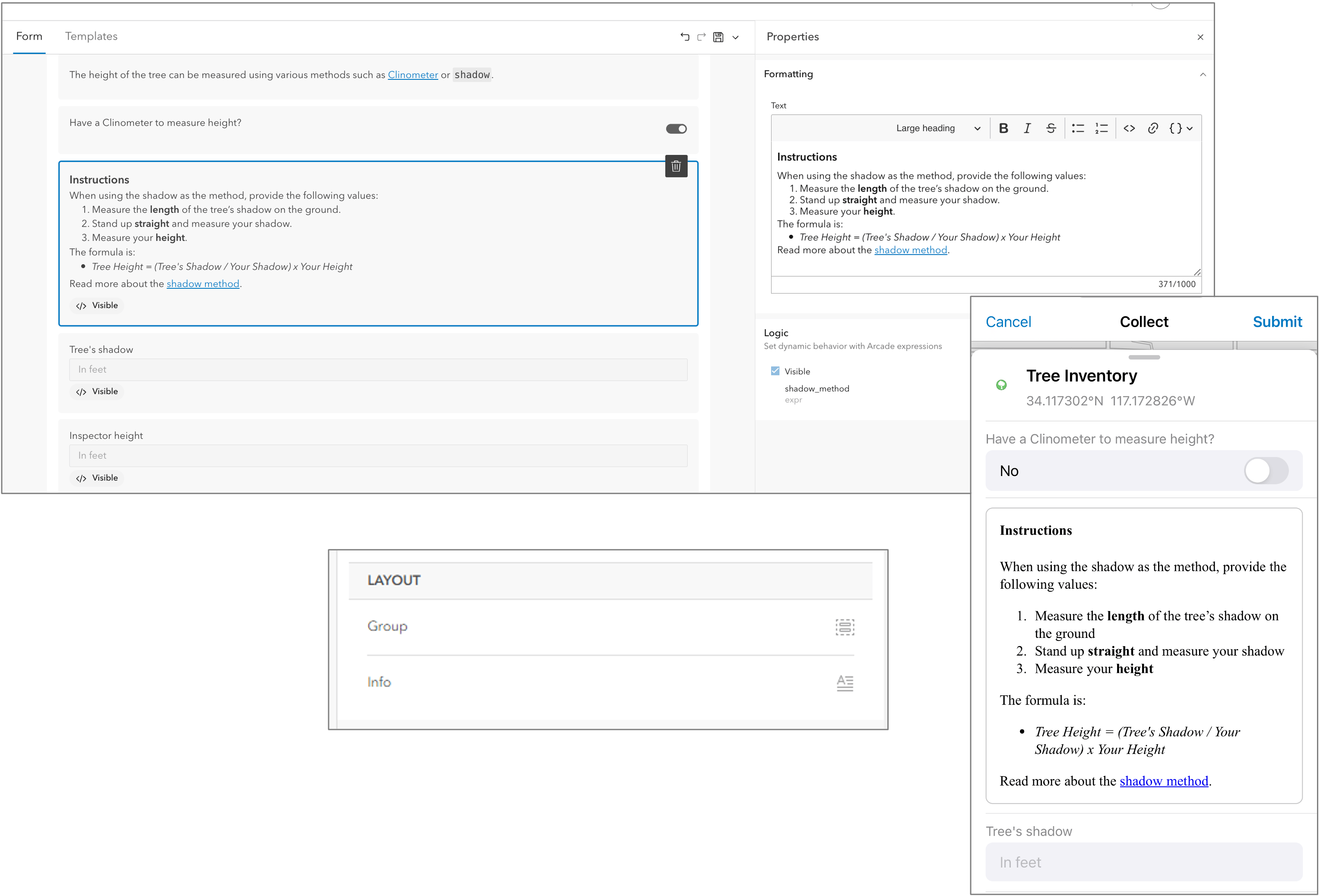

Info form element
Now you can add info elements to provide supplemental information and/or needed instruction when editing forms. Content in an info element is formatted in markdown, and you can include dynamic information drawn from fields and expressions in the form.
Using Field Maps Designer, you can drag an Info element onto the form and provide read-only information using the Text editor.
With the Info element, you can:
  • Format text in a variety of ways, such as with headings, bold, italics, and code font, bulleted and numbered lists.
  • Link text to external sources.
  • Add a visibility expression to conditionally show or hide the info element.
You can include as many Info elements on your form as you like, but each element must not exceed 1,000 characters. HTML content is not supported.
Read the Add read-only information documentation topic or this blog article published March 4th.
Use Info elements to improve form capture.
Info elements provide supplemental information and instruction when completing forms.

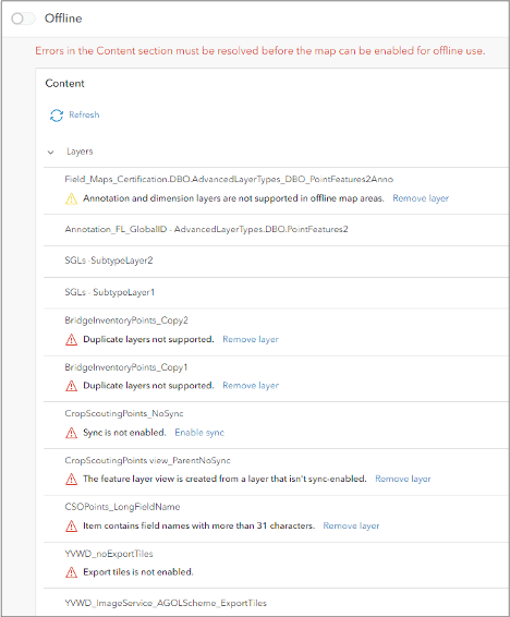

Preparing maps for offline use
When preparing a web map for download, it’s important to ensure your data meets the data requirements for offline use. The Content section of the Offline tab in Field Maps Designer will inspect map layers and present error messages where layers do not meet data requirements.
In this update, we’ve improved offline checks by:
  • Highlighting errors per layer.
  • Offer to remove layers from the map as well as access their item details.
  • Check image services to ensure they support export tiles.
  • Check feature layer views to ensure their parent layer supports sync.
  • Check that multiple layers do not reference the same feature layer sublayer.
  • Flag subtype group layers and image service layers.
  • Provide warning messages for annotation and dimension layers.
Read our topic titled Enable content for offline use for details and we recommend reading the Enabling layers and maps for offline use in the ArcGIS Online documentation as well.
Field Maps Designer checks your layers are enabled for offline use.

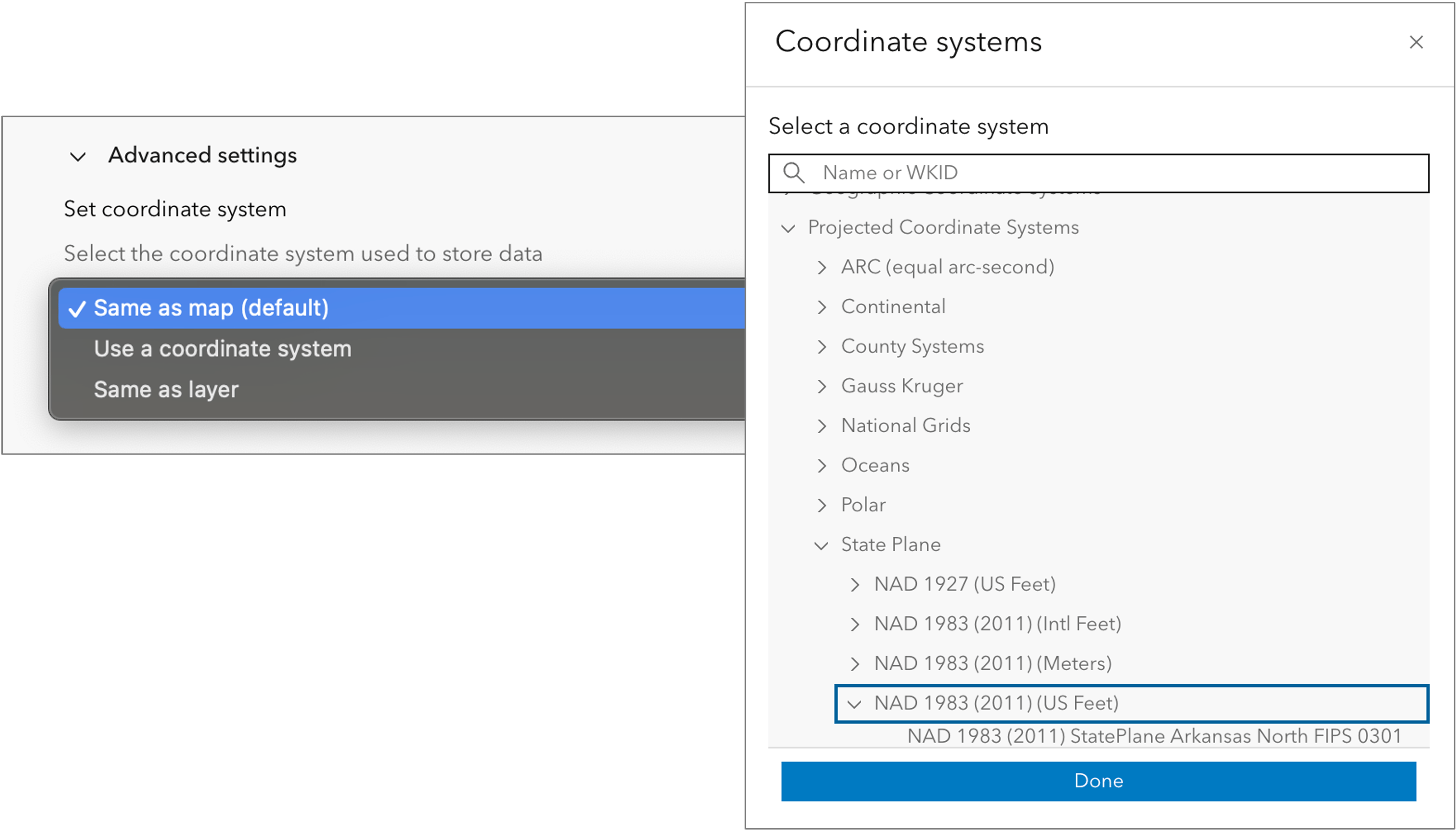

Choose a coordinate system
When creating new layers for new and existing maps in Field Maps Designer, you can now choose a coordinate system. This is important for high-accuracy data collection projects where you need to store captured features in a local, projected coordinate system.
From the advanced settings section of the new layers dialog, click “Use a coordinate system”, browse, and select from a list of coordinate systems.
Set a coordinate system when creating new layers.

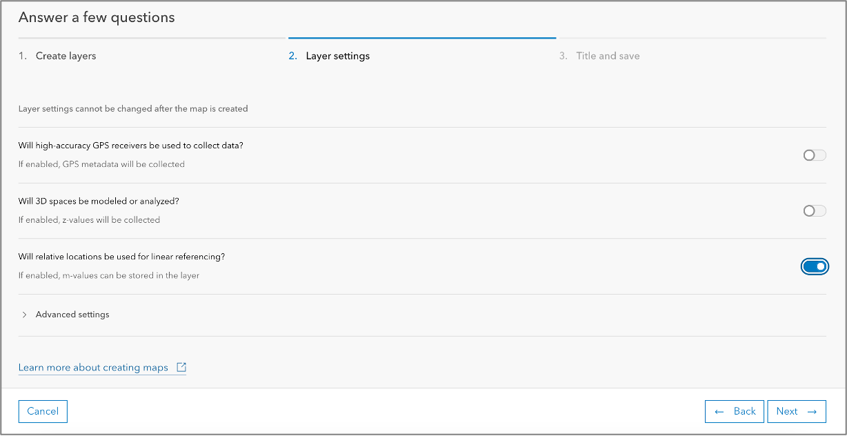

Enable m-values
In 2022, Field Maps added support for finding measurements along linear features. Now, we’re adding support in Field Maps Designer to enable m-values on new layers. Choosing to support relative locations will enable m-values for point, line, and area layer types.
Add support for linear referenced features by enabling m-values.

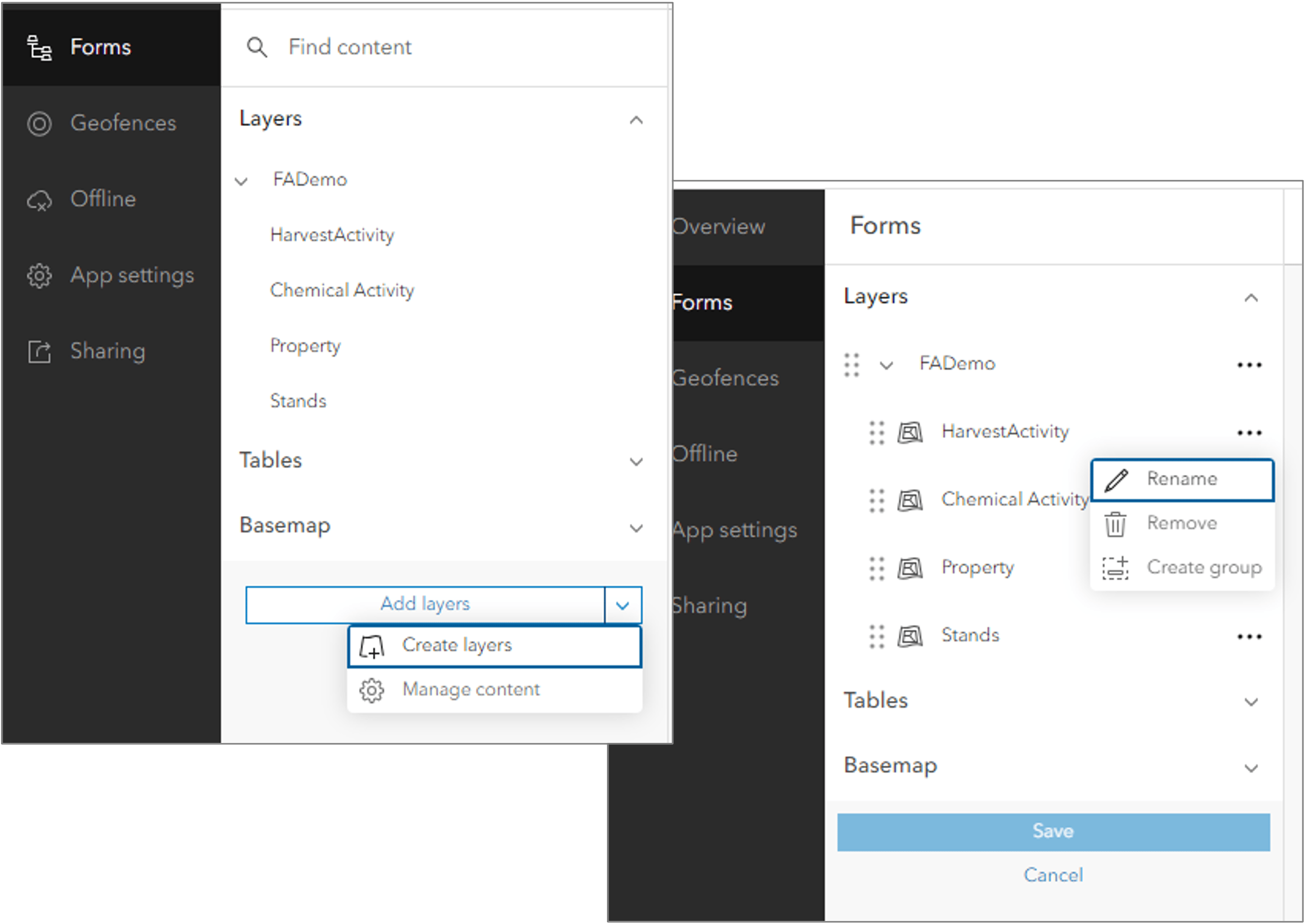

Managing layer content
Maps can have many layers and tables. Clicking Manage content from the Add Layers dropdown, you can drag and drop layers and tables to re-order them, remove layers, create new group layers, and rename map layers and tables. When in the managed content experience, layers will display an icon representing their geometry type to help you make decisions when changing layer order.
Re-order layers and tables, create and name group layers, and remove layers directly from the manage content experience.

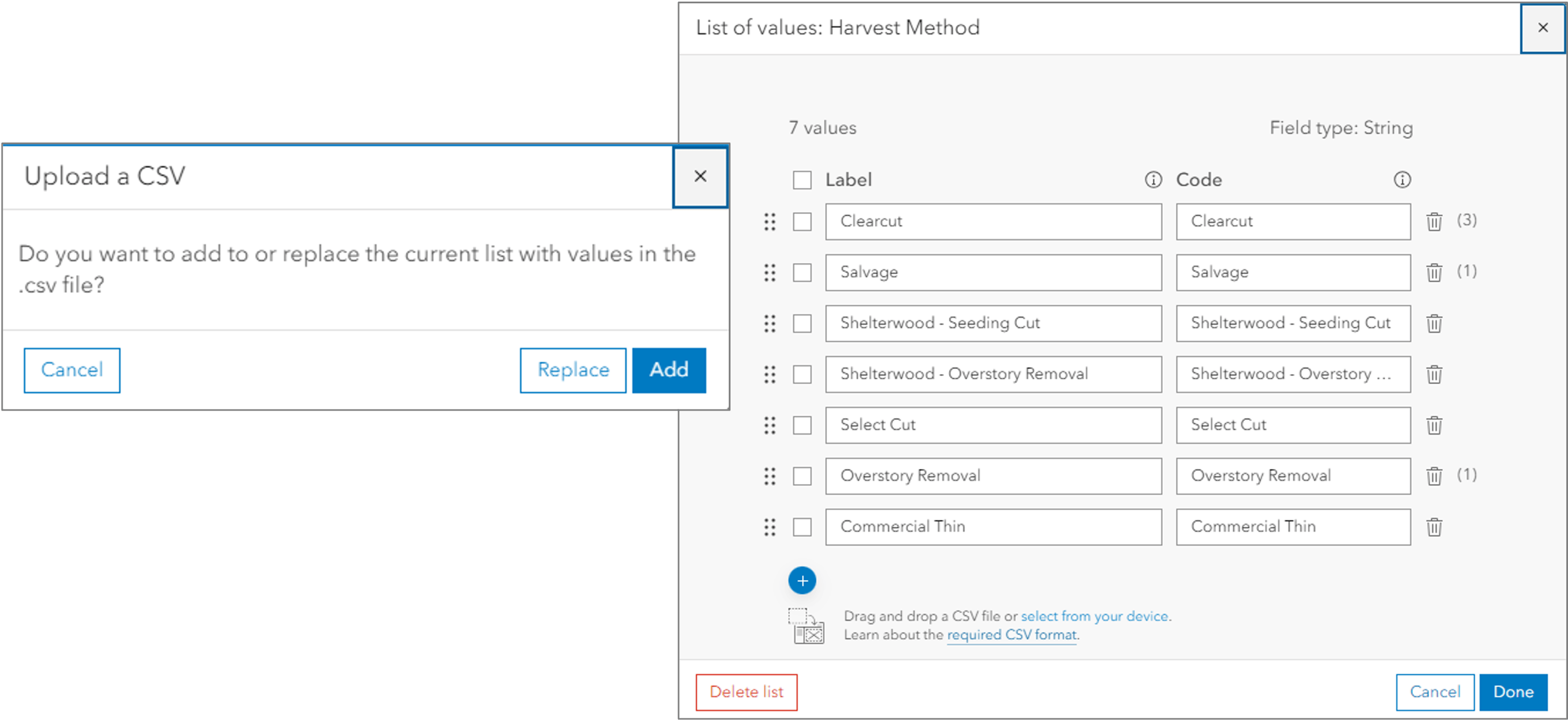

Manage lists
The February update includes additional support for managing lists in forms. With existing lists, you can use a CSV file to either add or replace the list of valid values. In addition, the list of values will show frequency counts on list items.
Add or replace the list items using a CSV file.

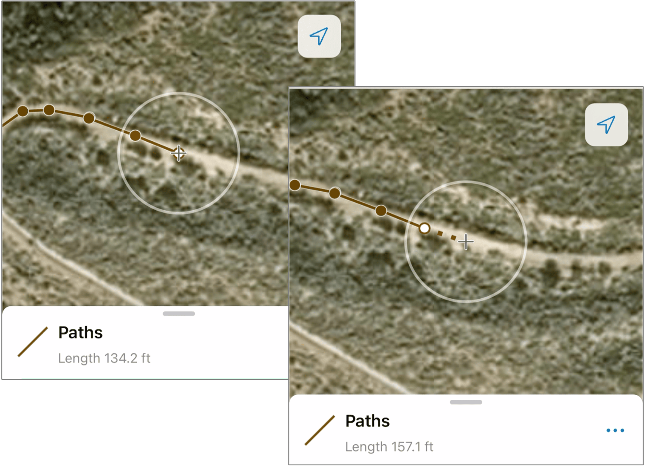

Dynamic cumulative length
When collecting linear features, the cumulative length of segments captured are displayed while collecting the geometry. The measurement value now includes the length of proposed geometry (distance from the last vertex captured to the target location).
The cumulative length now includes the proposed segment length as well as the length of all existing segments.
