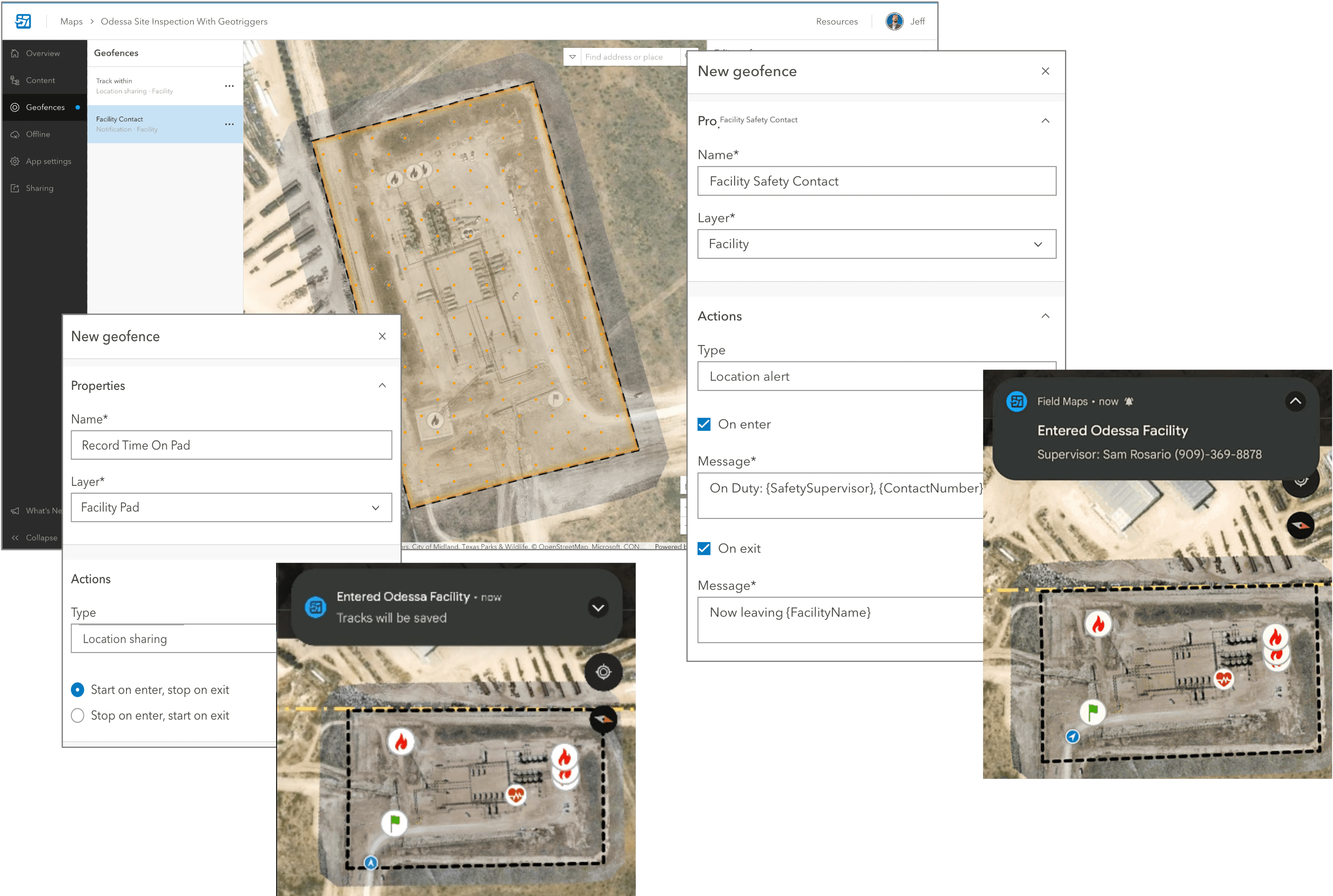

Geofencing
Field Maps now supports adding geofences to your maps so that mobile users can be warned when entering dangerous or restricted areas, provided critical information when approaching a building, tracked only when on company property, and more.
Geofencing is powered by the new ArcGIS Geotriggers capability. Geotriggers monitor user-defined conditions on a mobile device in real-time that result in actions on a mobile application. The actions are local to the mobile device.
Geofences can be added to any web map using the Field Maps web app. While the map is open in the Field Maps mobile app, actions will be triggered as the device enters or exits geofences. Geofences work in the foreground or background of the device and online or offline.
Field Maps supports two types of actions:
  • Location alert – Location alert actions send location-based messages to the mobile user in the form of local notifications.
  • Location sharing – Location sharing actions automatically start or stop recording locations based on the mobile user’s location. To use location tracking actions, location sharing must be enabled for your organization and your mobile users must have a location sharing license.
Geofencing capabilities are available with ArcGIS Online and ArcGIS Enterprise 11.1+.
Control location sharing and receive location alerts by adding geofences to your map.

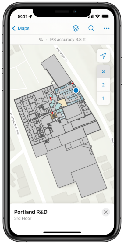

Indoor Positioning
ArcGIS Field Maps works great indoors as well as outdoors. Last year we added support for floor-aware maps created and published using ArcGIS Pro or configure in ArcGIS Online.
Now we’ve integrated ArcGIS IPS within Field Maps to provide accurate geolocation so mobile users can locate themselves indoors. If you open a map in the Field Maps mobile app that’s configured for IPS, Field Maps will automatically detect IPS beacons within a building and use them to generate your location in the app. You’ll know when you have an IPS location fix as the banner above the map will display IPS accuracy instead of GPS accuracy. Tapping on the banner will provide additional IPS details like the position quality, number of transmitters, source type and floor.
Field Maps automatically determines the best location source to use—IPS or the device’s integrated GPS. If you move to a different floor in the building, the map automatically updates to display the floor you’re on.
Indoor positioning is supported with ArcGIS Online and ArcGIS Enterprise 11.0+.
Powered by ArcGIS IPS, Field Maps can locate you when inside or outside.

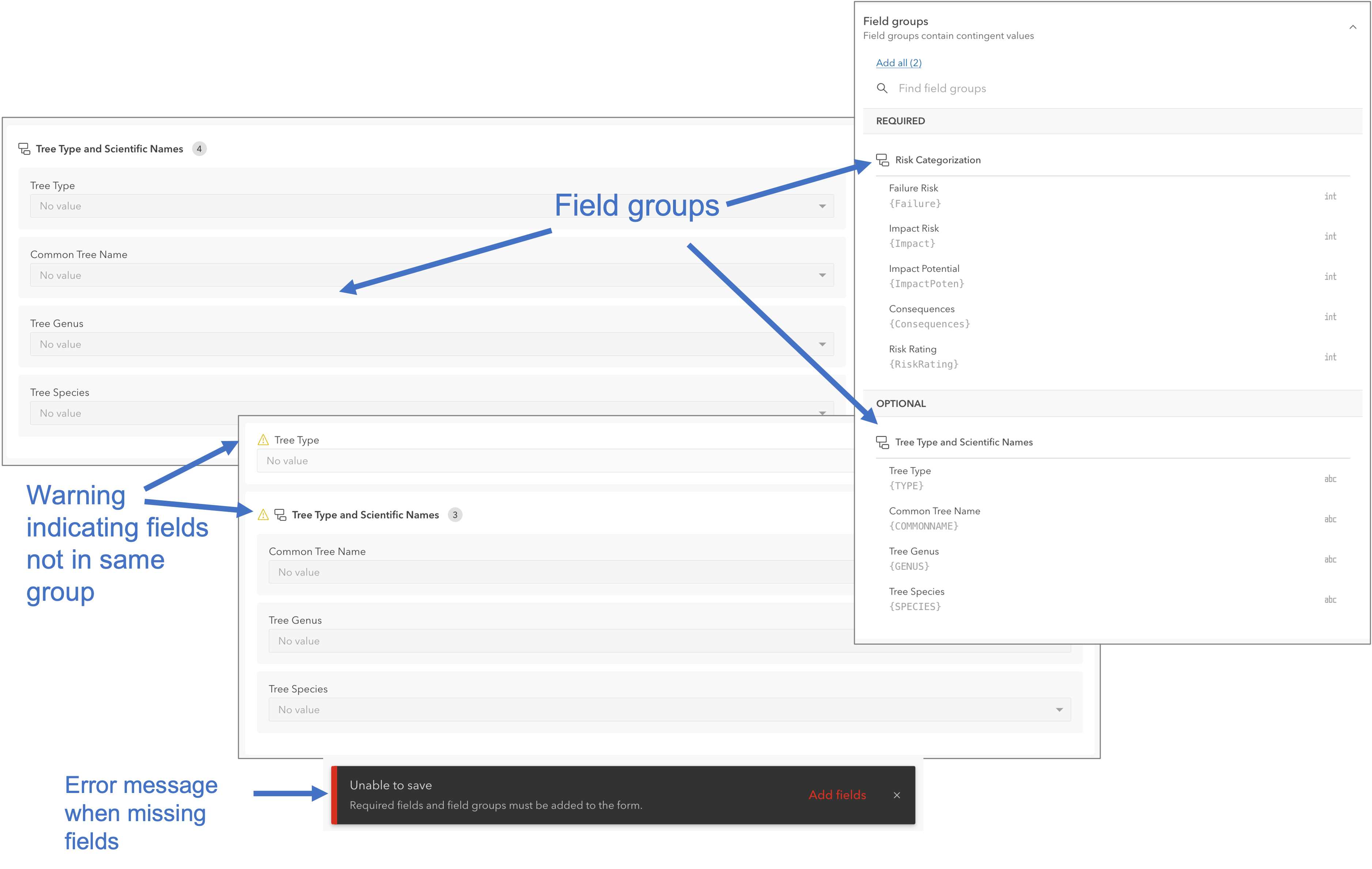

    Contingent Values
    The May 2022 release of Field Maps introduces support for contingent values. Contingent values are commonly used to model natural classifications (trees, plants, wildlife) or material classifications for assets (poles, pipes) and can dramatically improve the efficiency and accuracy of form data capture in ArcGIS Field Maps.
    With the June update, contingent values are supported offline. Also, we’ve dramatically improved the form authoring experience to better support field groups.
    If contingent field groups were configured in ArcGIS Pro, they will appear in the Field groups list next to the form canvas. If field groups share common fields, they are listed together.
    When a field group is added to the form, its contingent fields are contained in a group element. Contingent fields should stay grouped together so mobile workers can fill them out sequentially in the Field Maps mobile app. If a field is removed from its field group, a warning appears.
    If field groups are required, they appear in the REQUIRED section of the list and must be added to the form. Field groups are required if they were configured as restrictive in ArcGIS Pro. If contingent field groups are not added to the form canvas, mobile workers may not be able to submit the form in the Field Maps mobile app.
    Contingent values are available with ArcGIS Online and ArcGIS Enterprise 11.0+.
    Use the form designer to organize and manage field groups on your forms.
