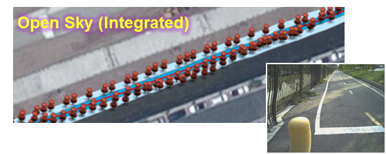

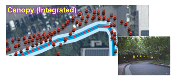

Cellular-enabled smartphones and tablets include an integrated GPS chip-set manufactured by companies like Qualcomm, Broadcom, CSR and others. These chip-sets are designed first for power consumption, second for time to fix and third for locational accuracy. What we found in our testing is that locational accuracy is pretty much the same regardless of manufacturer. In the open sky, mapping with several devices approximately 90% of all positions collected fell within 3m of our baseline. These results were not too shabby really! In canopy conditions where we encountered significant multi-path interference from the receiver, results were considerably worse.

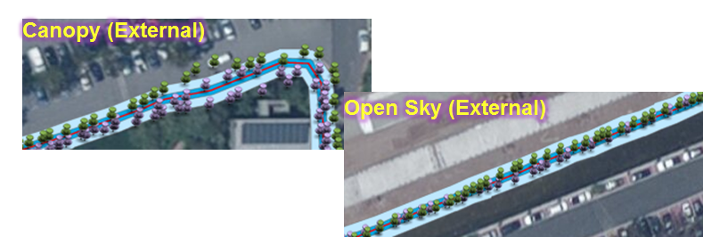

Next we connected our smartphones to external GPS receivers that were considered “consumer grade”. These chip-sets are designed first for locational accuracy, second for time to fix, and third for power consumption. Here we found that you can purchase a variety of receivers that connect either directly to the device or via Bluetooth and most with SBAS capabilities! In the open sky, virtually all positions captured (99%) were within 3m and almost 70% were within 1m of our baseline! As expected, positions degraded in canopy conditions but overall were much better!

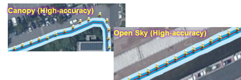

Finally we connected an iPhone 4s to a high-accuracy, dual-frequency, survey-grade receiver from Altus Positioning Systems using a commercial product called GPS Cable from Aman Enterprises Inc. The GPS Cable will create an external connection to virtually any external GPS receiver using RS-232 and stream NMEA to the location manager on your smartphone. This replaces the location source in the same fashion as the external “consumer grade” GPS device does. Not to embarrass the other receivers we tested, and to ensure that we were only using the receiver itself and not supplementing our source using NTRIP (which we could have done), we chose to only map using SBAS and not fully leverage the true capabilities of the receiver. Even so we found that virtually all positions (over 92%) were within 1m!!
