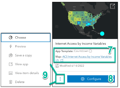

The My Apps tab allows you manage existing apps
Once you have created and configured a few apps of your own, you may want to organize or update your existing apps. The My Apps tab presents the apps that you own as cards, listing the template name and map (7) being used. You can filter for apps owned by you or by your organization. You can also filter apps by template and sharing. From here, you can click Configure (8) to open your existing app and make updates.
The remaining menu options (9) include Choose and Preview. Within My Apps, you can use the same Choose map button that is available on the Create tab to select a different map to preview with the same settings you have configured in the existing app. Clicking Choose creates a new app item using the same settings as the existing app. You may need to update some app settings depending on the layers and properties in your map.
Other available options include the ability to launch the app, view the app’s item details, create a copy of your existing app, or delete apps that are no longer needed. For existing Attachment Viewer, Nearby, Sidebar, and Zone Lookup apps, the option to create a native app with ArcGIS AppStudio will appear on the app card.
