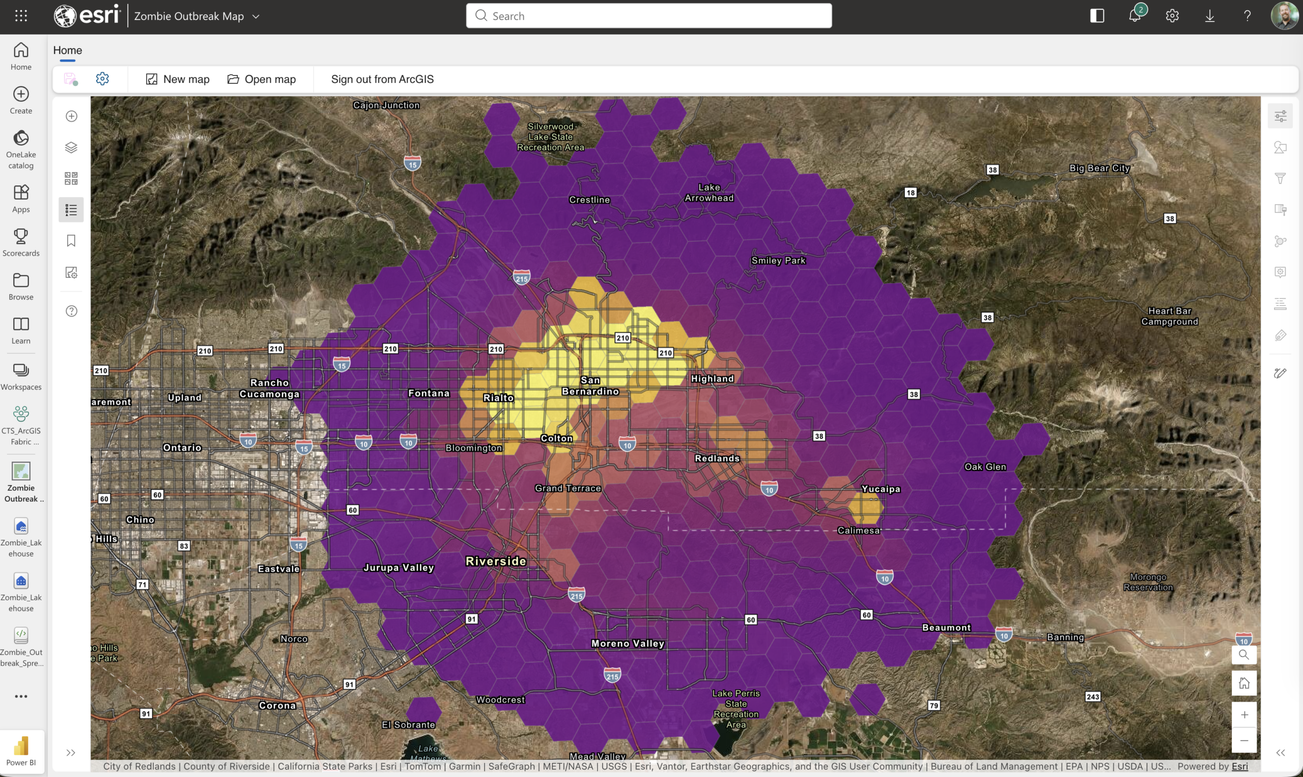

Zombie extent
30 Days after the initial outbreak, we can see how things are spreading and the density of the infestation.

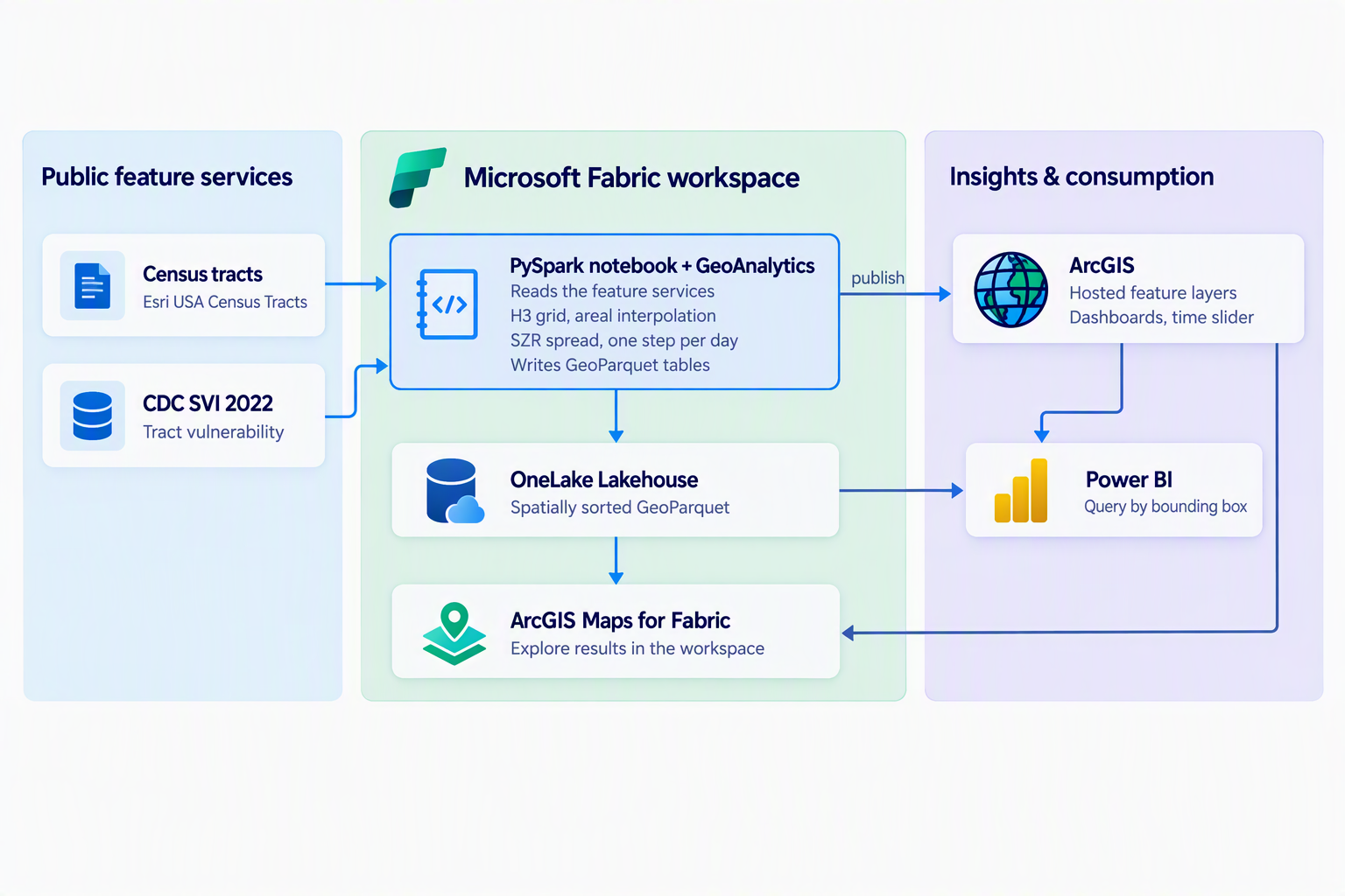

All the analysis runs in one Fabric notebook. GeoAnalytics for Fabric adds more than 160 spatial functions to Spark, plus readers and writers for ArcGIS feature services, so no data has to be downloaded by hand.
Public census and vulnerability data flow in from ArcGIS feature services; results land in OneLake and, optionally, ArcGIS Online.
Conceptual Architecture
ArcGIS Maps for Fabric closes the loop inside the workspace. It is a Fabric workload, that creates a new item like a notebook or a lakehouse, that can map lakehouse data directly. That means the data team can check each run on a real map before anything is published. The same map can also pull in authoritative content from your ArcGIS Online organization or from the ArcGIS Living Atlas, so the outbreak can sit on top of roads, imagery, or your own hosted layers.

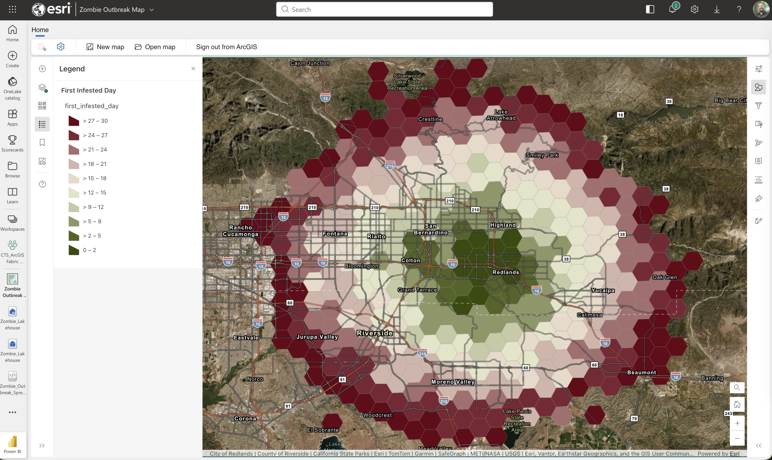

First Infested Day
Understanding how things spread in a temporal basis is important. Here we see how the Zombie hoard has moved on a day by day basis after 30 days.

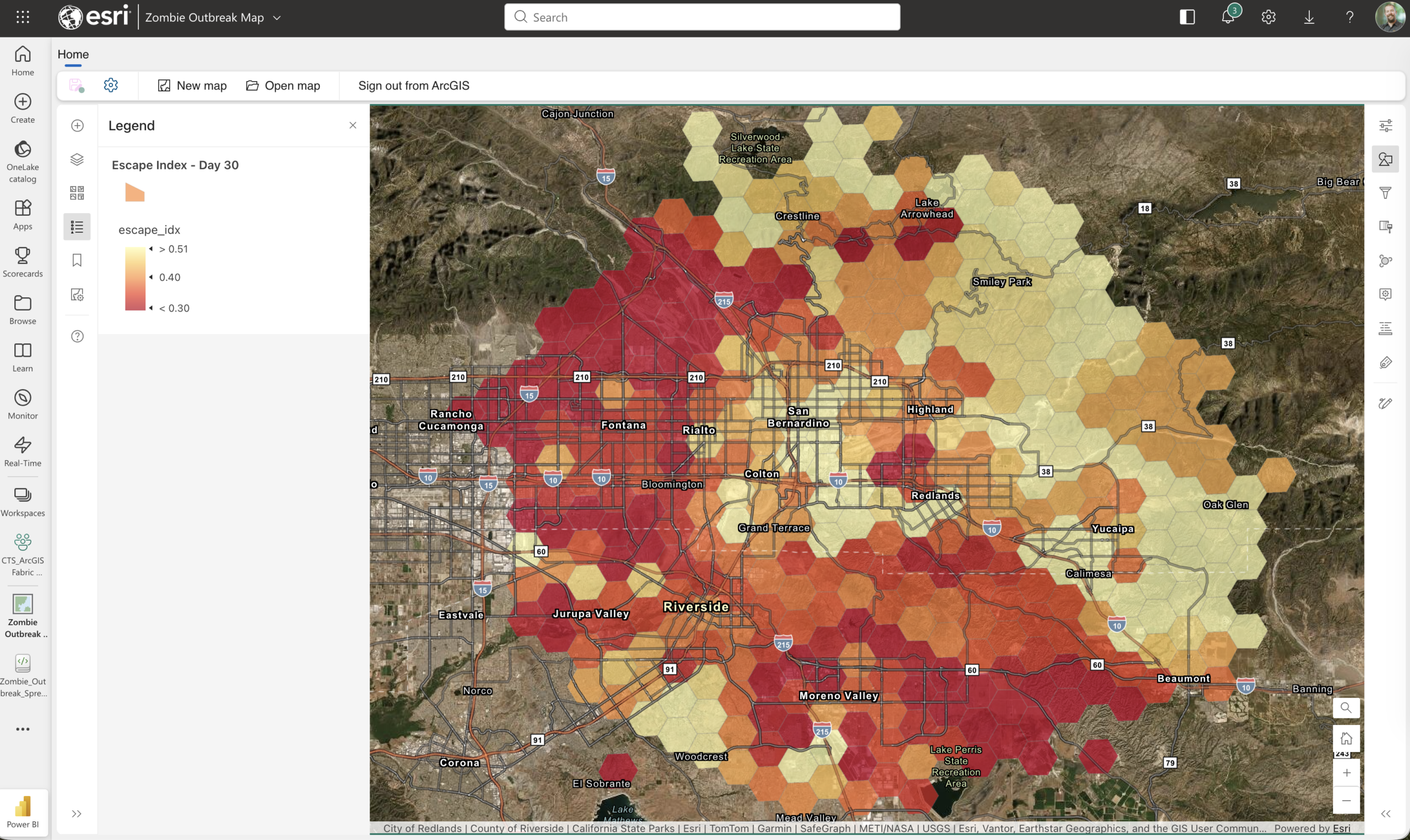

3. Vulnerability from the CDC SVI. The CDC/ATSDR Social Vulnerability Index ranks every tract on factors such as crowding, age, disability, and vehicle access. I turned a subset into two indices that change the odds in each cell:
  • Contact index: crowded housing, large apartment buildings, and group quarters. More contact means more bites.
  • Escape/defense index: older residents, people with disabilities, households without a car, and mobile homes. Harder to flee or fight means more bites and fewer zombies destroyed.
Zombie Escape Index
While understanding movement is important, we also need to understand how people are impact by the spread. Where do we see more vulnerable populations based on contact, demographic, and mobility considerations.

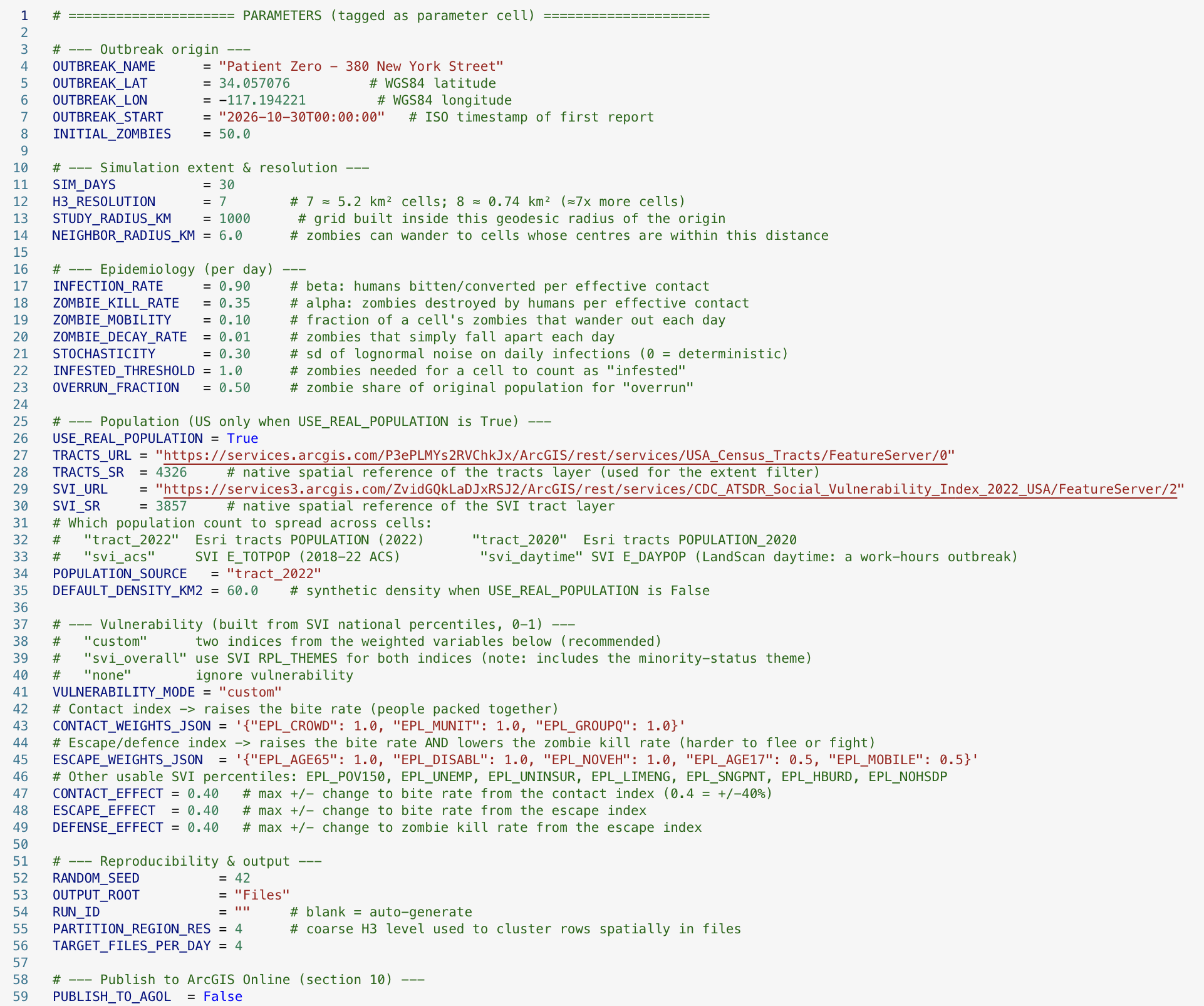

Everything that shapes the outbreak is a parameter: the origin, the start date, grid resolution, bite rate, kill rate, how far zombies roam, how much randomness to add, and how strongly vulnerability matters. Because the parameters cell is tagged in Fabric, a pipeline can rerun the whole scenario from a different patient zero without anyone touching the code.
Notebook Parameters
There are many variables that can be tuned to adjust model duration, spread factors, and parameters that may impact vulnerability.

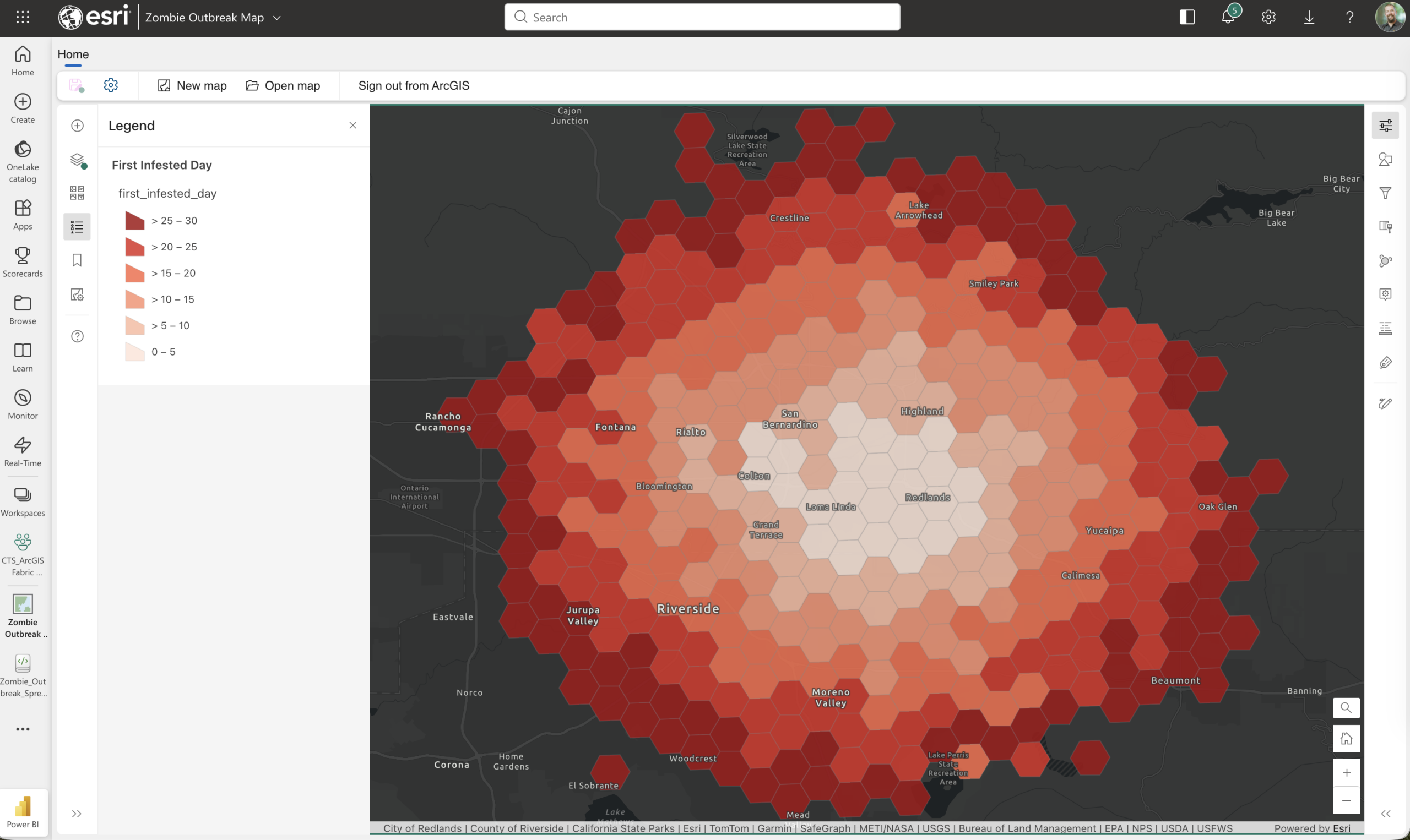

By day 30, the outbreak had reached 37.4 km from New York Street and was advancing about 4.4 km a day.
When did each neighborhood fall? The arrival table records the first day each hexagon became infested. Mapped, it reads like a weather radar of bad news.
Zombie Spread and Progress

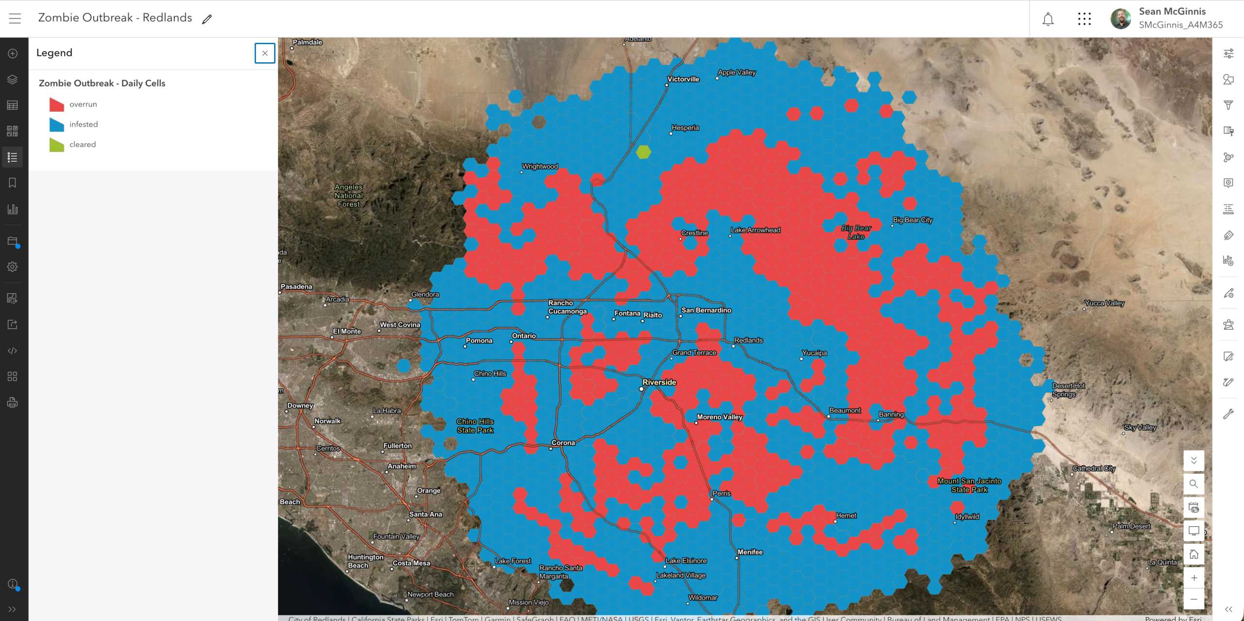

Hosted feature layers in ArcGIS Online. Flip PUBLISH_TO_AGOL to True and the notebook publishes each table as a hosted feature layer. Turn on time for the timestamp field, and the map’s time slider plays the outbreak back day by day.
Zombie Infestation Status
