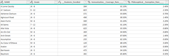

I am exploring whether vaccination rates in public schools can help identify districts that are good targets for public health outreach on early childhood health. I have a dataset in Power BI with information on vaccinations and exemptions for each school in the city. But the vaccination table only lists each school’s name. No location—big problem. I can’t easily get this data onto a map.
A data table in Power Query

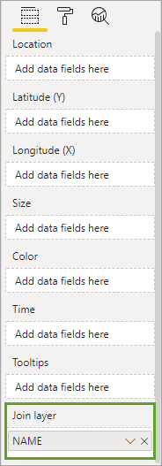

My vaccination data is set up in Power BI and I have added a map to my report. To start, I choose a field to use for the layer join. Since both datasets include the school name, I click the ArcGIS for Power BI visual and drag the NAME field from my Power BI dataset into the Join layer field well.

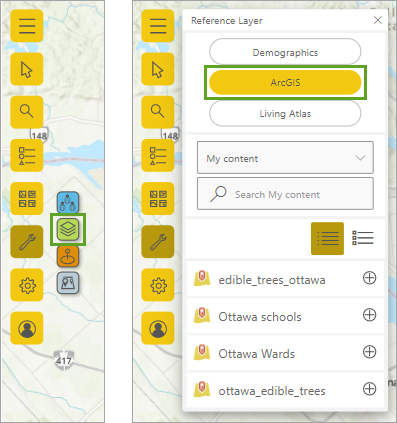

Next, I add the reference layer to my map. All Power BI users can add public ArcGIS content and a set of curated layers containing United States demographic data. If you’re signed in to ArcGIS, you can also add content from your ArcGIS organization (which is where my layer is) and from Living Atlas.
Reference layer map tool
When choosing a reference layer for a layer join, make sure it contains attributes that match the ones in your Power BI dataset. In this case, if I add a layer that doesn’t contain the school names, my layer join won’t work.

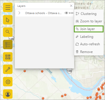

Now that I’ve added a reference layer, I select the Layers list from the map tools. The Join layer option appears in the reference layer’s context menu—and this is where the magic happens.
Join layer

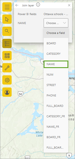

Once I select Join layer, I choose the field in the reference layer that matches my Power BI data. The field name doesn’t have to match exactly, but the data attributes must be of the same type. For example, I can only join numbers to numbers, strings to strings, and so on.
Join layer pane
Finally, I click Create join. And now, the final reveal. Drumroll, please…

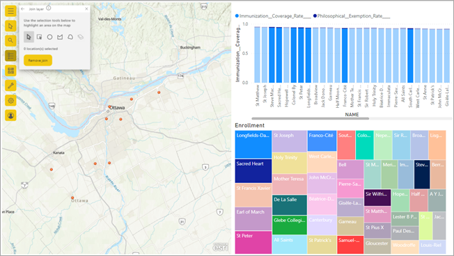

Now that the information in my Power BI report is linked to the locations on the map, I can use the Join layer selection tools to highlight schools on the map and get targeted, specific information in my report’s other visuals.
Likewise, the map responds to my interactions with the other report visuals, filtering down to display only the selected locations.
Layer join selection tools in a Power BI report
