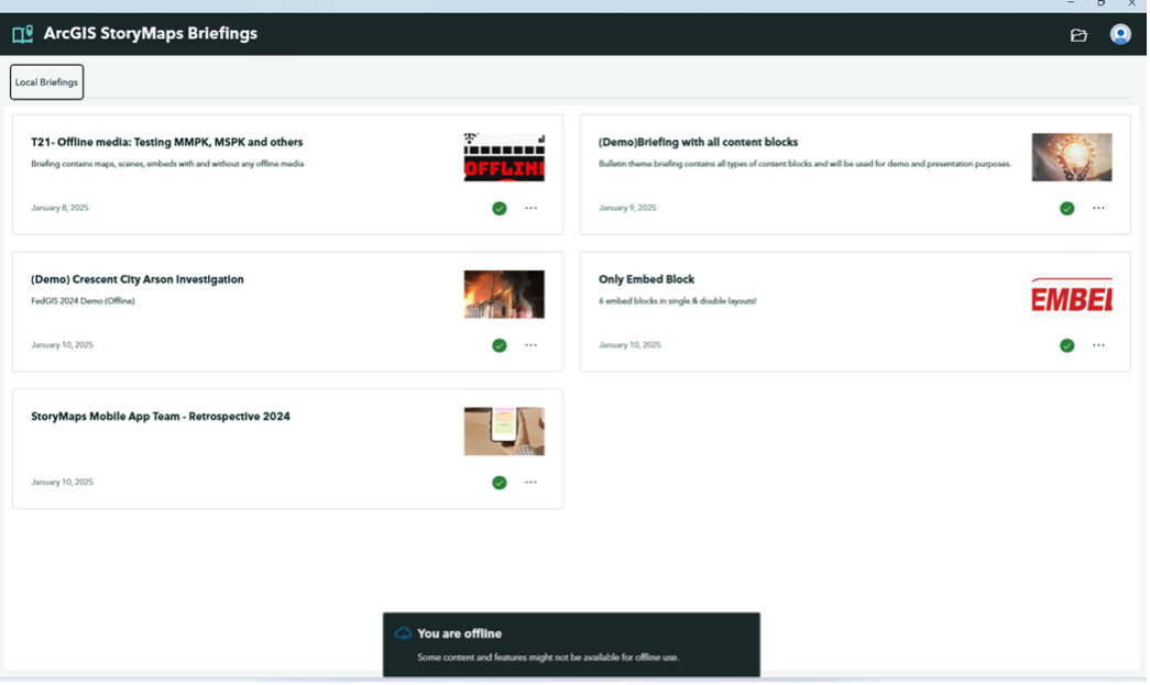

    • Check for the Local Briefing Tab as the fourth tab. Click on the tab.
  4. Select location of your briefings:
    • Click on the folder icon located beside the profile avatar.
    • Select the location where you have the local briefings. You can choose either a single briefing folder or the parent folder containing all the local briefings.
  5. Access Local Briefings:
    • After selecting the location, you should now see all the local briefings in the Local Briefings tab.
Please note that the date displayed for local briefings is the folder date which might be different from the date configured while creating briefing in the briefing builder settings.

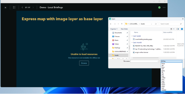

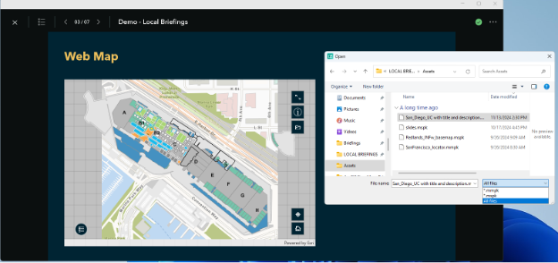

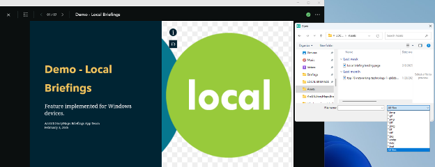

Upon opening any local briefings, you will notice a folder icon located on each image, video, MMPK/MSPK, or any offline placeholder. This icon allows you to browse the supported formats of resources available for each content block.
The following content blocks are currently supported for updating offline resources:
  • Image
  • Image Gallery
  • Video
  • Web Maps
  • Web Scenes
  • Express Maps
  • Embed
Important Note: Content blocks that were added as link to resources cannot be updated. You are limited to adding offline dependencies that are supported for each content block. For instance, you can use MMPK/MSPK, Image, or Video for web maps and scenes, and Image or Video for express maps and embeds. When it comes to updating resources, it is important to note that you can only replace an MMPK/MSPK with another MMPK/MSPK, or an Image with another Image, and so forth. Additionally, the downloaded icon will appear for local briefings; however, it will not be responsive, and all options in the header menu will be disabled.

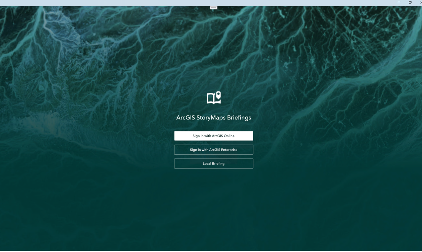

After you signed in to your ArcGIS Online or ArcGIS Enterprise account for once and enabled “Local Briefing” from the app settings, you can still access these local briefings even without signing in to the app the from next time. Open the briefings app from scratch, you will now see “Local Briefing” button on the landing page. Clicking on it allows anonymous users to access, view and update local briefings even without internet connection.
Accessing local briefings as an anonymous user.
