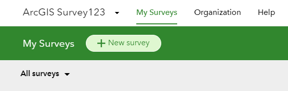

  • Click on New survey
New Survey button shown

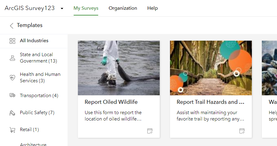

  • Choose to create a survey from an existing template
new template option shown
  • Search for the Report Oiled Wildlife template and use it to create a new form

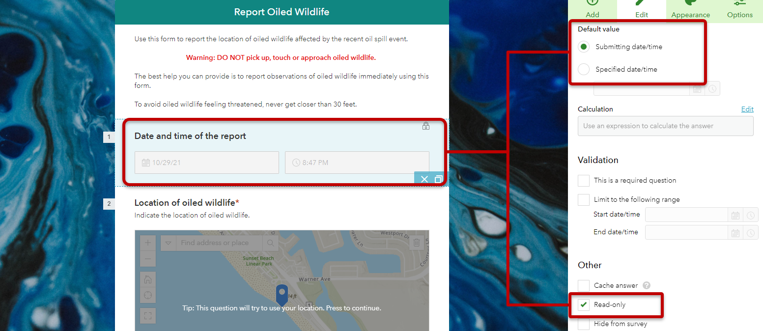

  • Select now the Date and time of the report question. I want to draw your attention to the default value section. Note that the date and time are automatically calculated.
  • Scroll down further and you will note that the question has been configured to be read-only. This means that end users will not be able to change the calculated value. If you do not like that, you can choose to uncheck the read-only option.

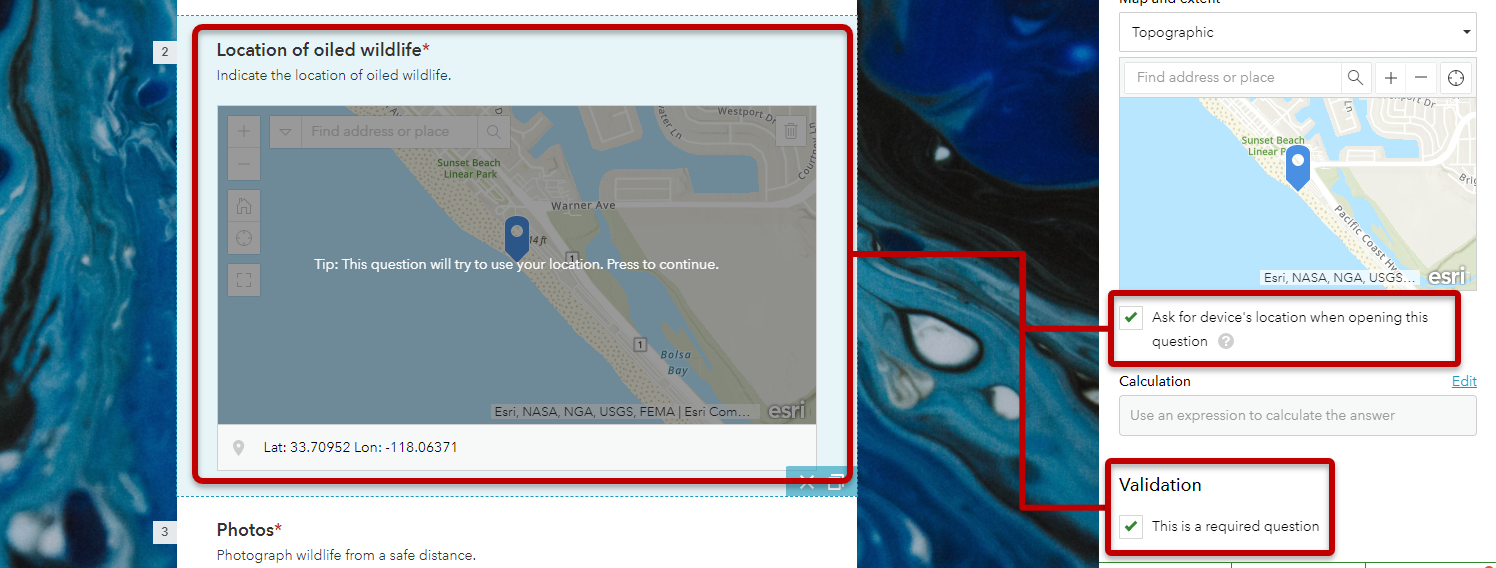

  • A map question is used to help define the exact location of the observation. Select the Location of oiled wildlife question. Note that it is marked as required. Users will not be able to send their oiled wildlife report without answering this question. The map is configured to automatically center at the user’s location when activated.
Survey123 designer map question type

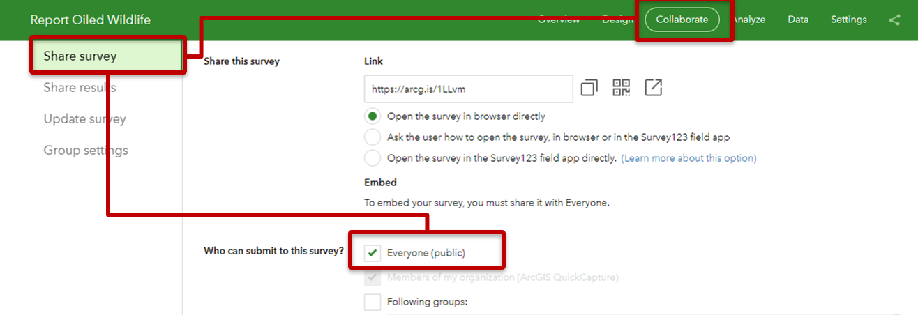

  • Click on Collaborate
The Collaborate tab is used to share your survey and survey results with other users. For now, we will not share the results with anyone; we will just share the survey. In other words, we will share the form so people can send data, but we will keep all the data private.
  • While the Collaborate tab is active, look for the section Who can submit to this survey? and check Everyone (public)
Share survey dialog shown
Is the Everyone (public) option disabled? Then your ArcGIS account does not have permissions to share surveys publicly. Contact the administrator of your ArcGIS organization.
  • Scroll down and click Save

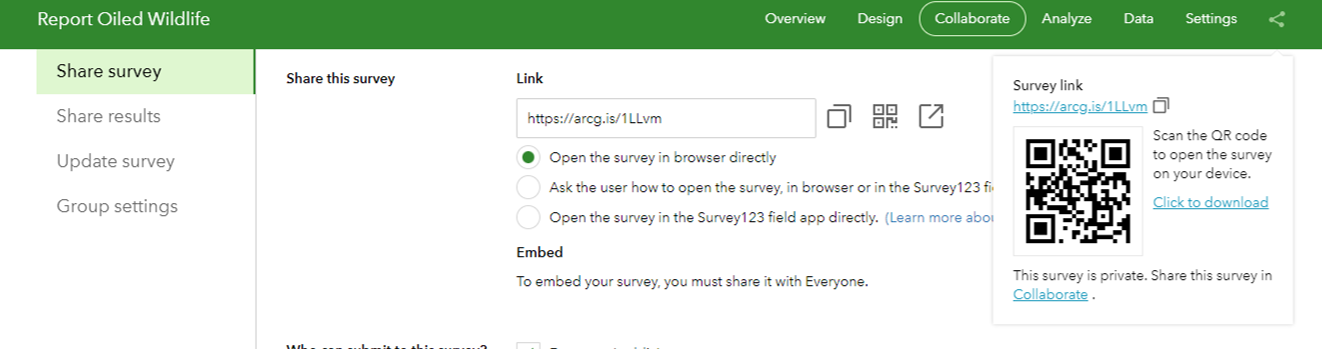

  • Next, use your survey link to open the survey in a browser
Share survey link dialog shown
Once a survey is shared publicly, anyone with the link can submit data to it. You can share the link via email and SMS or include it in a website. You can also print a pamphlet or poster with your survey’s QR code. That way, people can quickly scan it from a mobile phone and submit observations right away.

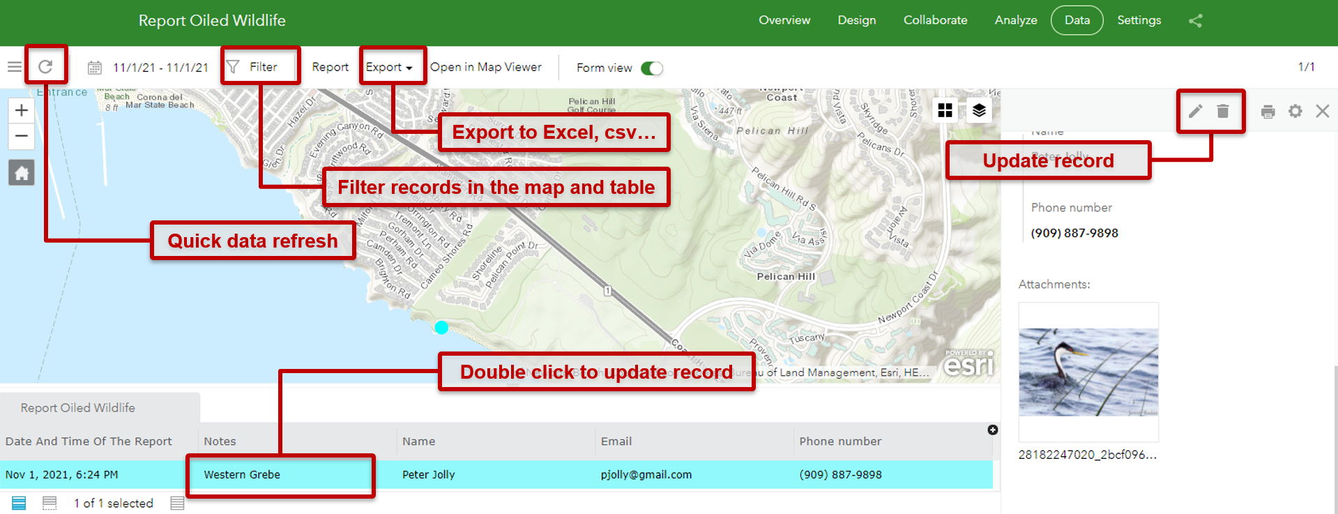

Viewing survey results
The Data and Analyze tabs in the Survey123 website help you view your survey results. Records will appear as soon as they are submitted.  The Data tab is designed to help you look at observations one by one. The Analyze tab will give you information about trends.
  • Click on the Data tab
Survey123 data tab shown
The Data tab presents survey results on a map and in a table. Select specific observations and explore their details.  In the screenshot above, an observation by Peter Jolly on November 1 is highlighted. The photo, its location and time are shown. His contact information is available.
