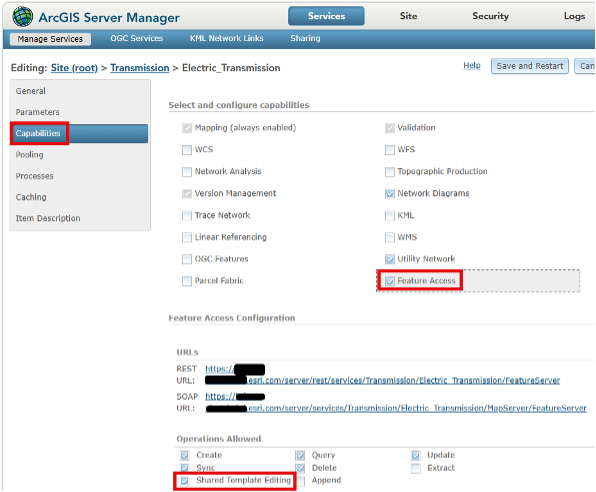

Our first step is to go into ArcGIS Server Manager and enable the “Shared Template Editing” capability on a Utility Network service. This capability will allow editing templates authored in ArcGIS Pro to be shared with other ArcGIS clients in the web and mobile environments. This setting only needs to be set once but does require stopping and restarting your utility network service. Make sure to do this when no users are active in the system.
- ArcGIS Server Manager
- Click on the utility network service
- Click on the Capabilities tab
- Click on the “Feature Access” capability
- Check “Shared Template Editing”
- Click the “Save and Restart” button

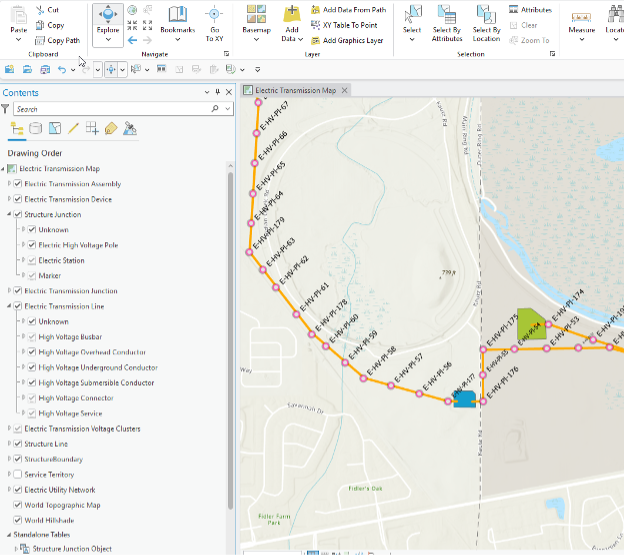

A web map from your ArcGIS Enterprise portal is necessary to use ArcGIS Web Editor. As opposed to creating a brand-new map from scratch, begin by making a copy of your editing map used in your ArcGIS Pro workflows. Let’s leverage the effort you’ve already put into defining your subtype group layers, symbology, pop-ups, labels, display filters and editing templates.
Note: ArcGIS Pro is currently the only authoring application where subtype group layers can be added to a map.

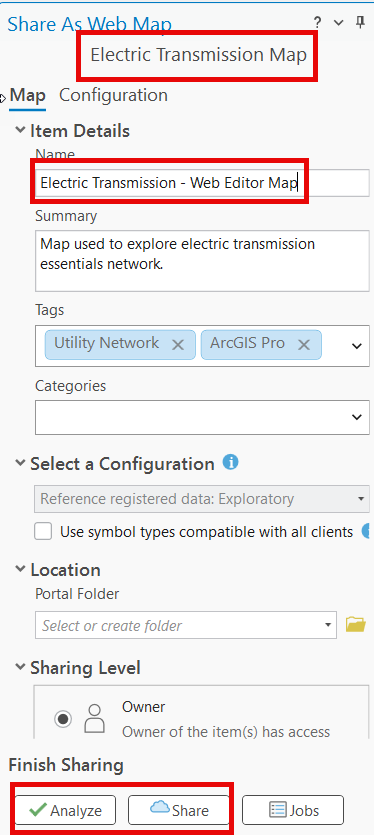

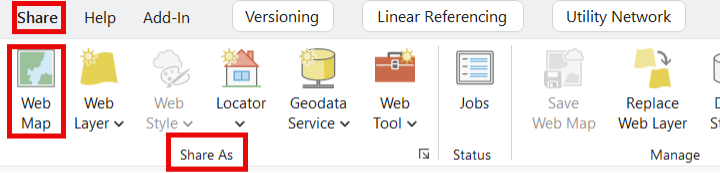

On the ribbon, click the Share tab. In the Share As group, click Web Map. The Share as Web Map pane will appear.
The item detail’s name will be set to the map name. I typically change the name by adding a prefix of “Web Editor Map” so that I know the purpose of this map in my portal.

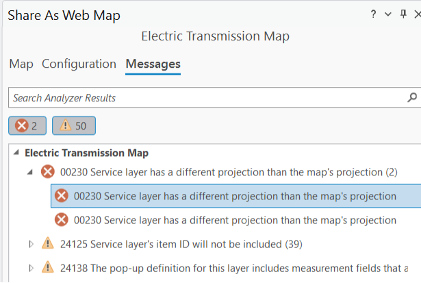

Click the Analyze button. If errors are detected, they must be fixed before the map can be shared to portal.
Warnings don’t have to be fixed but it’s recommended to review them and decide if action is needed.
A common error is 00230: Service layer has a different projection than the map’s projection.
The resolution is to either change the map’s coordinate system to Web Mercator or use a custom basemap with your coordinate system.

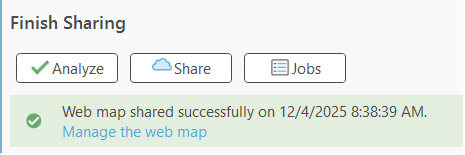

Once all errors are resolved, click the Share button and wait for the web map to be shared to portal.
Every time you run the Share as Web Map tool, a new web map with a unique ID is created in portal. This is great for the initial creation but to make changes to an existing web map, a different tool will be used. The Save Web Map tool will be discussed in the next section.

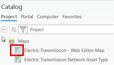

ArcGIS Pro can be used to edit an existing web map in portal. Examples for using ArcGIS Pro to edit a linked map include complex symbology changes or adding a new subtype to a subtype group layer.

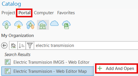

In the Catalog Pane, click the Portal tab, search for your web map and open it.
Notice the subtle icon difference with the linked web map.

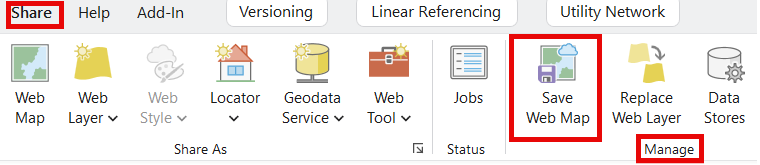

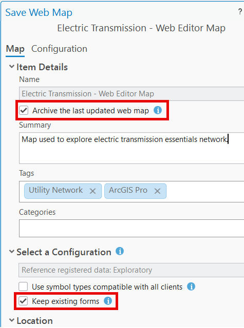

After making changes to the linked web map, you can save those changes back to portal and the Save Web Map tool will preserve the web map item ID.
On the ribbon, on the Share tab, in the Manage group, click Save Web Map.
- Note: The Save Web Map button is unavailable if the active map is not linked to a web map.
IMPORTANT: In the Save Web Map pane, make sure to check the “keep existing forms” option before clicking the save button. Otherwise, you will lose any form configurations that were previously authored in Map Viewer.

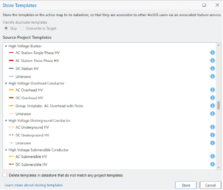

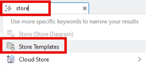

Click the Command Search box at the top of the application window and type Store Templates
The Store Templates dialog will appear showing all of the edit, group and preset templates in the active map.
Note: As you scroll through the list, you may see templates on layers that you will never use. Examples include feature templates for Dirty Areas and Subnetline features. Use the Manage Templates tool to delete them.
Click the Store button to save the editing templates to a system table in the enterprise geodatabase. This will make them available via the feature service capability described earlier in this blog.

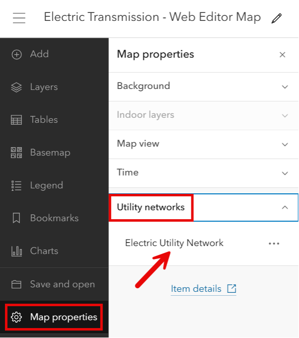

Upon reviewing the layers in the Map Viewer, you’ll notice that the utility network layer isn’t in the table of contents. To confirm that the web map is utility network aware, click on the Map Properties Tab and tip open the Utility network section. The name of the utility network should be displayed. The utility network being recognized in the web map will unlock capabilities within Web Editor.

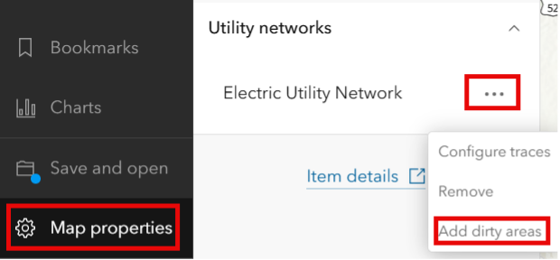

To add the Dirty Areas layer, click on the ellipse button next to the utility network name and then click Add dirty areas
- Note: The Dirty Areas layer is added at the top of the Table of Contents. You’ll want to move it to the bottom so that network assets are rendered above it.

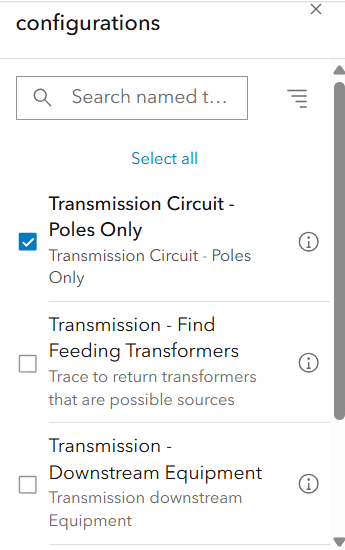

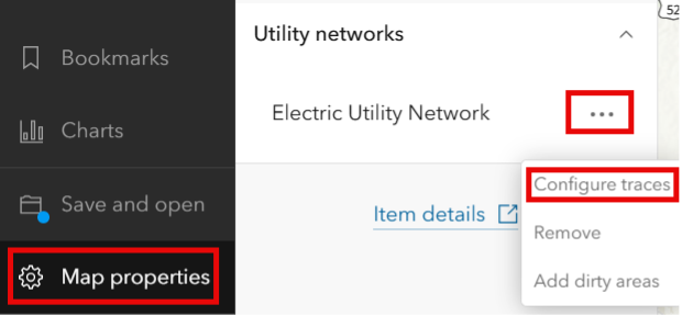

To assign named trace configurations, click the ellipse button next to the utility network name and then click Configure traces
Note: Trace Configurations need to be created within ArcGIS Pro for them to use in this step
The list shows all named trace configurations available in this utility network. Checking the configurations you want assigned to this web map will make them available in Web Editor’s trace widget.

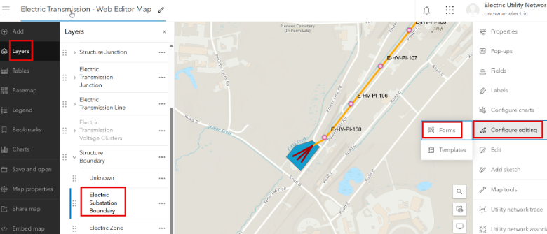

To configure a form, click on the Layers tab, select a specific layer, click Configure Editing tab, and click Forms

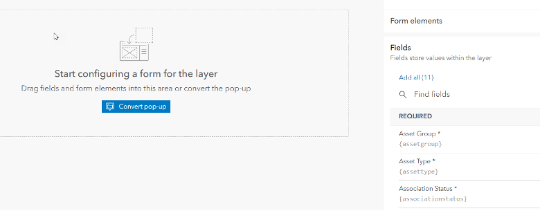

The Configure form window appears and you now can build out your form by adding elements to the form. Form elements are field groupings and the input fields that appear on the form. Field elements are based on existing fields in the feature layer.

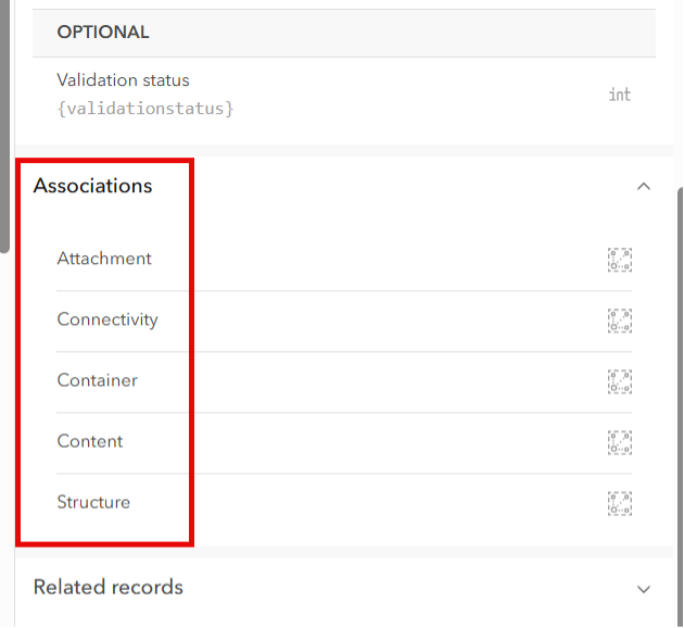

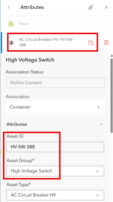

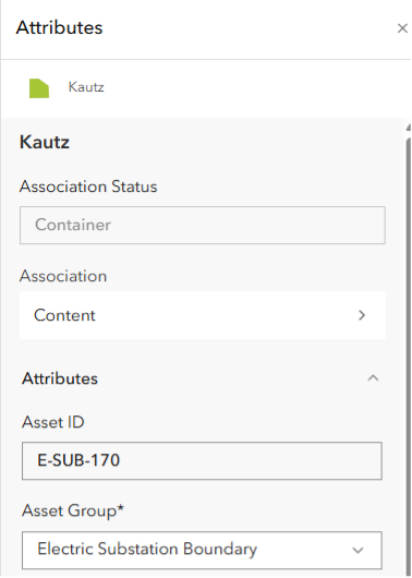

A utility network specific element that can be added to the form is Associations. This allows viewing and editing of nonspatial objects and associated features. It also lets you access the features that participate in the association.
Here’s an example of a configured form containing an Association element.

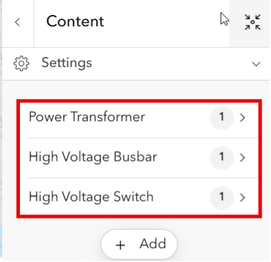

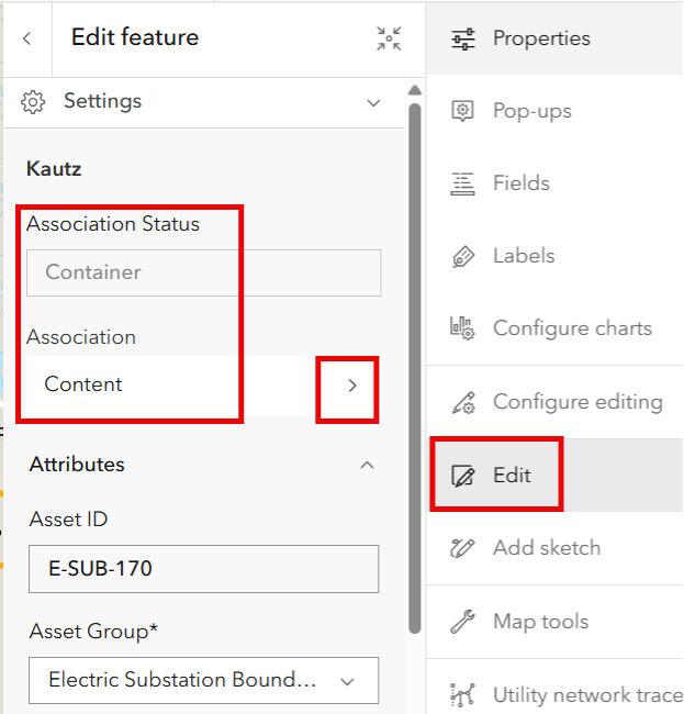

A substation feature has been selected for editing. To see the features contained within the Substation, we can access them through the Association element.
Click on the Content arrow to see the features contained within the substation. Click on the arrow to drill into the individual features.
Continue to drill in until you reach the individual feature. If necessary, make attribute changes for the associated feature.

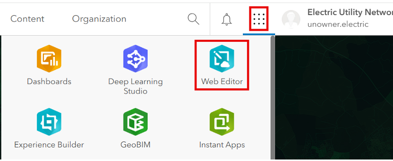

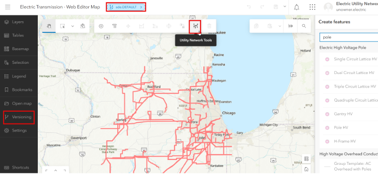

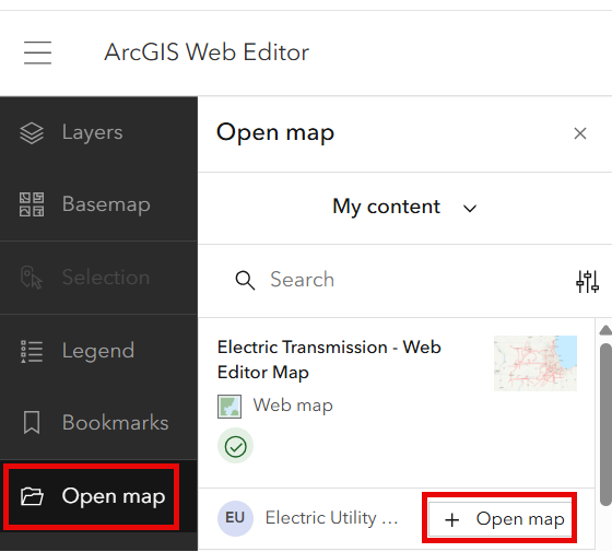

From your portal’s app launcher, click on Web Editor icon
Click Open Map and navigate to your map and click + Open Map
You’ll see the Versioning tab, the named version pointing to sde.DEFAULT, the Utility Network Tools icon
You are now ready to begin testing your editing workflows!
