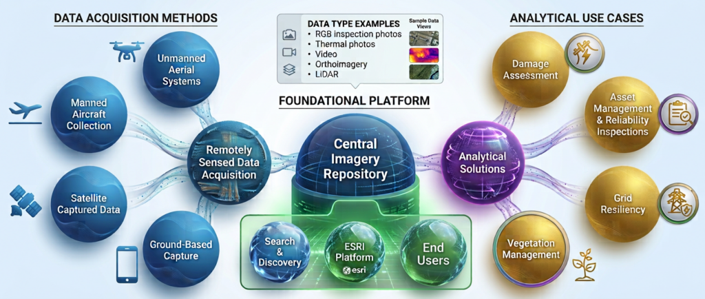

Dominion Energy engaged PwC to build the iMAP business case, shape the platform approach, and support the regulatory filing under Virginia’s Grid Transformation (GT) Plan. Rather than justify a single technology, the program treated remotely sensed imagery as shared infrastructure, collect once, use many times, and built everything else around that premise.

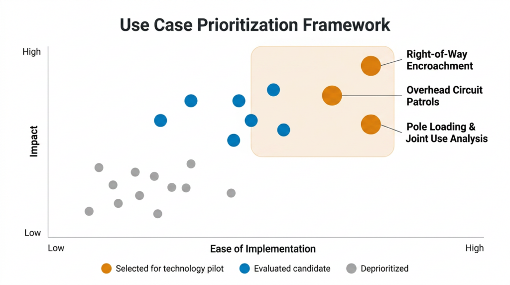

Prioritize use cases through a scoring framework.
Inventoried candidate use cases through workshops across functional groups, then scored each against impact and implementation effort. Three were selected for pilots, right-of-way encroachment, pole loading and joint use, and overhead circuit patrols, chosen because they span multiple business units, share the same LiDAR and imagery collections, and leave a pipeline for later waves.

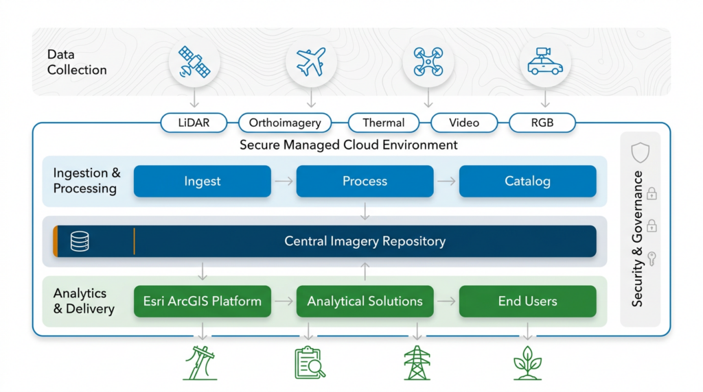

Developed the architecture as a production environment within a Dominion-managed AWS Virtual Private Cloud, governed by four principles: harmonization, Esri integration, security, and scalability. ArcGIS acts as the hub, mapping imagery to structures, giving Electric Distribution a geospatial view of asset condition, and hosting the deep learning models applied to that imagery, all inside Dominion’s environment as required for CEII-classified data.

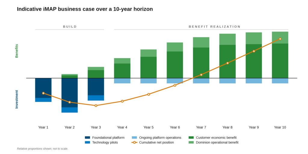

Quantified benefits in two categories, customer economic benefit from avoided outage minutes, and Dominion operational benefits spanning vendor spend, workflow productivity, asset life, and GIS capability, and built costs bottom-up across labor, licensing, hosting, managed services, and data acquisition. Valuing three use cases rather than one made iMAP defensible as an enterprise capability.
Structure the regulatory ask in two parts.
Structured the filing as two components, the foundational platform, and three technology pilots, submitted under Phase IIIB of the GT Plan in March 2025. Virginia’s regulator holds utilities to a prudency standard: spending must be reasonable and benefits real rather than assumed. Splitting the ask met that test, building the platform once and proving value on a defined footprint before seeking approval to scale the program systemwide.

The Virginia State Corporation Commission approved both components in full under Phase IIIB of the GT Plan (Case No. PUR-2025-00051), authorizing approximately $28 million to build the foundational platform and execute the three technology pilots across 2024 through 2026. In doing so, the Commission recognized the value of a central repository for imagery of Dominion’s distribution assets and of applying advanced remote sensing to drive customer and operational benefits.
The platform then moved from design into build, with PwC supporting implementation. It is being delivered as a governed, cloud-native environment within Dominion’s AWS Virtual Private Cloud with ArcGIS at the center, and is scheduled for production release in Q4 2026.
